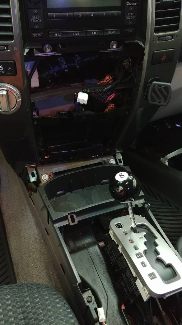

Got my stereo installed and my wiring finished up for anytime backup cam! Did this on my 3rd Gen, and won't go back to another vehic without Android Auto and eyes on the back of the rig...

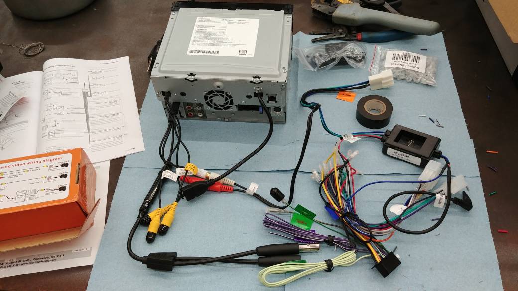

Parts list:
Kenwood DDX6705S Stereo
Crux SWRTY-61S SWC Harness
CCD Backup Cam - link here
3ft RCA Male-Female RCA extension
Metra 95-8202 Dash Kit
Scoche MDAB Micro antenna adapter
Metra UV43 Antenna Y- splitter
Female RCA to Aux 3.5mm Y adapter
Optional:
Scoche MAGDMB magnet phone mount

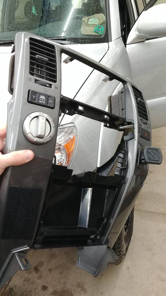

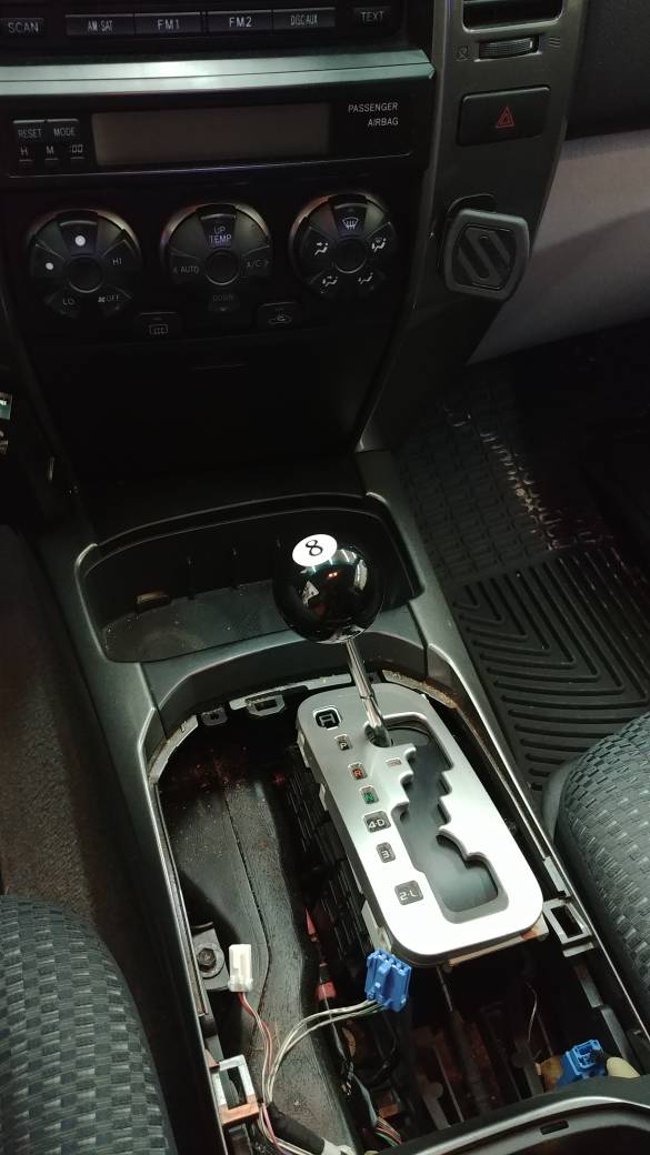

Step 1. Start removing trim on the console area
2. Move up to the dash, a few 10mm bolts and a bunch of clips, boom.

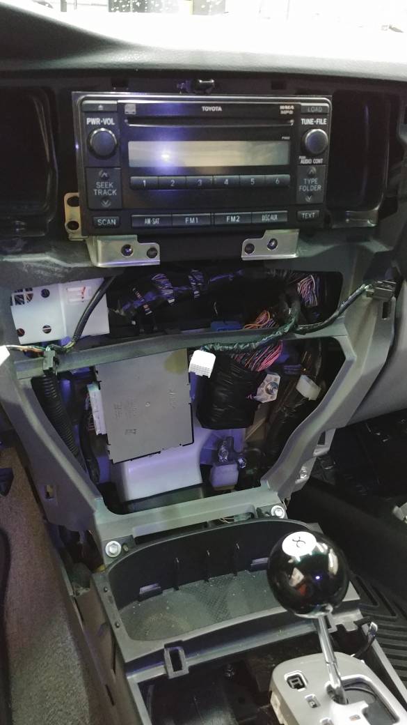

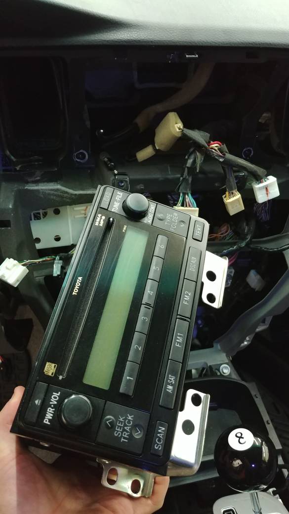

3. Head unit, see ya!
Sent from my VS988 using Tapatalk
Steps 4-9. (the longest part)

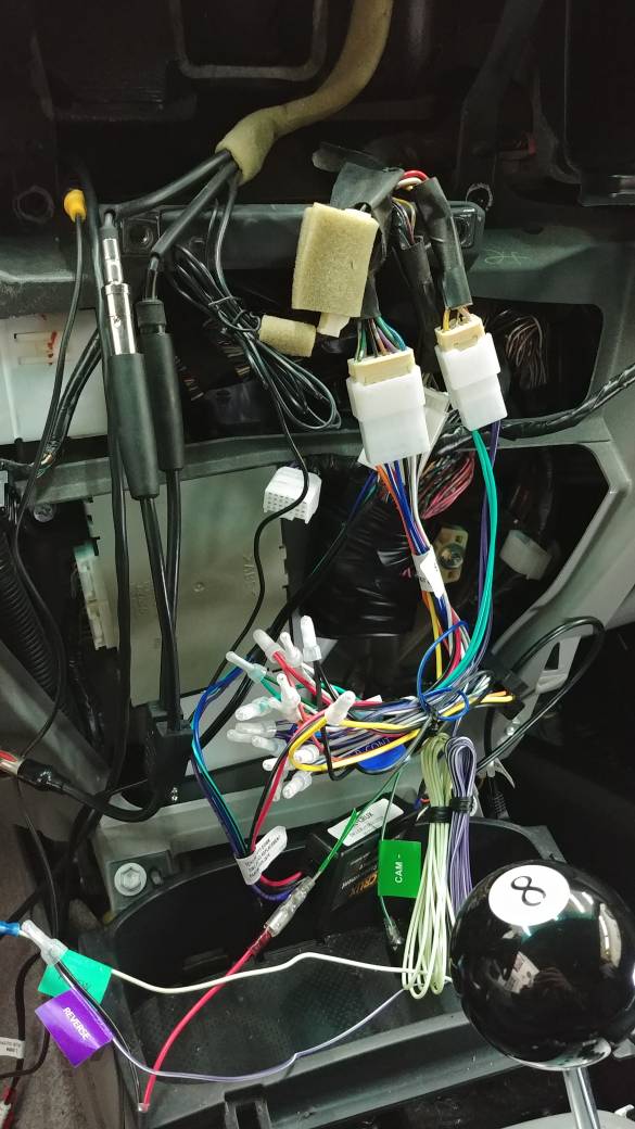

Connect and verify all of the wiring connections between the Crux harness, stereo, backup cam, and mic. I use closed end crimp terminals after twisting the wires together.

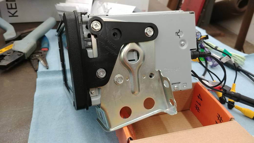

10. Transfer the brackets and the plastic side plates from the Metra kit to the new stereo
11. (not pictured, did this previously) run the backup camera wiring along the driver side floorboard wire channel, three wires - RCA for video, ACC power so the camera is always on, and reverse signal to the yellow/red wire for automatic switching in R.
12. Connect and verify before making this tidy
13. Tidy up with tape so it isn't so messy behind the dash, then carefully push it into place!

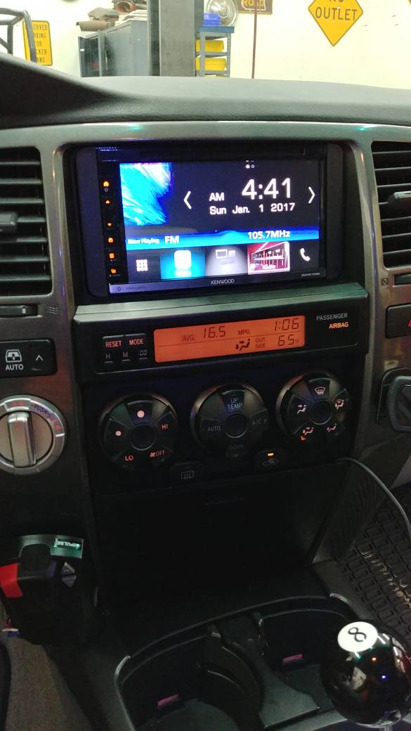

14. Voila. Test for functionality, check all speakers, mic, USB, SWC, and aux functionality before buttoning all the trim up in reverse order!
15. Lastly, measure out the reverse cam distances for referencing. For me, the bottom of the screen was 2ft from the hitch and the middle yellow line across the screen was 4ft. Schweet.

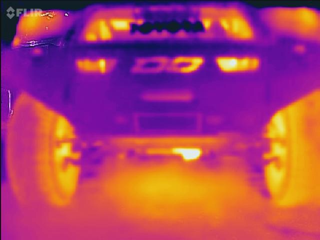

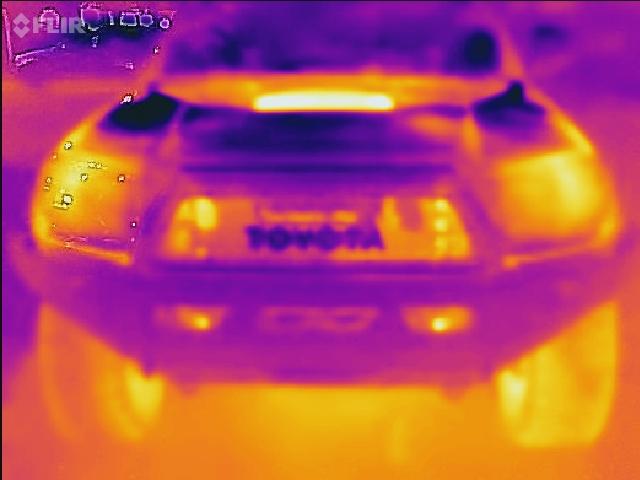

Took a couple pics with the ol' FLIR attachment after a 3 hour highway drive. 40 degrees out, and max temps were in the 110-120s on the tailpipe. I mainly did this to check my CV joints, as I still have a bit of noise from the front passenger side and I'm skeptical of the non-OEM CV that was installed by the PO a year or so ago. It was reading about 30 degrees higher than the OEM, so it might be at least due for a regreasing or something... Or I just swap in a rebuilt OEM... :whistle:

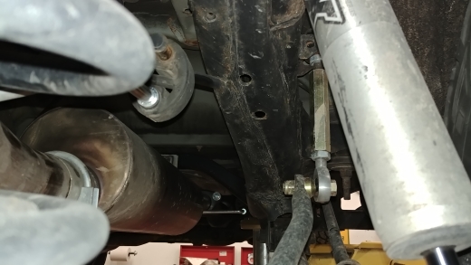

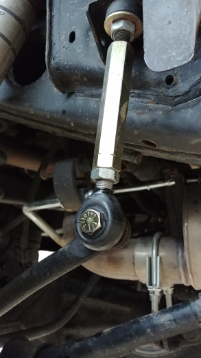

Found out my passenger side ITRE has noticeable play. Maybe that's what's causing my vibrations at 40-50mph! Also found my sway bar end links are pretty toast, and might as well do the OTRE's as well. Proforged, here I come...
For those who don't know, I was very impressed with their links & joints on their 3rd gen components at a fraction of the cost of OEM, and I can only assume their 4th gen stuff is on par as well. Looks like another weekend project in the works!
I did the proforged 3rd Gen Rear End Links on my 4th Gen. They're longer so they run like "extended" length ones for way cheaper. I actually received nuts that were not the proper size for the bolts in my box, but I had some that fit... Unfortunately my nut came loose without me noticing, and in the time it took to notice, the vibration/friction had flattened the threads to where it couldn't be tightened anymore. The links are so cheap that it's hard to decide if I want to get a tap and die for that size bolt, or if I just need to buy another set of links.
