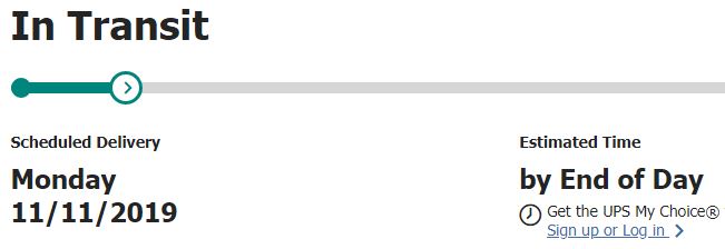

Always a good sight to wake up to...
Hint, it's a slab of steel :thumb:
