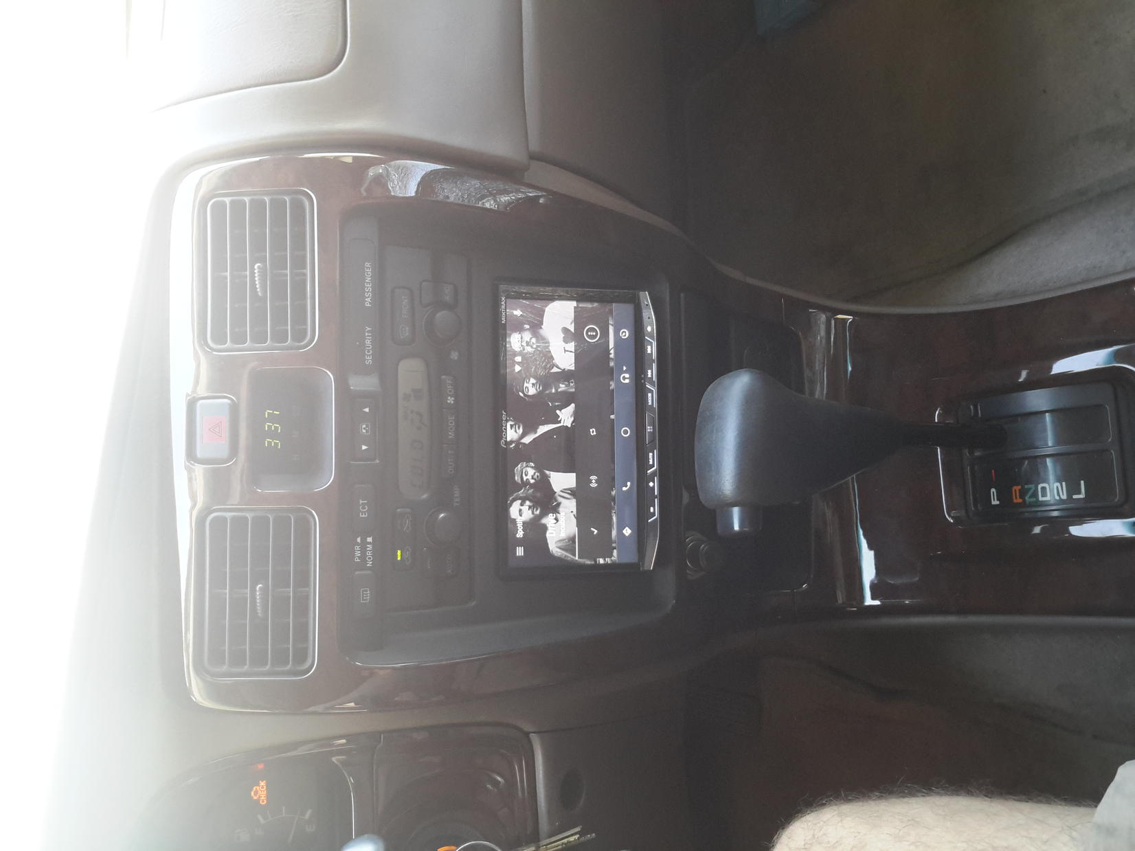

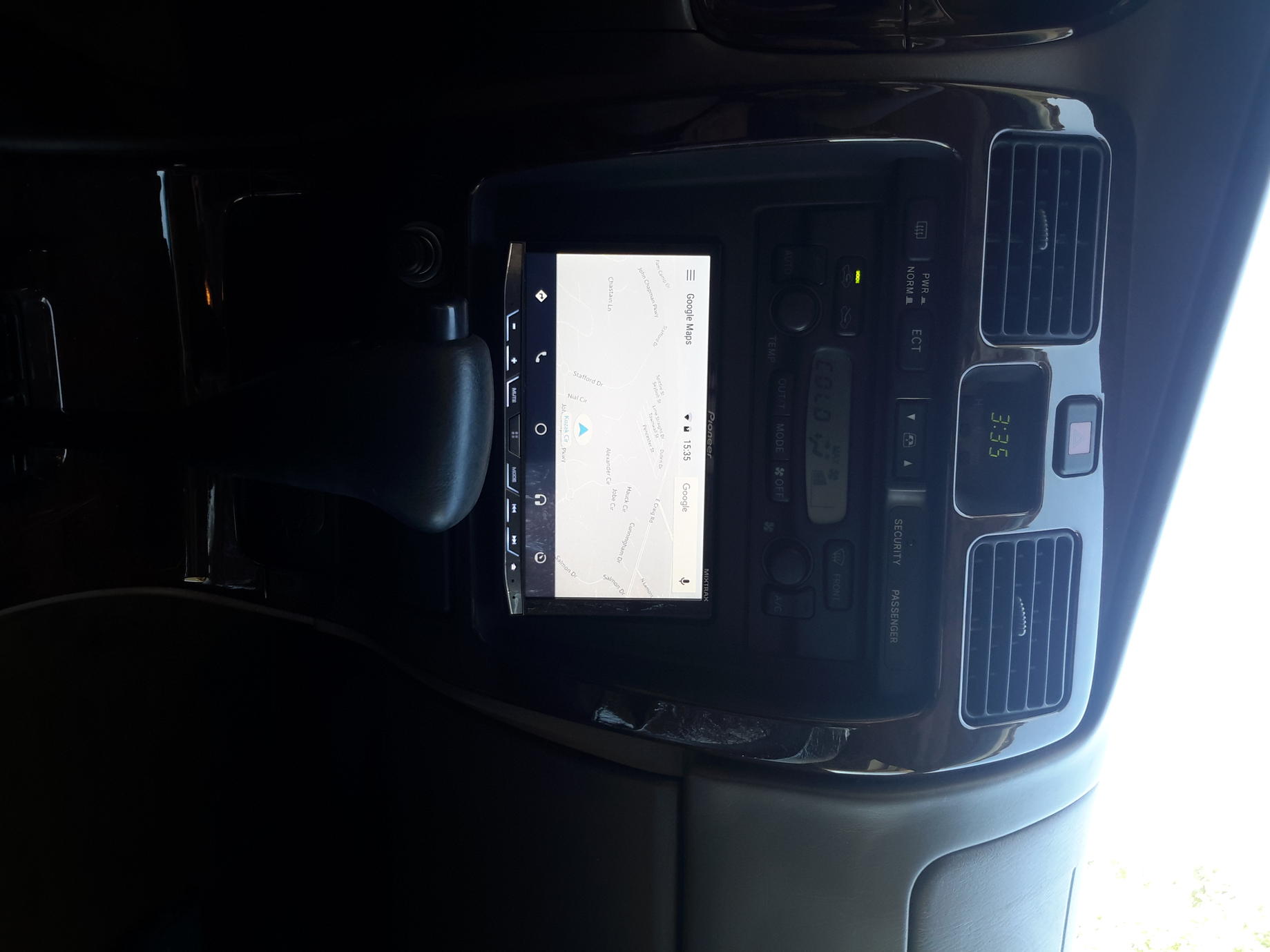

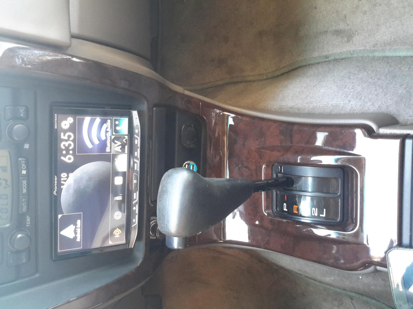

Here's mine... Bought the Toyota harness w/o amp (I removed it) and it was pretty much plug n play. Running all the different wire (mic, gps, etc.) took the longest. Just grounded the green wire (e-brake bypass)

:wow2: That looks so clean... Another thing I didn't know I wanted....
Do you have a how to or a walkthough posted anywhere? I suck at electronics but would love to tackle this job for how clean it looks.

It couldn't be easier if you get the harness. Match the colors together solder or crimp.

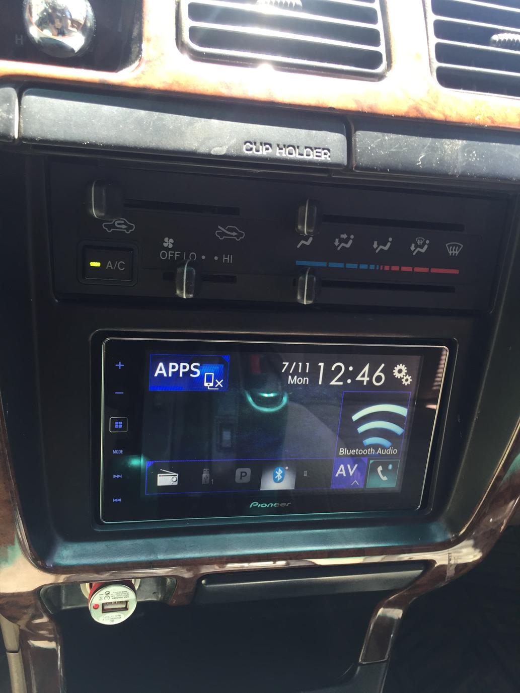

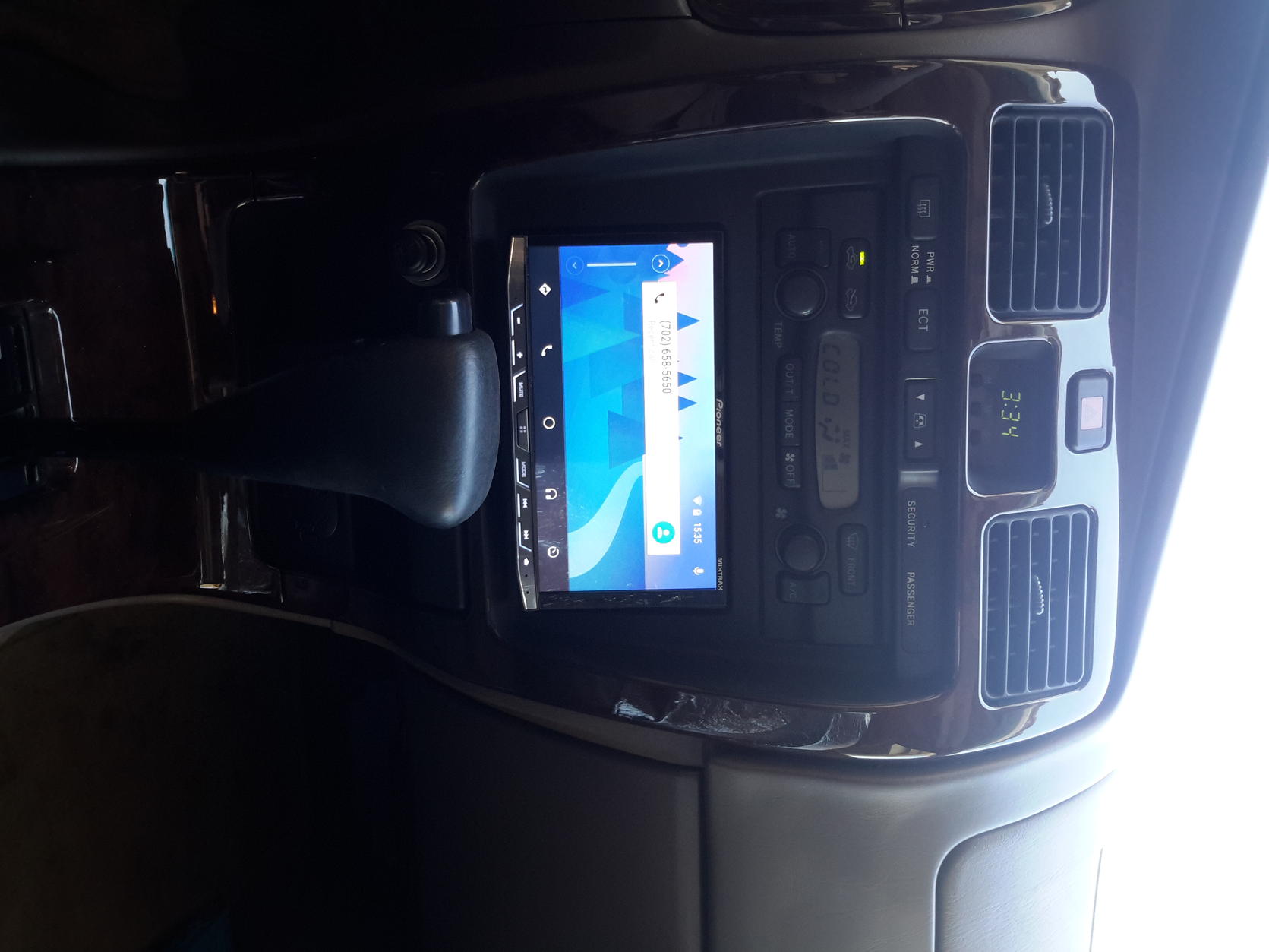

Just did my install. Found a great deal on Jet.com for the Pioneer SPH - DA120. They're offering 30$ off and no tax if you create an account. So I got mine for 384$ out the door and it was delivered in 3 days.
Install was very simple and seems to have pretty good functionality so far.

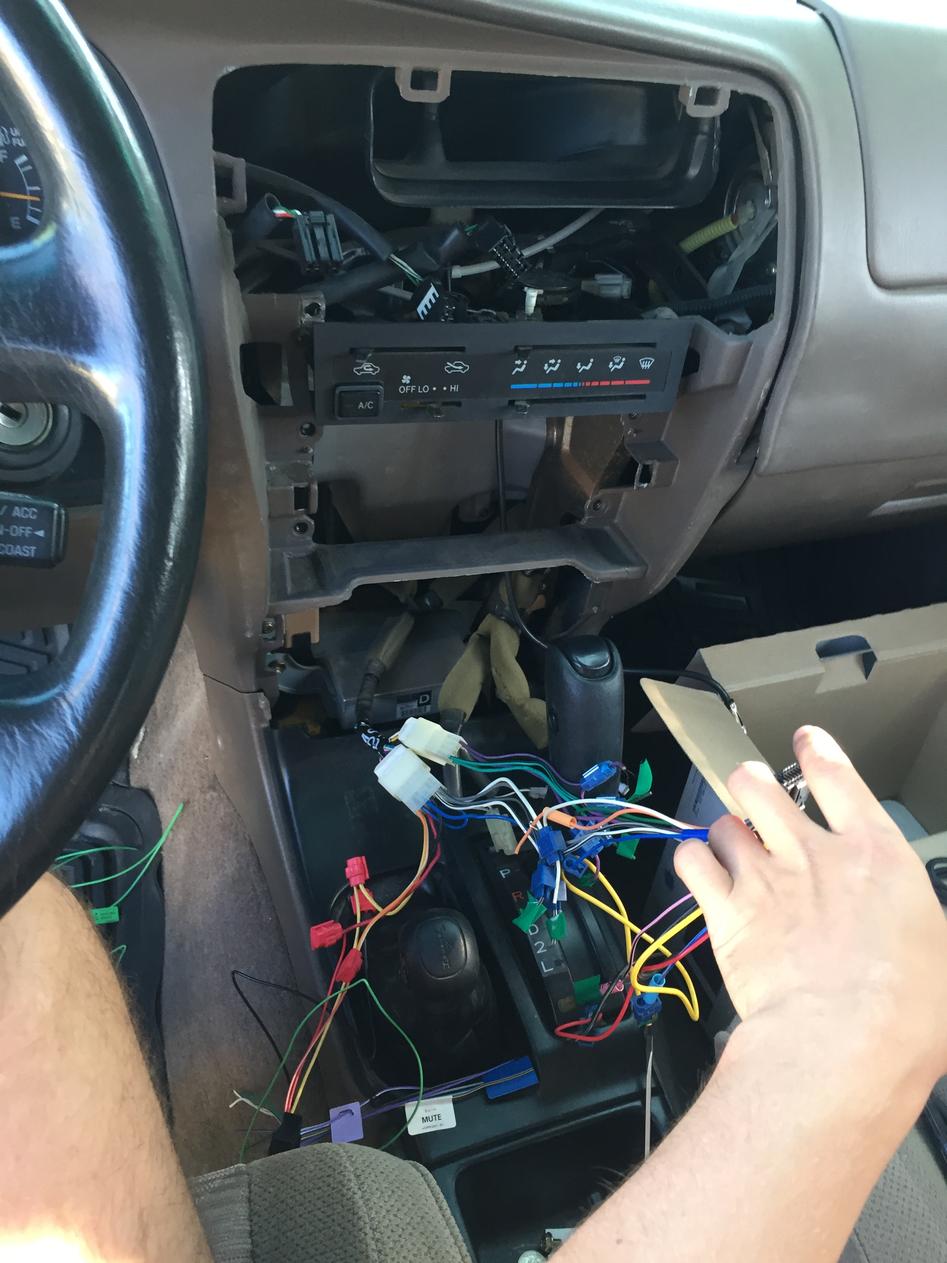

I used to have an appradio until I ditchted crApple, so I needed a new HU. I went with the 4200NEX which has carplay and apple's version of car play. I love it. It doesn't have built in nav, which I found unecessary seeing as it has carplay, but it can be added. I like having the lip to rest my hand on for stability when using the touch screen or buttons. I initially got the wrong harness for toyotas without and amp so i had to get another one, but it was no big deal.

Where did you run the usb port for the carplay?
