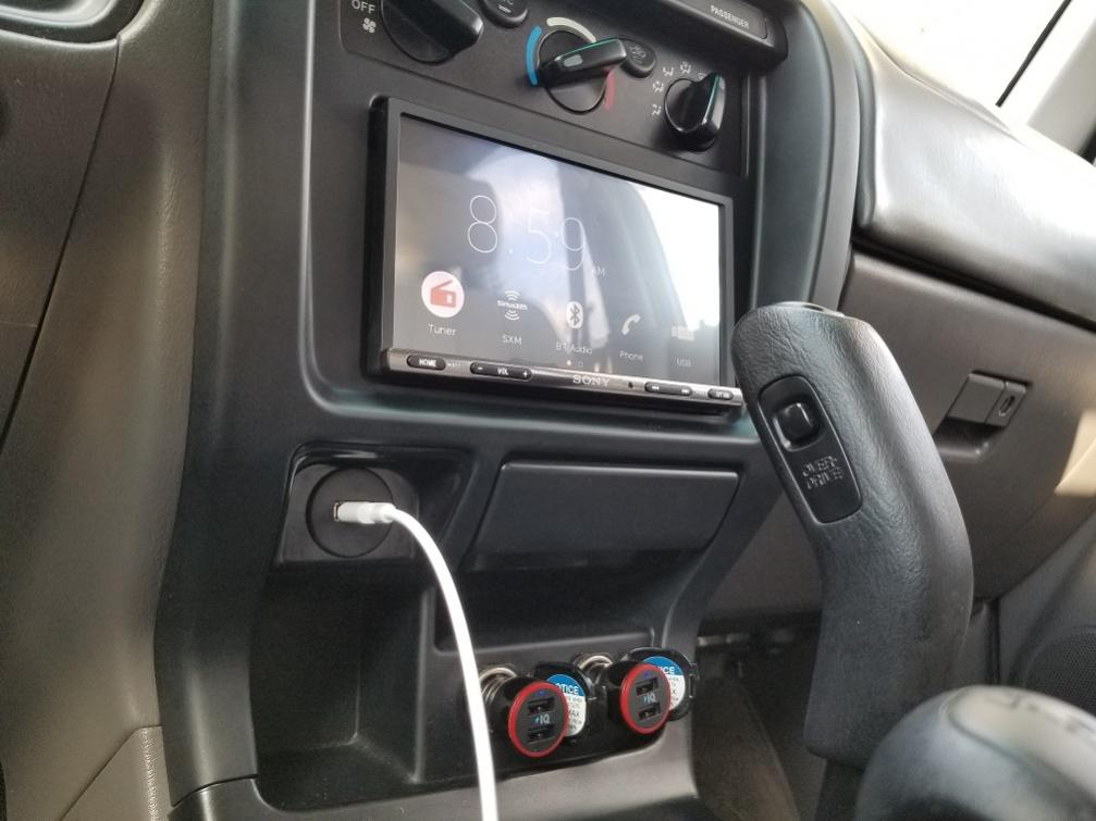

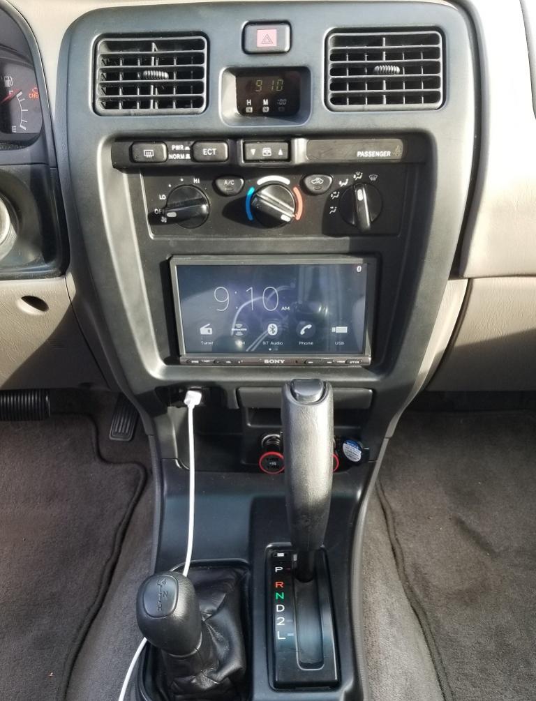

My son and I just finished a head unit upgrade in his 2001 SR5. Santa delivered a Sony XAV-AX3000 with Apple CarPlay and Android Auto. So far, we’re really impressed. This was a very exciting upgrade for a high school student who doesn’t own any CDs, and wouldn’t know what to do if you handed him a cassette tape.

Installation was fairly straightforward, but it had a few challenges:
  • Wire harness prep… We soldered and shrink-wrapped all the wires in the harness – no crimp connectors. This took a while, but it resulted in a very solid and tidy bundle of wires. We chose to connect the parking brake wire to ground instead of wiring it to the actual E-brake handle. Normally this “feature” would prevent you from viewing pictures or videos from a USB stick unless you had the parking brake on. Grounding the wire as we did defeated this protection. It was just easier, and we didn’t think watching USB movies is something we really needed anyway.
  • USB extension… The Sony manual warns against extending the USB port, but we extended it by 3 ft anyway. We wanted a clean look, so we chose to replace the cigarette lighter and keep the two lower sockets for other accessories. There were two challenges: We had difficulty getting the original cigarette socket and bulb out of the dash bezel. It just wasn’t clear how to get that thing out without completely destroying it. Eventually we got it. Second, the USB mount from Amazon was a slightly bigger than the hole through the bezel, so I had to grind down the inner circular edge with a belt sander. This was tricky, but we managed to get it to drop into the hole and mount flush against the metal bezel. We also painted the metal bezel before installing the locking nut behind it. In the end I wish we had found a USB panel mount what was small enough to fit inside the white plastic ring of the original cigarette lighter. It looks clean the way it is, but the USB port is difficult to see at night. It would have been really cool to have a lighted ring around the USB port.

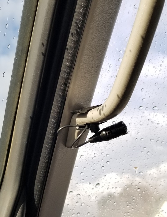

  • Microphone… It was difficult to decide where to put the included microphone. The microphone comes with a clip intended for a visor, or something else. We opted to clip it to the handle on the A-pillar. The mic is very sensitive. You could probably mount it *behind* the dash and it would still work. We could have tucked it away somewhere less conspicuous, but we left it on the handle for now. From the head unit the wire runs underneath the carpet behind the pedals and up to the handle.

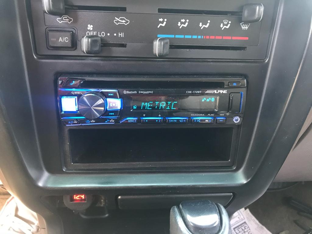

I got the Alpine 172BT a little over a year ago for $120 from Crutchfield because of my CD collection and I love it. Added an antenna switch after the car wash had its way with my antenna. Been washing by hand since then. Glad I bought it when I did!

The blue wire on my Alpine BTE 172BT powered the antenna regardless of the input so I had to add a switch. The guy at Crutchfield had me wire the blue striped wire to the amp which still gets power no matter the source so I don't think that would have made a difference.

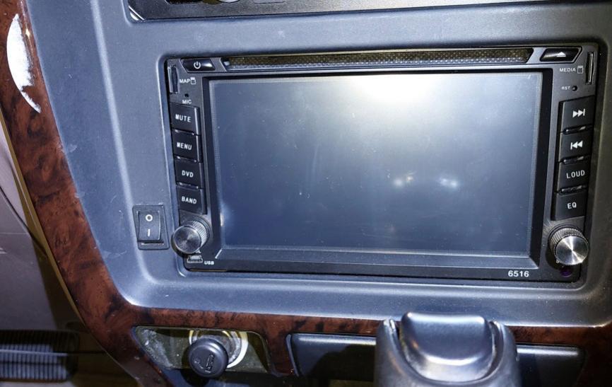

Curious where you all have mounted your kill switches?
Any recommendations for what switch to buy?
I bought the switch here based on a forum post and mounted to left of my steering wheel.
