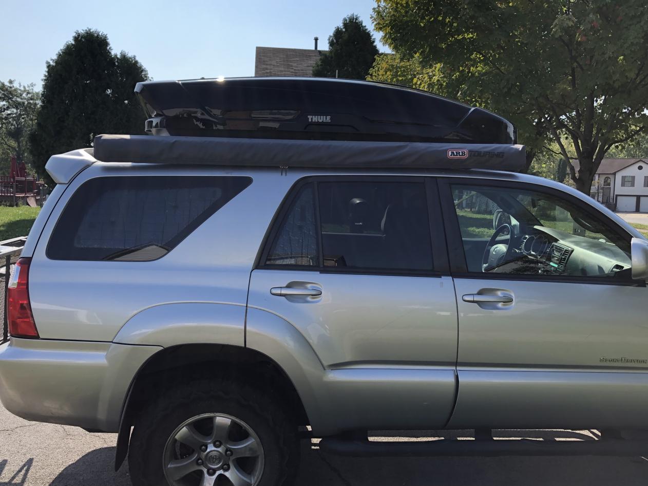

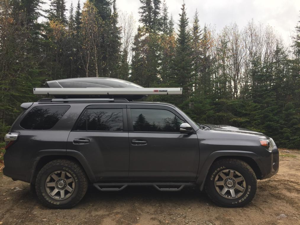

I put a 2500 ARB aluminum awning on stock rails with LFD cross bars. Then went on a 5000 mile road trip through Northern Quebec, Labrador and Newfoundland, including 1000 miles of gravel and dirt roads. No issues and no flex thus far (knock on wood).
All things being equal, I would have put another cross bar on but I was running a Thule box up top so had to stick with two bars. Spoke with ARB rep and he said although they recommend the second mounting position be no further away than 1/3 from the end, it’s mostly for cross-wind/turbulence when driving. Not as much of an issue for the aluminum casing and he gave his blessing to go forth.

Good to hear. Do you have any pics?
Thanks. Does the overhang bother you at all? Can you see it through the windshield when you're driving?
Doesn’t bother me at all. I keep it on all the time and I can only see it through the sunroof when it’s open.

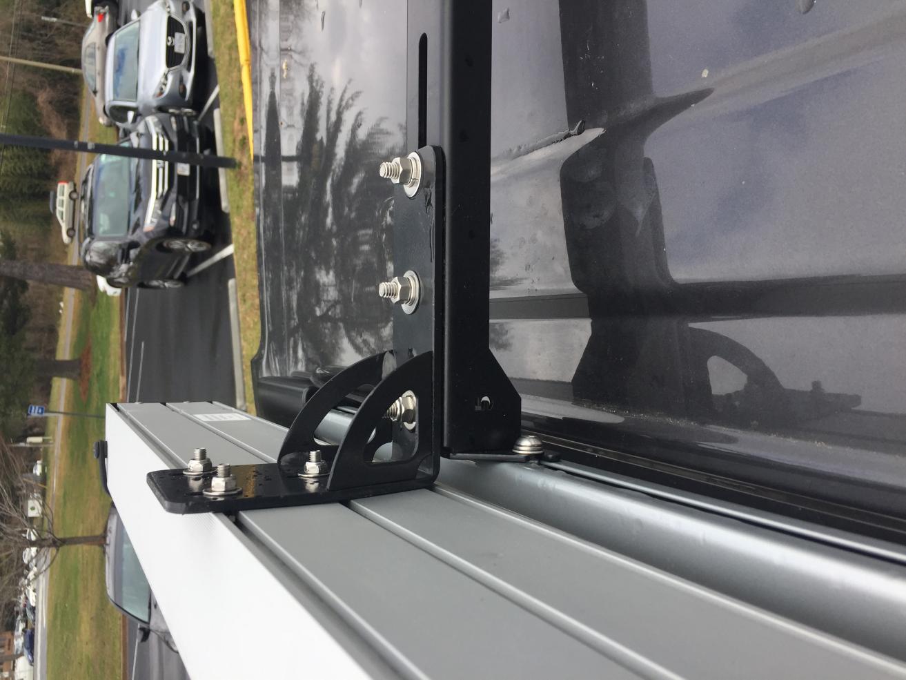

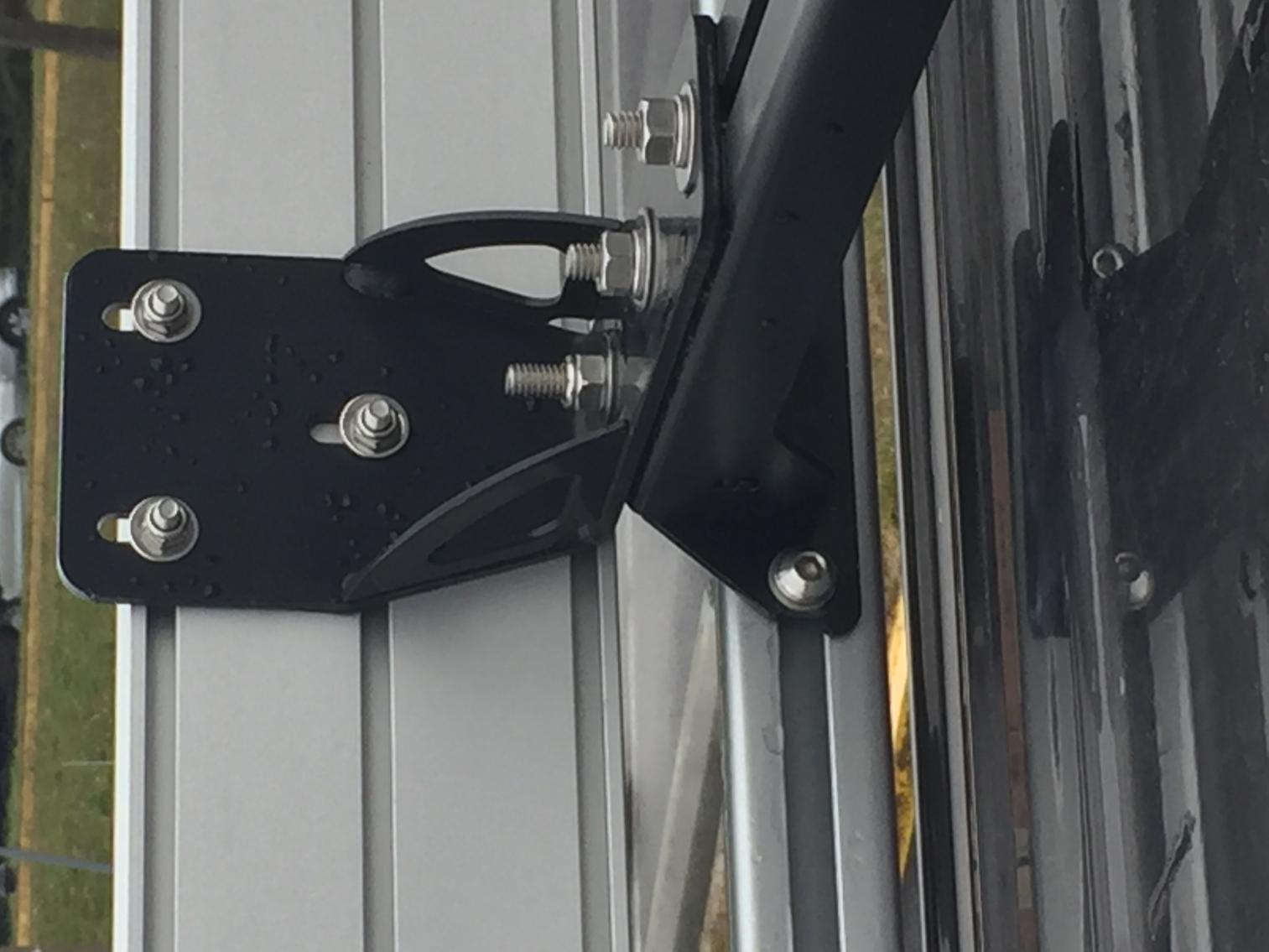

What mounting brackets did you use?
ARB L brackets. They worked well on top two slots but I ended up lowering them to fit the awning room better.
