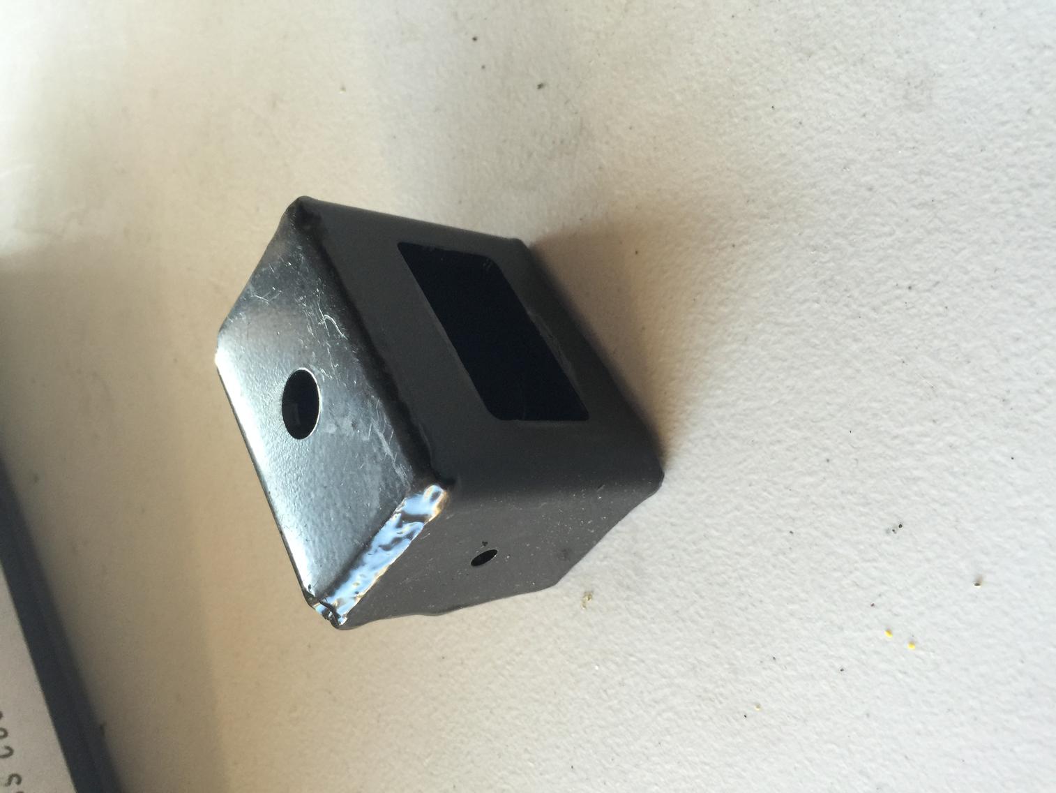

Koko4 is right....once you cut the OE frame end-mounts on the T4R, you can just slide back the ARB provided mounting brackets and they line up with the two large bolt tow hook holes.
I boxed my frame ends for more support and drilled and added an extra long bolt provided by ARB:
