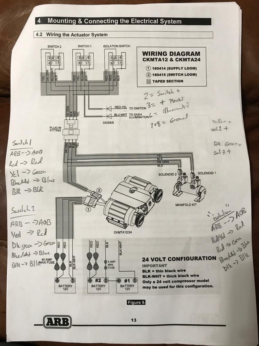

For those of you that are having questions on what goes where... be sure to read the two pages that -follow- that wiring diagram posted above. It explains the complete ordeal and has a couple of warnings you must heed.
1. Don't cut the diodes out of the wire if you shorten it.
2. Switch 1 MUST be the REAR LOCKER
3. +12 needs at least an 8 amp fuse in the circuit.

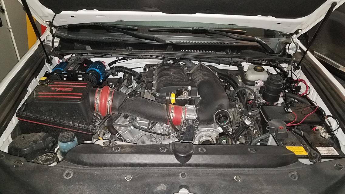

Here's some photos of the Bandi mount. I picked this one last week. Solid mounting solution for the ARB compressor. He has a few different options as well.
Sent from my SAMSUNG-SM-G935A using Tapatalk
Hi,
Is that mounted on top of the relocation kit when the second battery is fitted to the front passenger side?

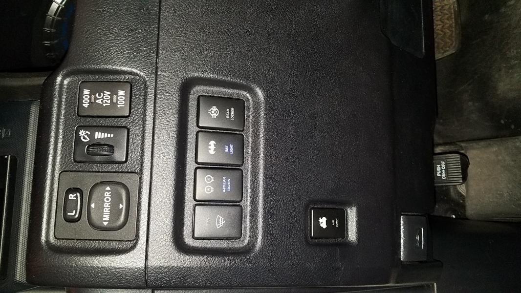

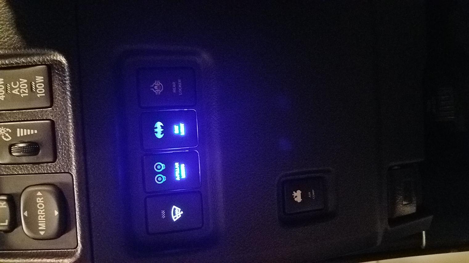

Folks...finished my wiring for my ARB twin compressor. I connected my blue and red/yellow wires to the add a tap for my other switches. The AOB compressor button doesn't light up with the other buttons when I have my lights on. I think I have to move the red/yellow wire to my ignition fuse with an add a tap to separate the two wires. The compressor works when I hit the button so everything is in working order. Any advice?

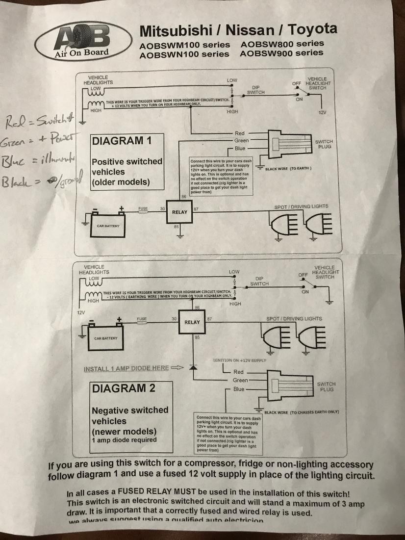

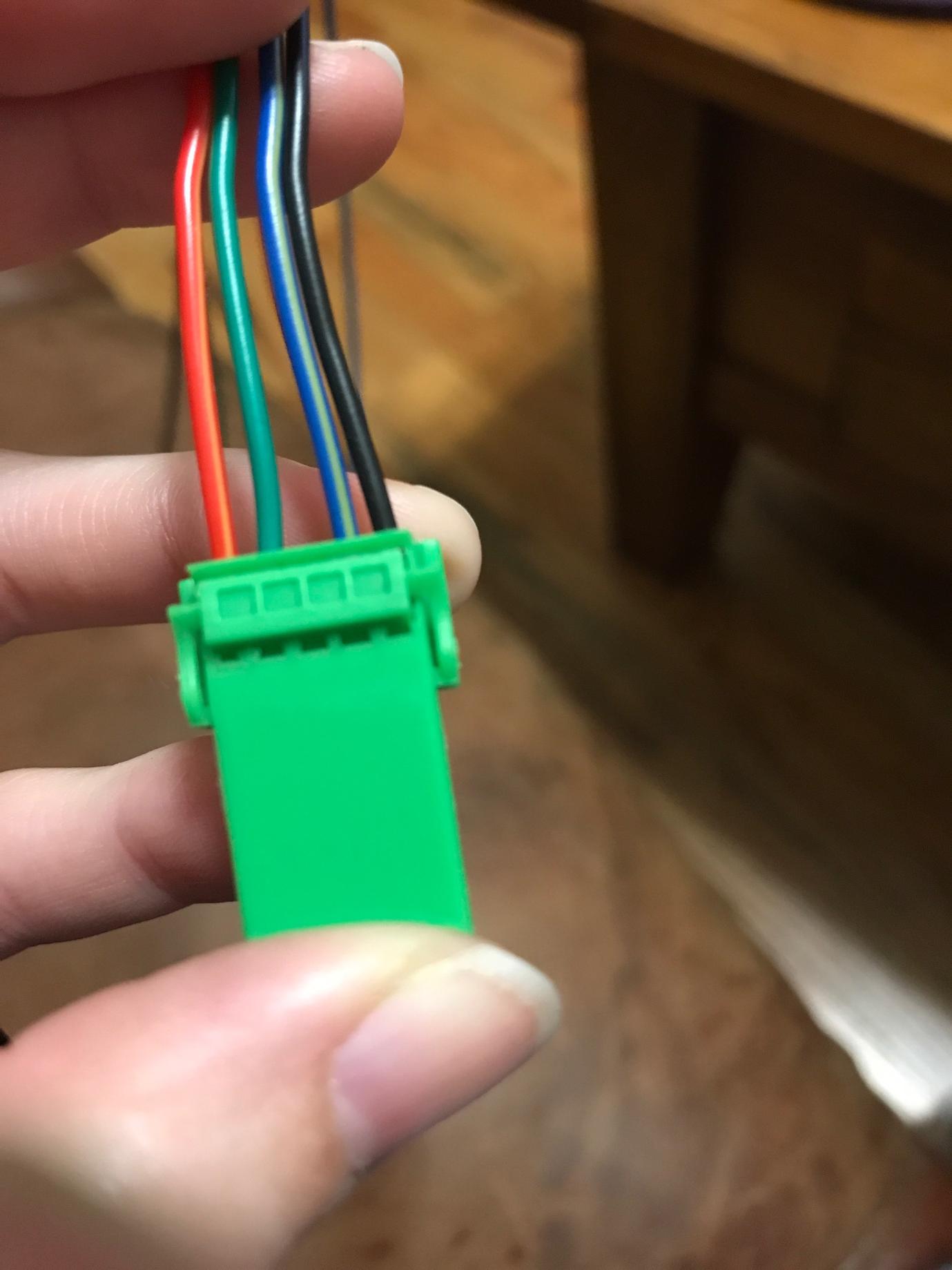

We're working on a similar install this week as well. We're hoping you guys could take a look at how we believe we're supposed to make the connections and let us know if we've got it right or not??? The instructions and wire colors seemed to have changed some from previous threads we've checked out.
AOB instructions
These are the plugs we got with the switches.
ARB instructions
So just in case the hand-writing isn't showing up well enough I've typed it out here:
Isolation Switch:
ARB ---> AOB
Red/Yel -- > Red
Red ---> Green
Blu/wht --> Blue
Black ---> Black
Switch 1 (R):
ARB ---> AOB
Red ----> Red
Yel -----> Grn
Blu/wht ---> Blue
Black ----> Black
Switch 2 (F):
ARB ---> AOB
Yel ---> Red
Dk Grn ---> Green
Blu/Wht ---> Blue
Black ---> Black
Does this make sense/look right????
Thanks!!!
Can confirm this wiring diagram does work for Compressor and Rear Locker on Switch 1.
