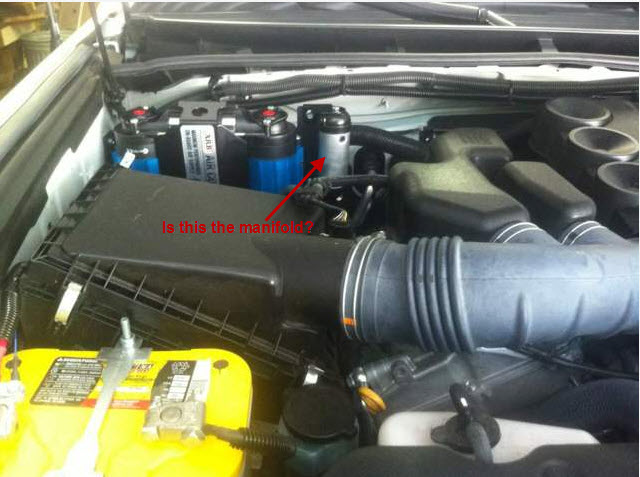

Just had mine mounted last week. The shop made a great bolt on bracket that looks really professional. He said he would be willing to make more for some people using mine as a reference.
Here's just a shot from my phone.
Anyone interested PM me. I'll also probably start a new thread in a few days about this.
I'm not making anything off this, just trying to support a local fabricator. Can't give any info on cost, it did cost me a pretty penny, but I'm sure it will be cheaper for anyone else as they already have the design work out of the way.
That's looking nice Jangoforhire! Did they have to reroute any of the hoses? Looking forward to seeing more detail pics.

Oh, is that the manifold also mounted back there to the right?!
yes that's the manifold.... also. for those buying a compressor, also buy a good deflator. I really wished I had one of those at the summit.. so much faster and easy to go DOWN to the right tire pressure.
