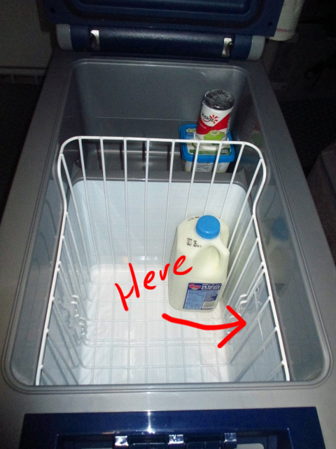

Hey Dave, (or anyone else :) ) while you have yours out, would you mind taking a picture of the inside right hand side of the cooling coil without the basket? Mine has this weird pattern where the cooling channels are, I think its where it comes from the compressor, it gets super cold in that one spot and I am wondering if it is normal. Would greatly appreciate :thumb:

lol no it only gets cold in one spot. So not sure which is worse one frozen beer in the middle of twenty three warm beers or...

By the way jerk, PM me your email address and I'll send over a picture.

Got them, thanks! yep it looks the same. where that "pinch" is gets ultra cold the rest not so much. I guess I have to send in my own support request.
