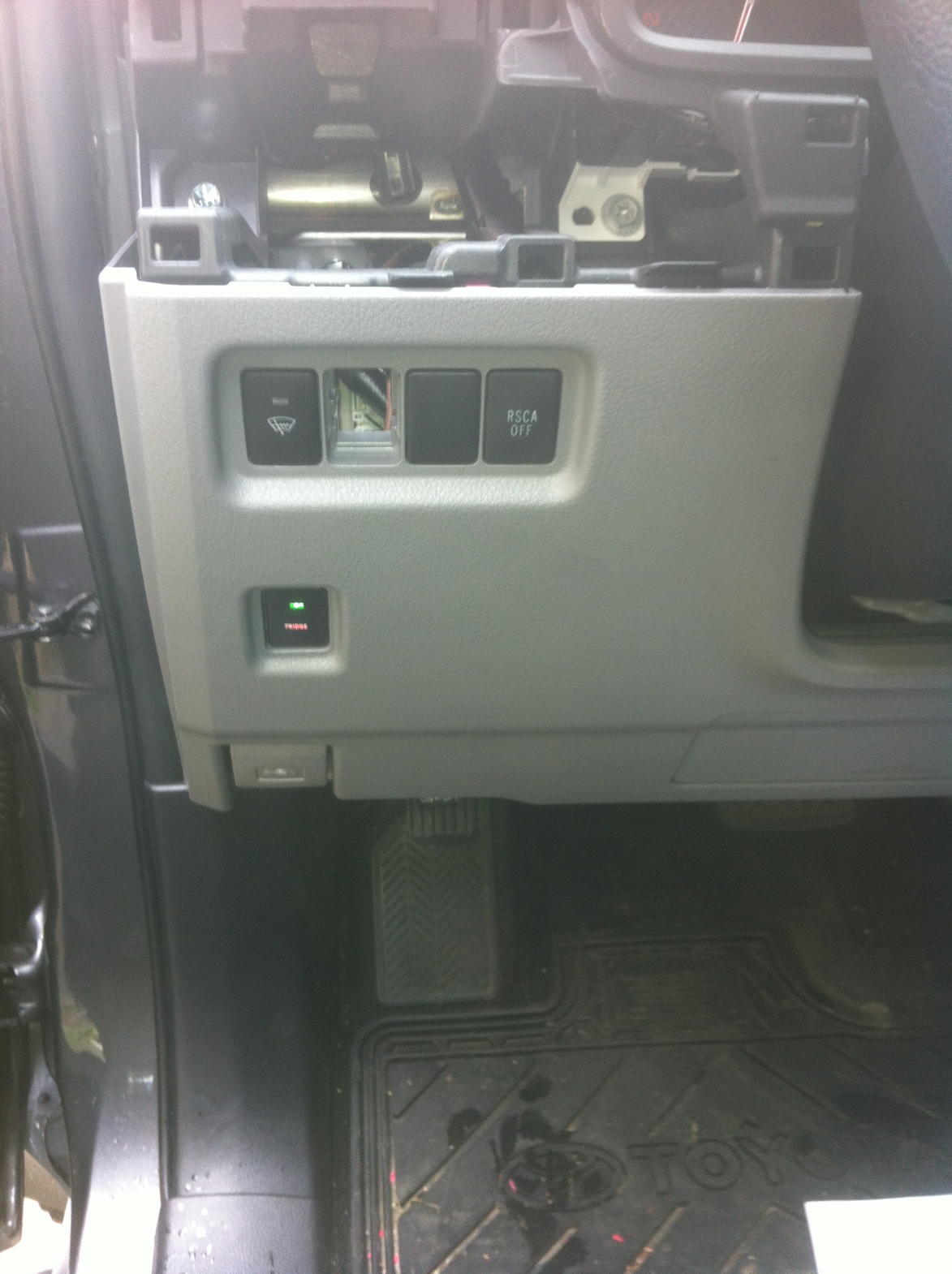

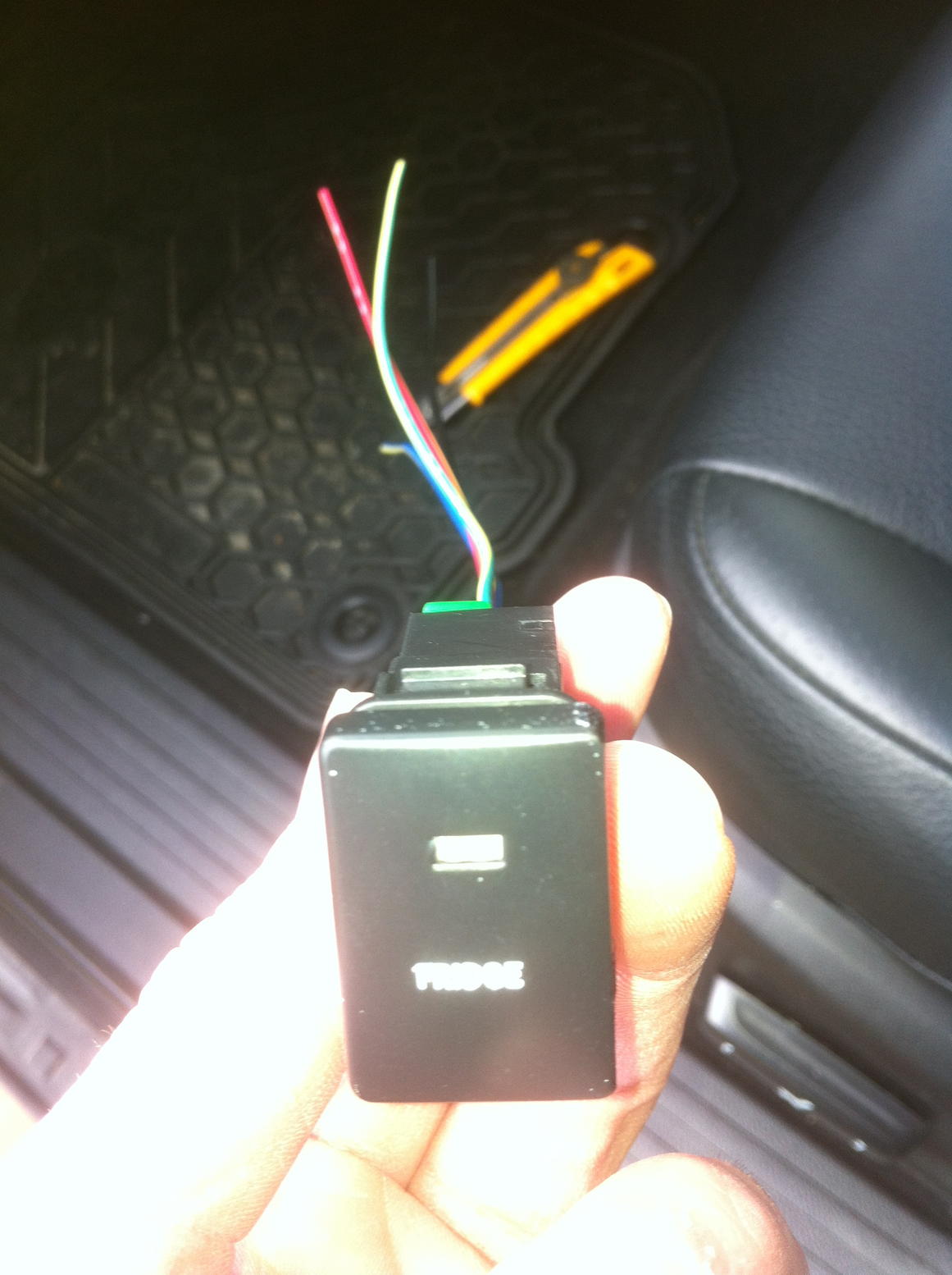

just a little update.... after a long wait i finally received my 'OEM look-a-like' switch from Air on Board switches. easy install, looks as good as stock, and fits in the slot that was already in the dash perfectly.
