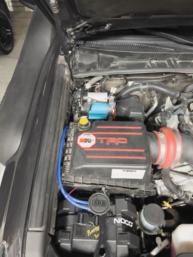

i run a single w/ the shrockworks kit. Mainly because I want to utilize the shrockworks mount and keep it hard mounted to something solid, such as the floor of the engine bay, not the fender wall. I didn't want to utilize any more additional brackets that can potentially rattle loose or use hard to access fender bolts...so no more elevated trays for me (such as the power tray).
Not gonna lie, tempted to move up to a dual, but my single just works every single time, and with the shrockworks kit, if something were needing to replace such as a relay or do maintenance, or when i went to add lockers...it was really easy to do so due to accessibility (space). The shrockworks kit is really well thought out, strong, and simple (KISS). Keeps my OCD happy.
The single works fine in filling my 33's and I'll be upgrading to 34's soon....I'm sure it will be fine with 34's.
