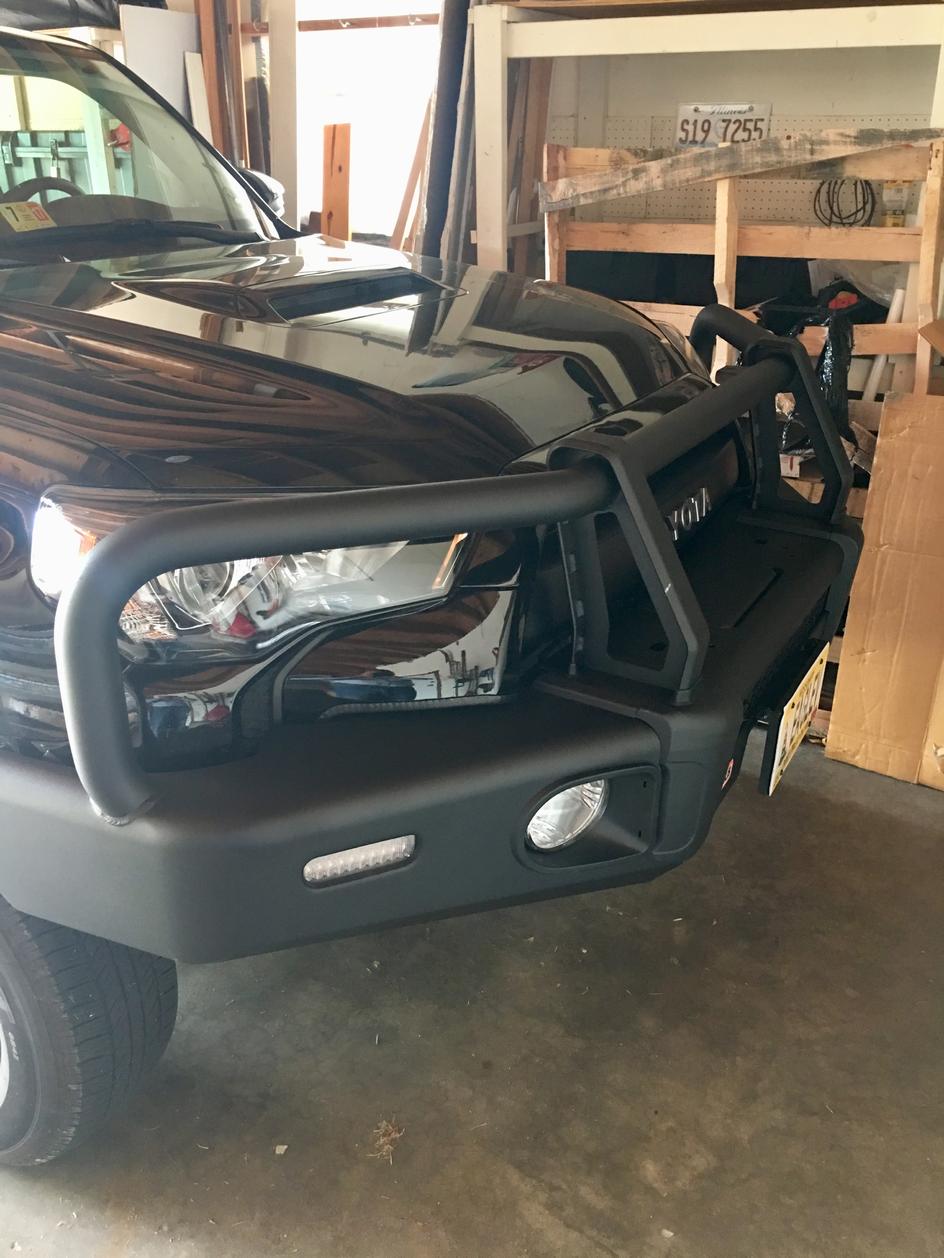

I thought these where really ugly. But this pic is turning me around. Especially since you have the same snorkel as me. Looks tough.
How was the install?
Sent from my SM-N950U using Tapatalk
The bumper is great. I truly like the quality and function of it. It just looks right too. My wife is from Australia and it totally reminds her of home, she says.
Install took me 2 days at my own pace and needed one more person when installing it onto the bolts.

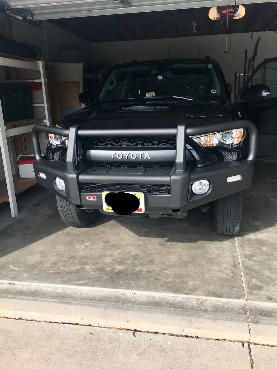

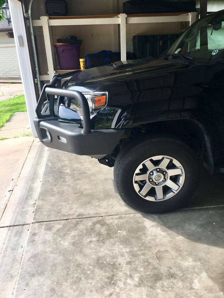

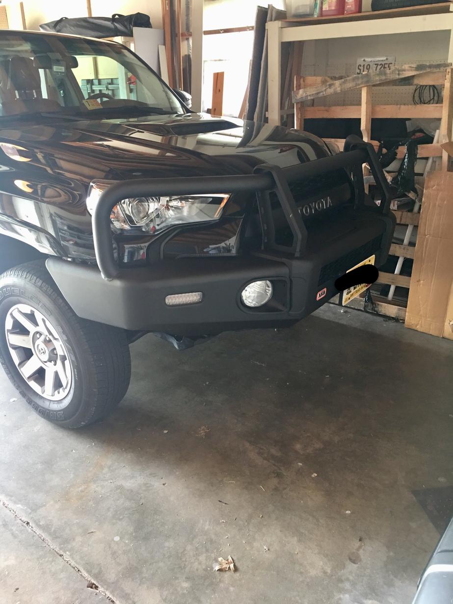

Installed today, love the way it turned out!
