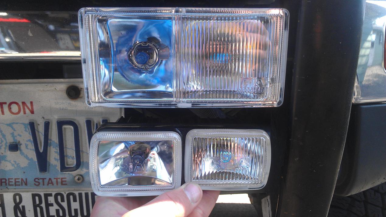

i have been pondering this same dilemma for when i get my ARB... right now i have a set of PIAA 940s, they have the dual h3 bulbs, on side is for driving lights and the other is for fog, and they work great on my brush guard, but they are not going to work in the arb bumper without some serious cutting and i dont think i want to do that. i do however have a set of PIAA 980s that im thinking of mounting in the lower section of the bumper. their is already a cut out there and i think these fit right in that cut out, i know that spot is for air flow and maybe for lifting with a hi-lift but yeah i want better lighting. my IPF 800s are going where your hellas are, and they are way too bright for on road driving.
right now i have my PIAA 940s set up so the driving lights come on when the key is turned on, and they are always on no matter what if the truck is on, and then i can turn on the fog lights(next to the driving light) if i want them for foul weather or rain. they do amazing. and this is how i want to keep the set up, so i like the fact that its a two in one light.
another option is a set of the PIAA 1400 in the Ion Plasma. they are a killer little light and even smaller than just one of the lenses on the 980s... i wish i had a set of them cause id just give them to you... i only have a set of the 1400s in the intense white and they are on the wifes car they are just as bright as the head lights and only 35w.
piaa 940s on top and the 980s on the bottom
