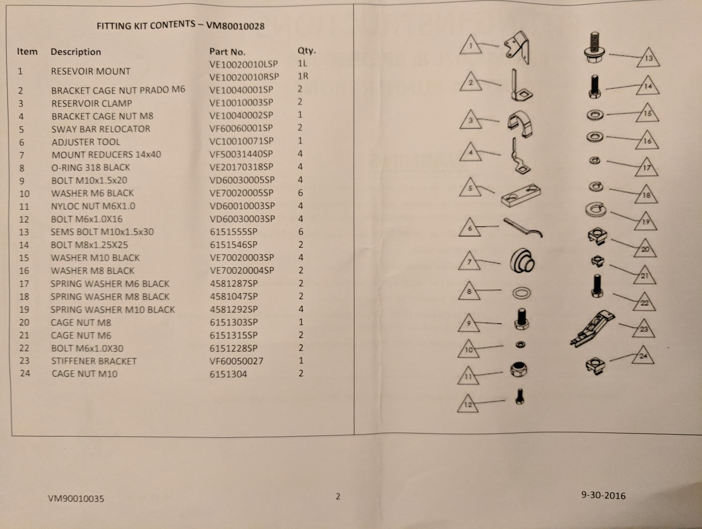

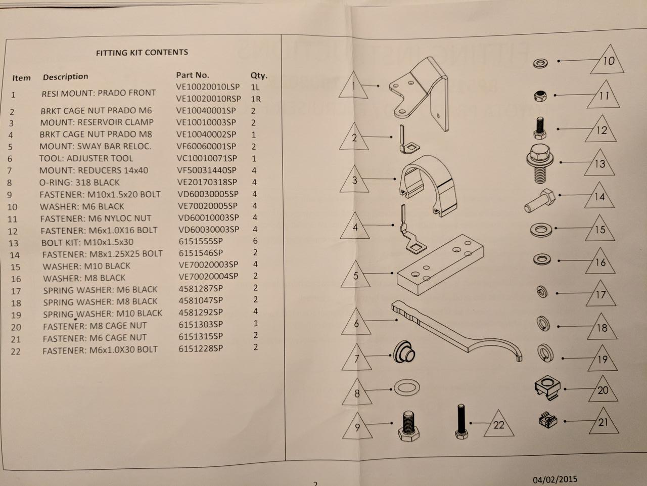

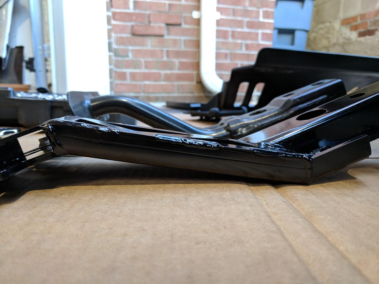

Have a bp51 kit I never installed. Arb released the 4runner front mount fit kit. Discovered this.. a replacement radiator support. Thank you arb!
For reference. Parts list for fj install kit vs 4runner
OME BP-51 FIT KIT VM80010028
Bought from OME BP-51 Front Fit Kit | VM80010028

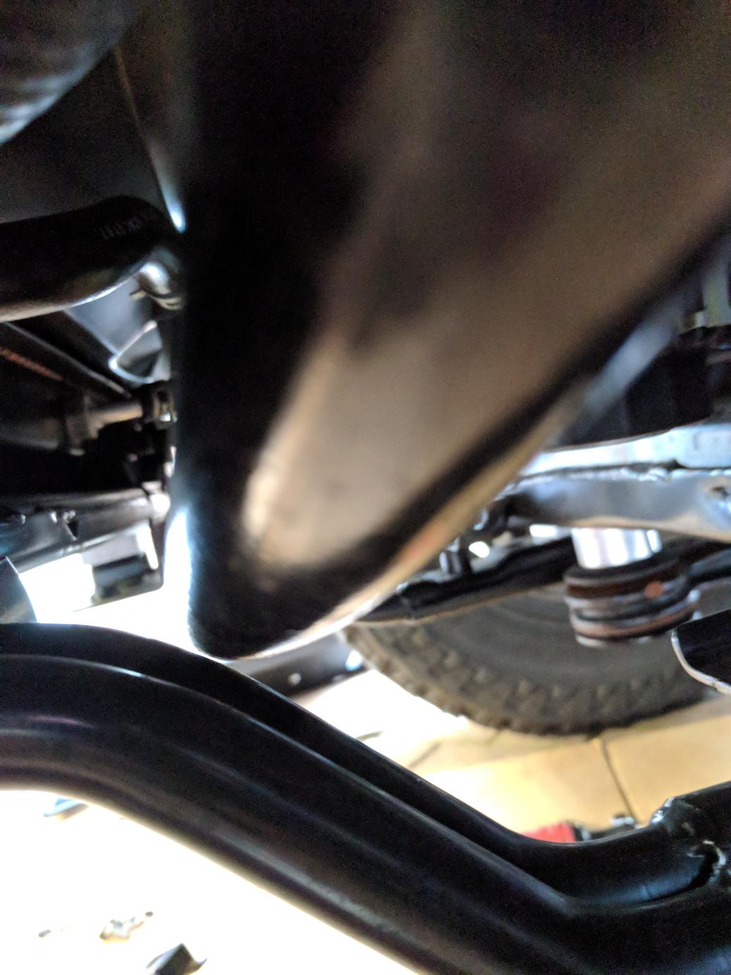

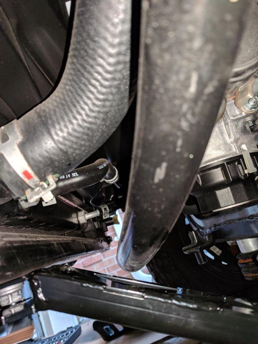

Updated to include Pics of OEM Radiator Support Bracket WITH Toytec Radiator Drop Support Kit.
Installed ARB Bracket with Radiator Drop Support Kit REMOVED.

Wow, this is actually amazing. ATTN: Icon owners here is your fix for swaybar rub! A bit late for me as I already modified my OEM support brackets. Good to know that there is an aftermarket solve though.

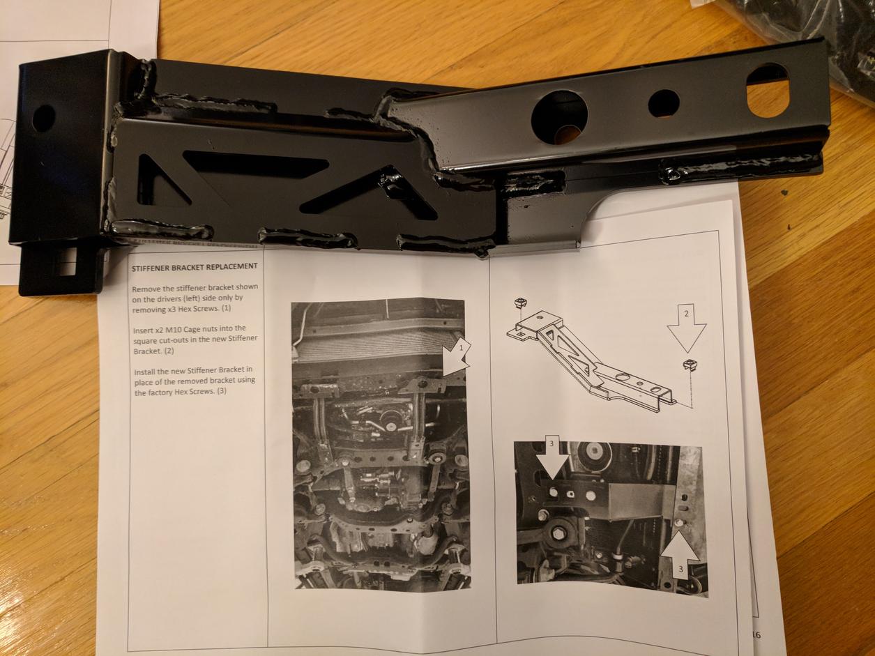

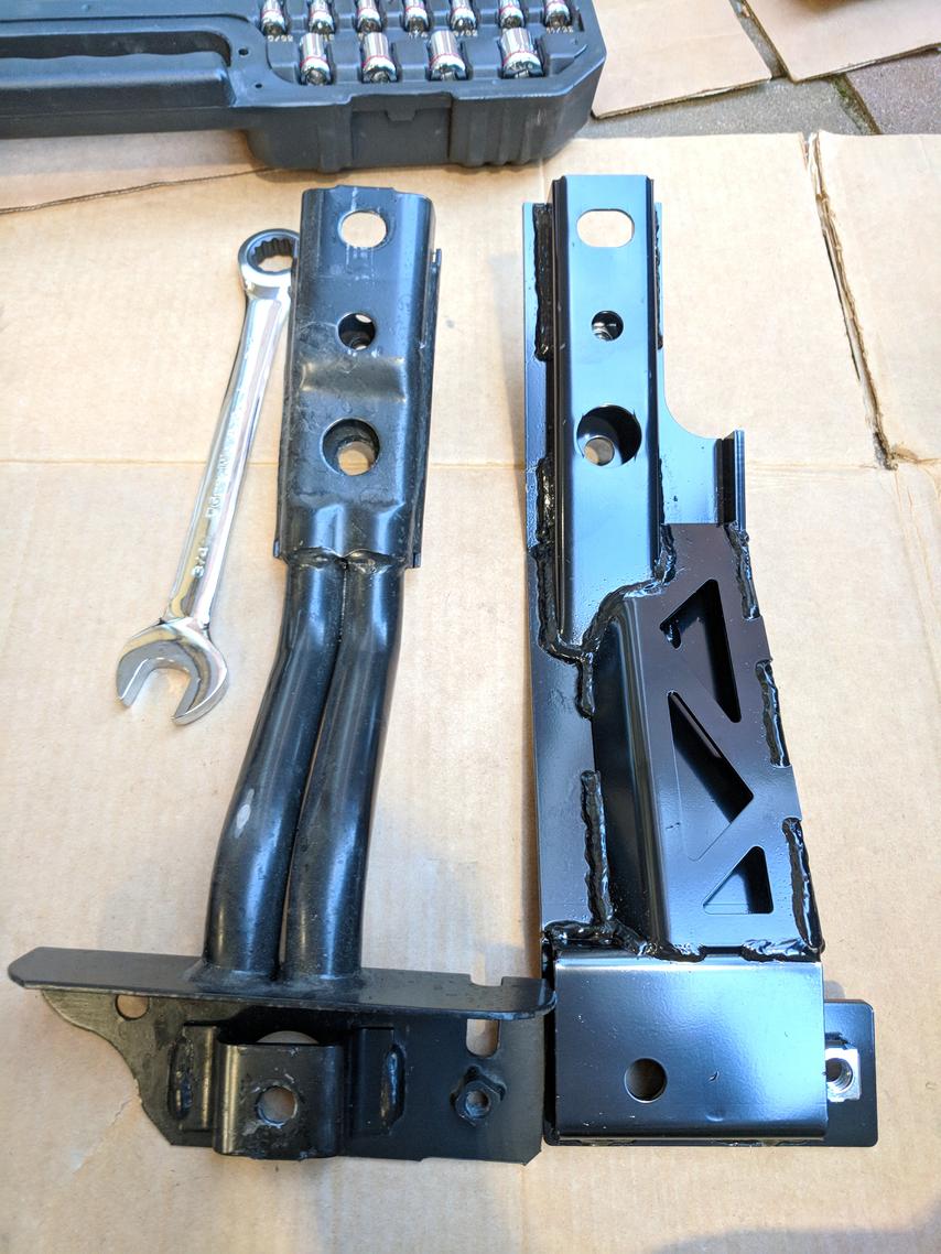

First post UPDATED, Confirmed this works.
Removed Toytec RDSK kit and installed the bracket.
Bracket comes with 2x M10 Cage Nuts, Note... Front Cage nut, should be M8 to match OEM hole size.
Front cagenut was used to install my Hefty Fab Skid plate.
New Bracket does touch my Hefty Front skid plates. But everything still mounts up properly.
[MENTION=156753]rayofsi[/MENTION] this is interesting. did happen to measure or notice that you gain that 1/2" of skid plate clearance back by getting rid of the toytec radiator support drop spacers?
also judging by the parts list, it looks like you replace both oem supports with just the 1 arb support bracket, yes?

you replace only the drivers side one, you keep your oem passenger side support.
I didn't measure. just realized the toytec spacers weren't needed, so i removed them. The toytec spacers never worked.. Most people have the same issue i believe. Could barely fit a sheet of paper between the sway bar.. and the radiator support bracket with the radiator spacers installed

Digging up an old post here, but does this rubbing cause any noises?
Mine is super close, and I’m getting a slight clunking noise from the front end. I don’t know if this is the reason or not.

just tried to install this on my 18 sr5. the instructions say to use 2 M10 cage nuts which will be used to attach the skid plate. ...however, the 4 bolts used to hold on my skid are M8's. i have ordered some M8 cage nuts, but am concerned they will be too small for the square cutout that was obviously cut for use with the 10M cage nuts.
edit to say i've already reached out to arb and received no reply.
Just to clarify that these structural supports are actually for the front suspension system and not the radiator itself. After my last trip into rocks I’ve had enough of the front suspension clunking coming from what I think is the swaybar knocking into my modified OEM supports. Just ordered the kit and am hoping it works with my RCI skids

[MENTION=142164]shrub1[/MENTION] confirming that this works for Icon 2.5" coilovers and RCI skids. I gained about 1"+ of clearance between the swaybar and support beam. Look at my build thread for detailed pics!

Was looking at the bp-51 front fitment kit and it does not look like it has the new support beam in it just the shock overflow mounts. Called arb and they said no radiator support beam included but that could just be a tech that does not know. Maybe the kit has changed or I am looking a wrong one? Thoughts?
That's because it isn't a radiator support. It's a structural reinforcement for the front suspension. It is in that kit trust me.
