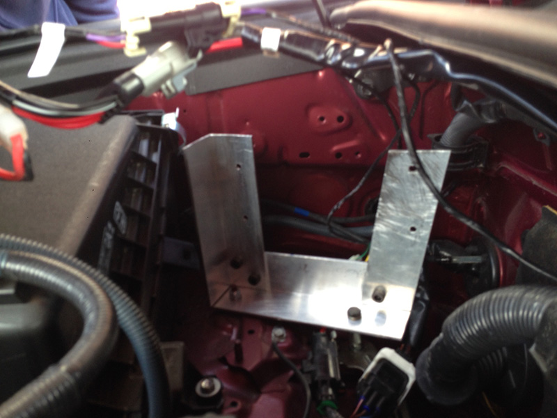

I called the shop this morning to get an update on the brackets -- Justin told me that they had a fitment issue with the brackets, so have had to do some adjustments. He thinks they've sorted things out, and that they will begin shipping them out tomorrow!
yeah; one of their tolerances was a bit too tight and allowed the hood strut to make contact with the compressor air filter. Should be resolved now and they are performing QA again. It has been a challenge for them with not having a vehicle at the shop and having limited access to Jangoforhire's truck.
Having handled one of the troubled brackets, I can say I was very impressed with the build quality (welds etc) and bummed with the fit issue, but Hill has been great to work with to get it resolved so far.

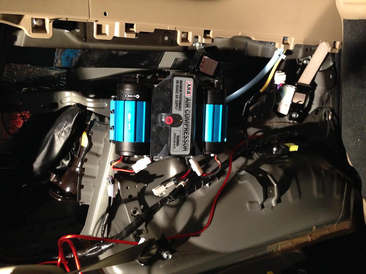

So as many of you know already, the <a href="http://store.arbusa.com/ARB-On-Board-High-Performance-12-Volt-Twin-Air-Compressor-CKMTA12-P21341C9.aspx">ARB Twin air compressor </a>(pictured below) is very annoying to mount yourself. It is really heavy, awkward, and the only place to mount it is hard to get to. I am pretty sure everyone that has this compressor already (Adio3x, Phillyd2, and myself) have had it installed professionally.
I took mine to a local shop to get installed. It cost a lot (~$400) for them to design, test, and install my bracket. This was more than I was expecting to pay, but they did an awesome job so I didn't complain. The owner of the shop has a 4th gen. 4Runner and said that if I got interest in the bracket on the forum he would be willing to make some more of them.
I will get some better pictures of the bracket soon, but it is completely bolt on using stock holes (5 bolts I think), and you only have to relocate one wiring harness (which is basically just removing it from its stock mount).
Also they made a mounting location for the air locker manifold on the same bracket, but I am sure this could be an option and might make the bracket a bit cheaper (less material) if it is made without the extension for the manifold.
The bracket is painted black and re-enforced along all key points.
I called the shop today and he estimated a price of close to $200 for making more brackets. I have to talk more with them but for now lets estimate $250.00 including shipping. This might change more or less depending on when I talk to the shop again, but I am just looking for anyone interested.
It is still expensive, and I still encourage you guys to ask around at local shops, but this could be a viable option if we can get a good price.
