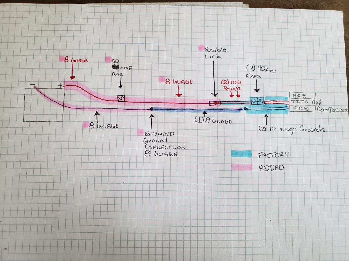

So I'm trying to run the compressor in the rear cargo area. This is the witing solution I have planned. Any input would be nice.
***NOTE*** I looked for write up's and diagrams but apparently the only rhing anyone cares about with an ARB compressor is where to mount it.
