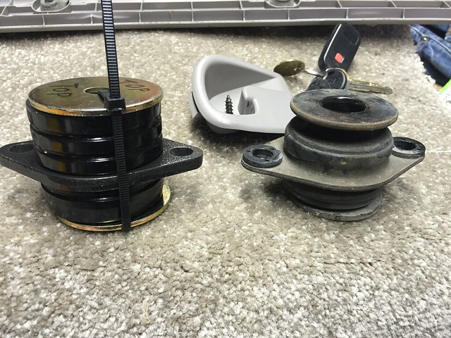

So Sonoran Steel Rear body mounts were installed
old mounts looked beat
New SS rear mounts VS old oem mounts
buttoned up and all new
