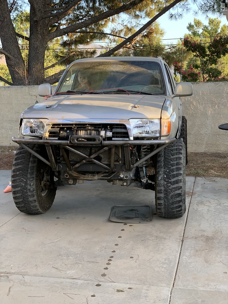

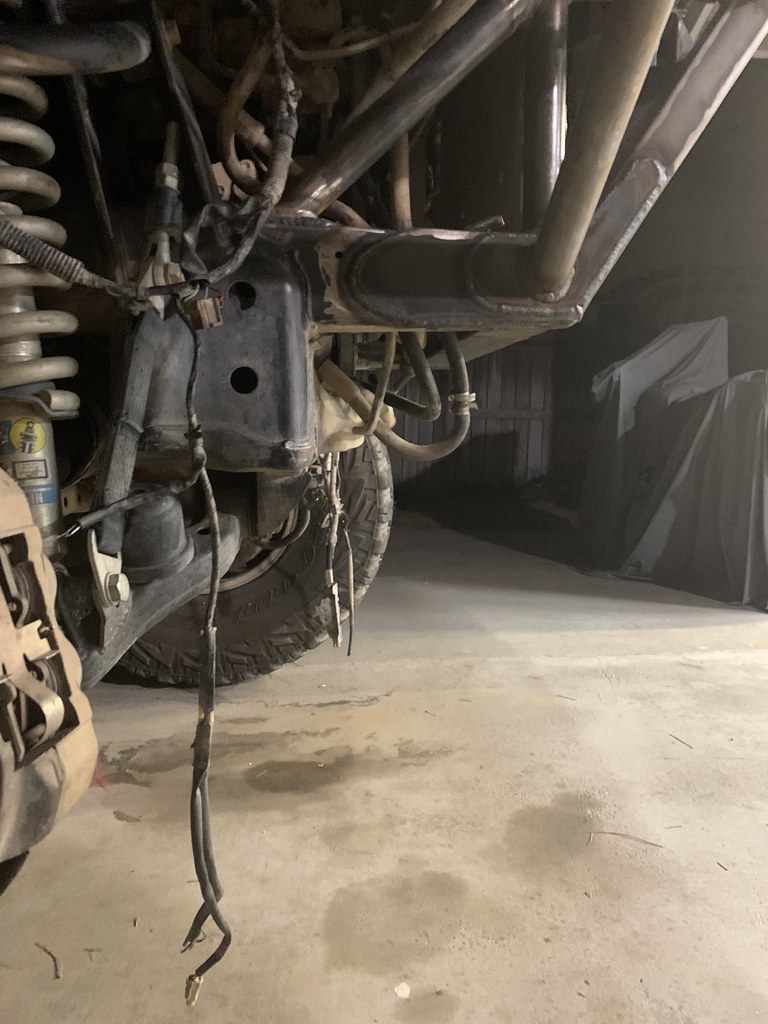

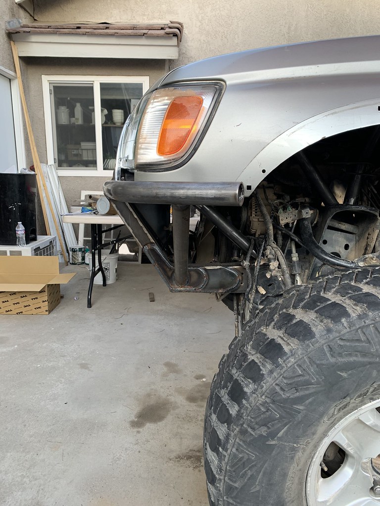

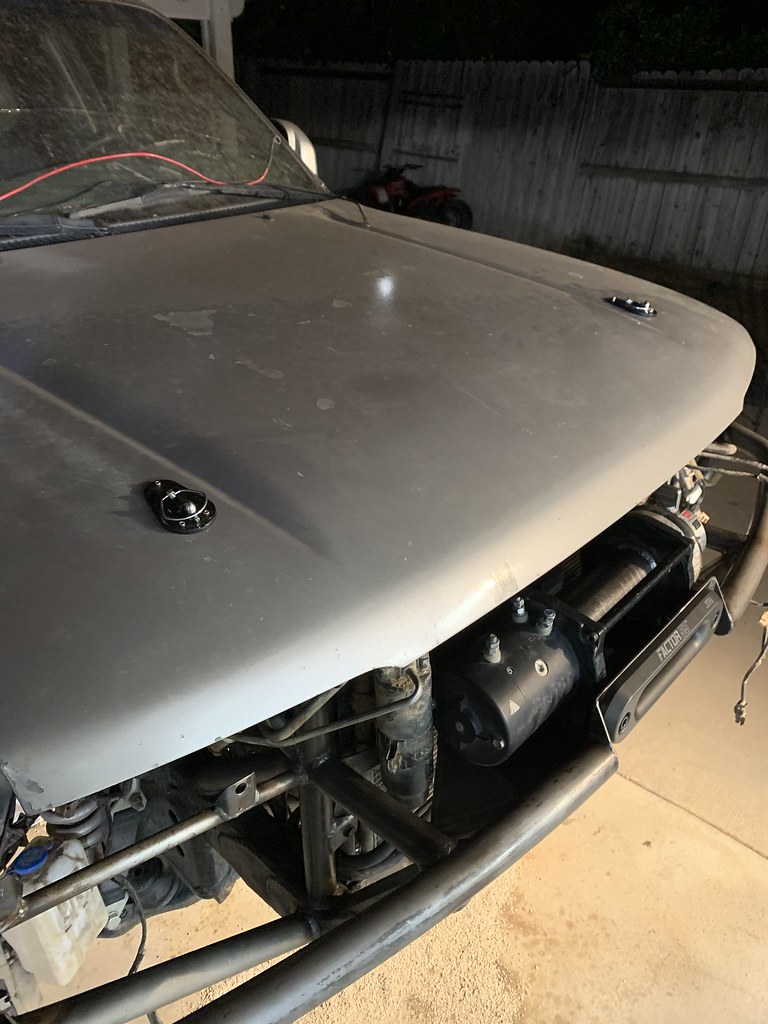

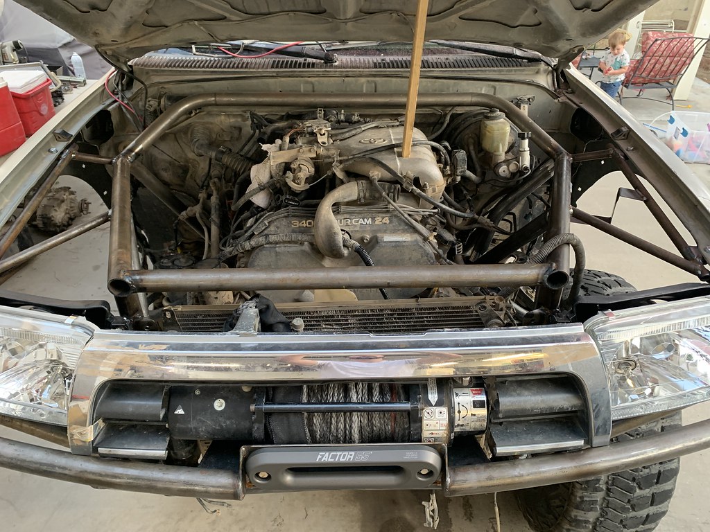

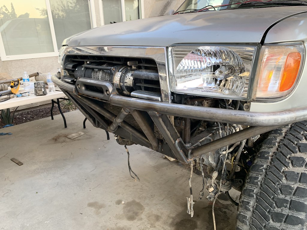

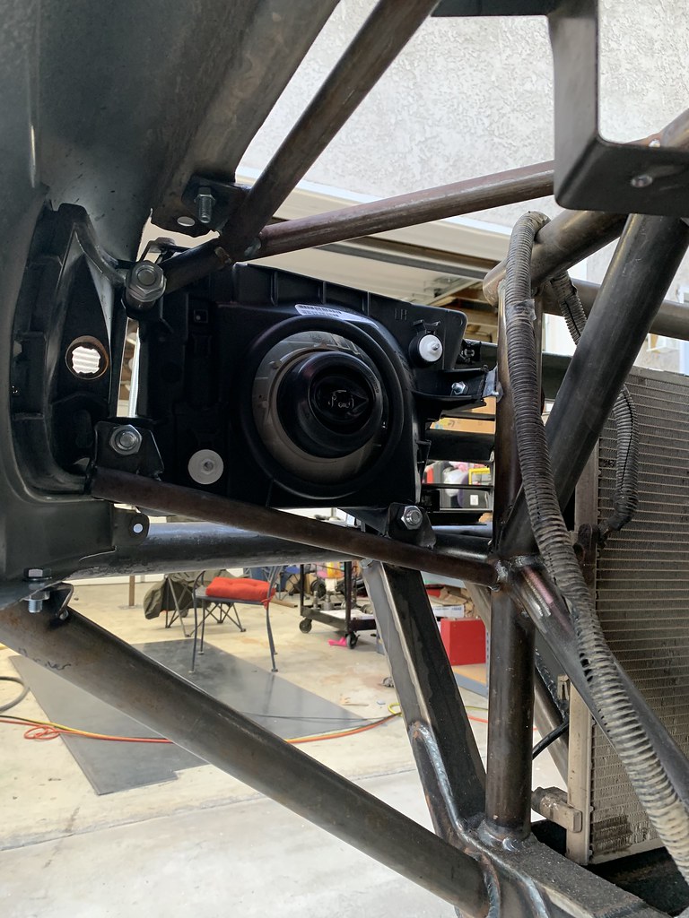

Figured some of you might enjoy seeing this. It's not 100% done yet, since I still need to make some skids, fix some brake lines, mount the battery in the rear cargo area (and wire it) and get some new corner lights and filler panels. It's coming together though.

[MENTION=118730]AssBurns[/MENTION] Can you post the link to your build thread on independent offroad forum in your first post? I like to check on your build progress over there but always have a hard time finding it in your build thread here. I'm a little special :llama:
Awesome tubing work! But please tell me that's not the vehicle you ordered the hood strut kit for, we'll need to talk if it is :).
Heck yes it is! I’ll make it work. There are still fenders to mount it to. It’ll work as intended
Will the rig though? lol
Nice approach angle. I can't wait to get on the Dusy and see how much of a difference that makes. Are you worried about the winch center line being higher then the fairlead or is that an optical illusion?
The winch centerline is supposed to be higher than the fairlead centerline. You want the fairlead hole to be centered with the range of the winch line coming off the bottom of the spool.
