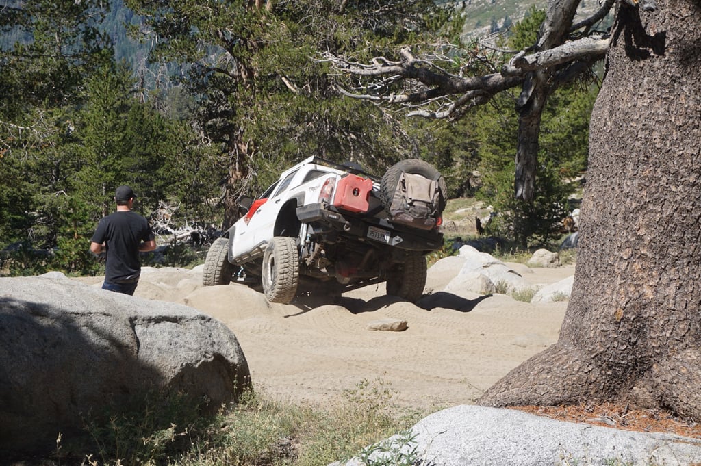

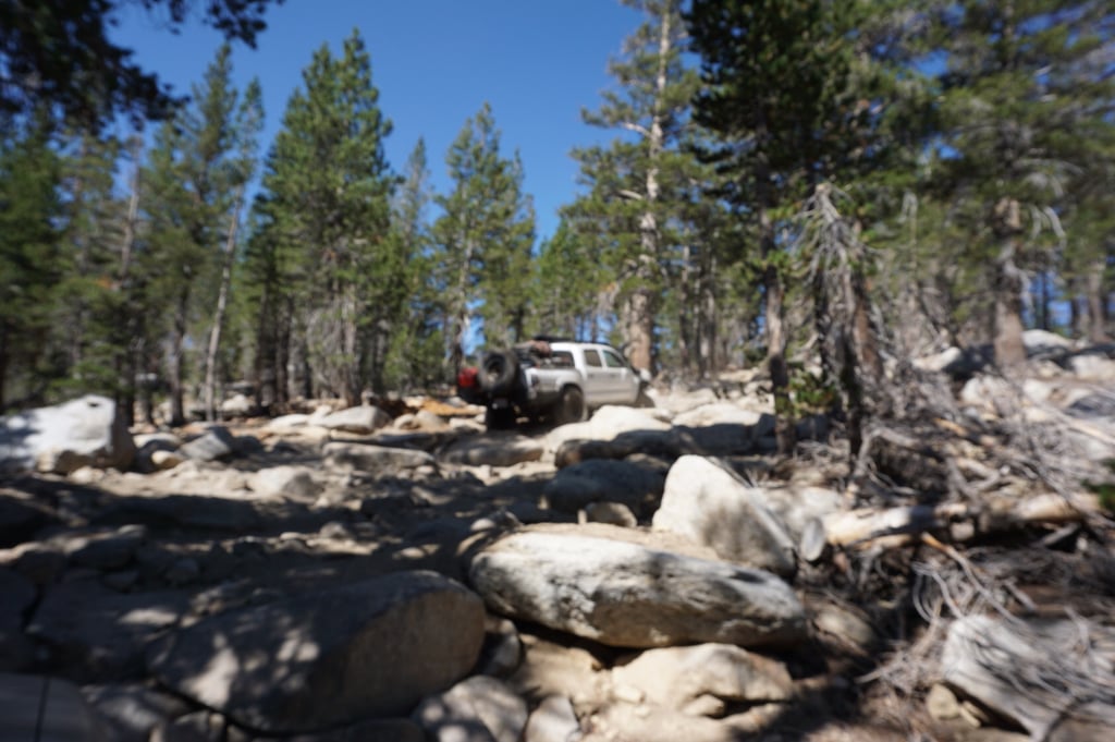

We kept moving on and came to the last rock garden. Definitely difficult but we were coming down, so gravity was on our side again making it a little easier than going up it would have been. Sure enough, right before our final rock section, [MENTION=143526]theesotericone[/MENTION] broke another CV. This time it was the inner joint, just like I had issues with in the past using this same brand of CV’s. My conclusion is that the axle shaft is too short and not getting enough plunge into the inner cup causing the tripod joint to basically tear its way out when the roller comes out of the cup. We tried to replace the broken CV but the 2nd spare I had wouldn’t fit. It was almost as if the outer joint was binding and wouldn’t let us get the spindle seated to the LBJ all the way. So instead of messing with it any more, I just pulled out the inner and out CV stubs I carry with me, and plugged the diff and hub, so he can at least get through the last section in 2 or 3wd.

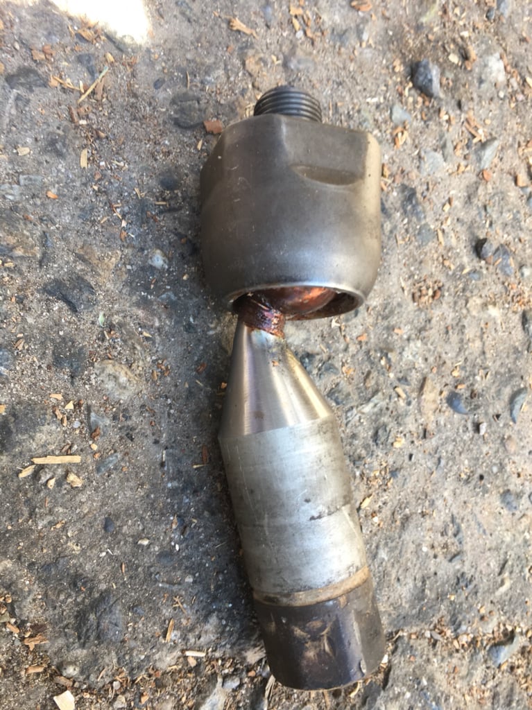

As we were all getting gas, we looked at our alignments. Mine was still good, [MENTION=143526]theesotericone[/MENTION]needed a minor adjustment as would be expected after replacing the tie rod, then [MENTION=135317]rkntoy[/MENTION]’s alignment was way out of spec. Way to much toe out on the passenger side. We got [MENTION=143526]theesotericone[/MENTION]’s alignment dialed in a couple minutes, but [MENTION=135317]rkntoy[/MENTION] was quite a bit more work than that. First we could not get the jam nut loose on the tie rod. We tried WD40, then held a lighter up to it for a few minutes to heat it up. Finally we got it to bust loose. We went to adjust it by spinning the inner tie rod, and only got a half a turn. How weird! Why would the inner tie rod not turn? Pulled the boot back to see the inner tie rod to be significantly bent. So glad we caught that before he hit the road for a 13 hour drive. Luckily we all had spare tie rods with us, so we got the tie rods replaced, then did an eyeball alignment. Cleaned up the tools and [MENTION=135317]rkntoy[/MENTION] was back on his way to Oregon.

[MENTION=135317]rkntoy[/MENTION]’s broken tie rod that we caught last minute before his long drive.
