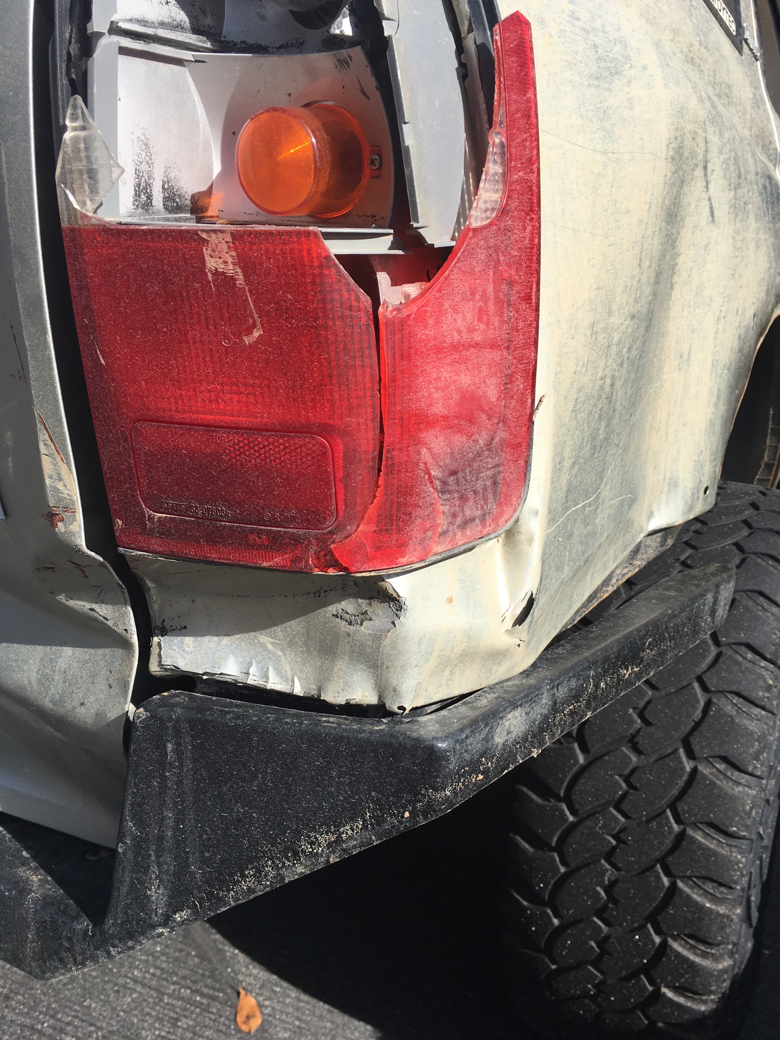

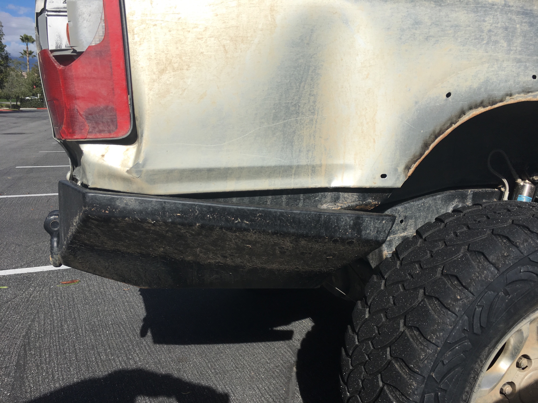

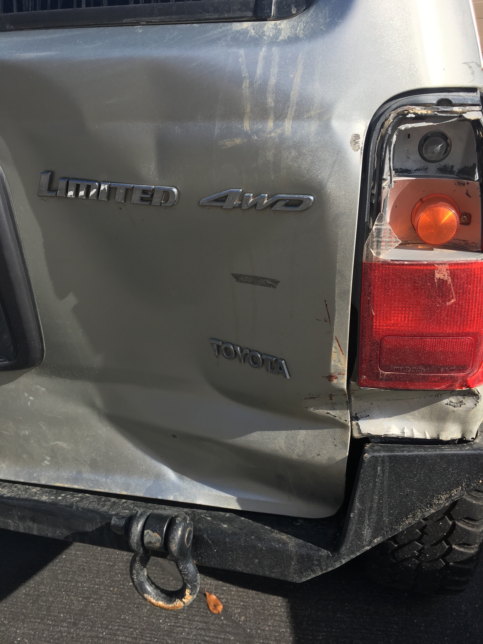

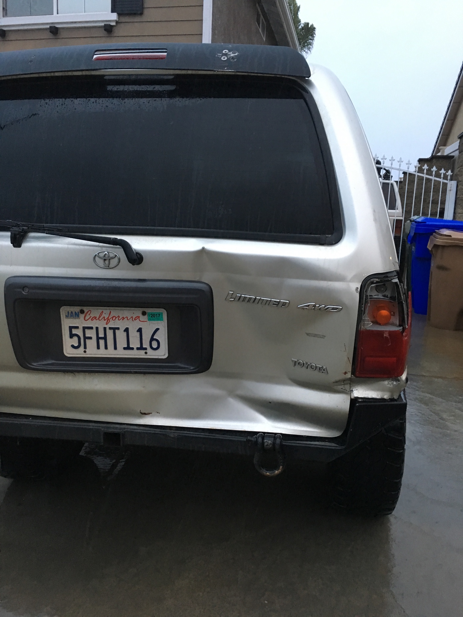

Here are some of the damages. Now my hatch doesn't close nice and tight like before, causing the hatch to rattle over bumps. Bumper is bent up but can be salvaged with some work.

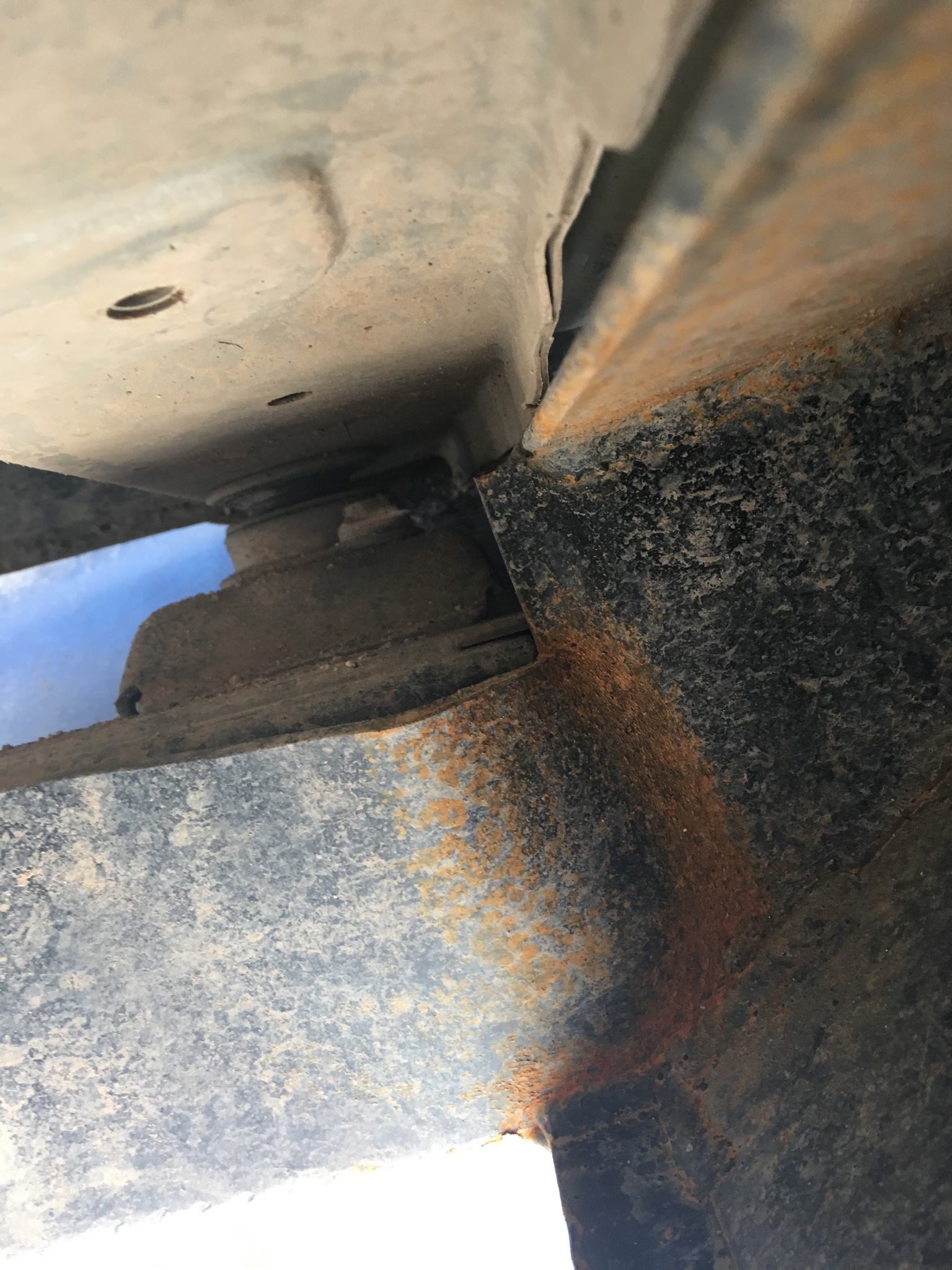

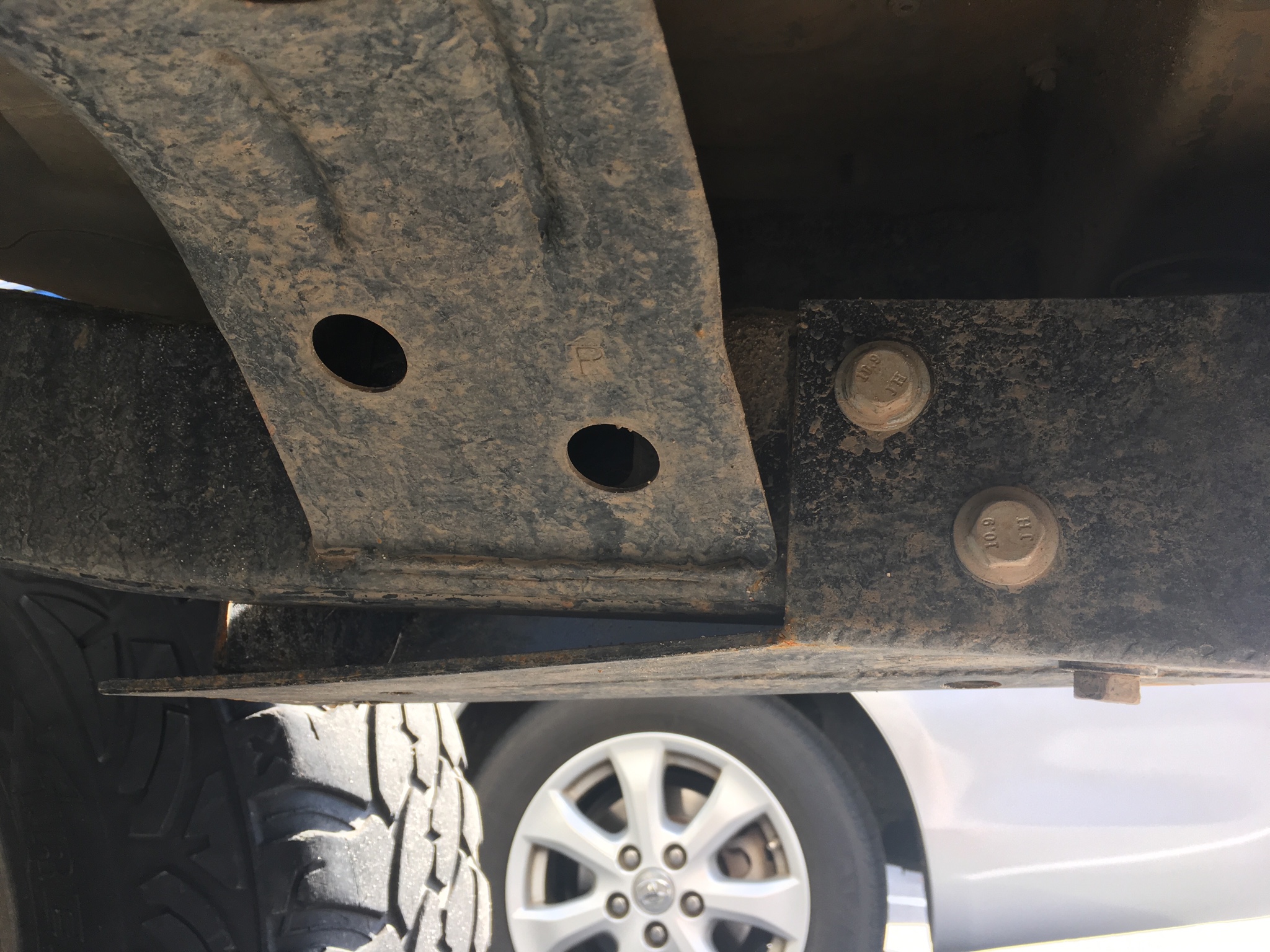

Passenger side frame mount.
I knew I should have added another plate and set off bolts right here but unfortunately didn't do it.

That needs a pull to get that wrinkle out of the quarter and make a replacement hatch square up with the opening...
(Got a come-along and a tree?)

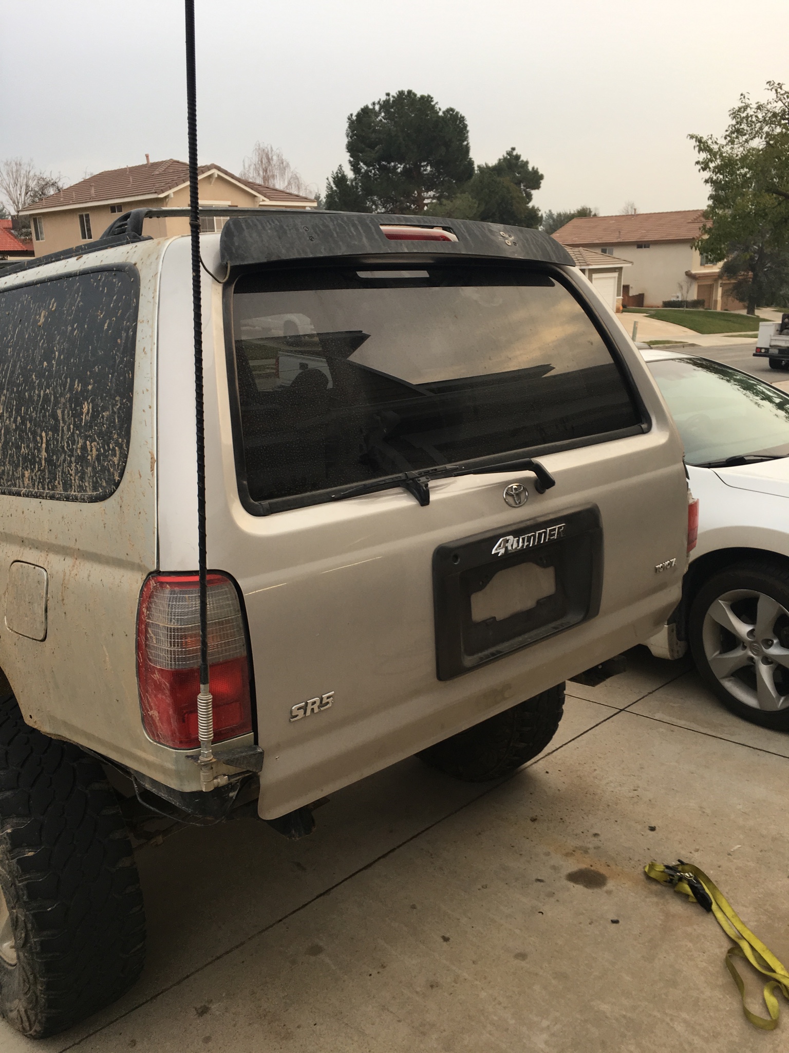

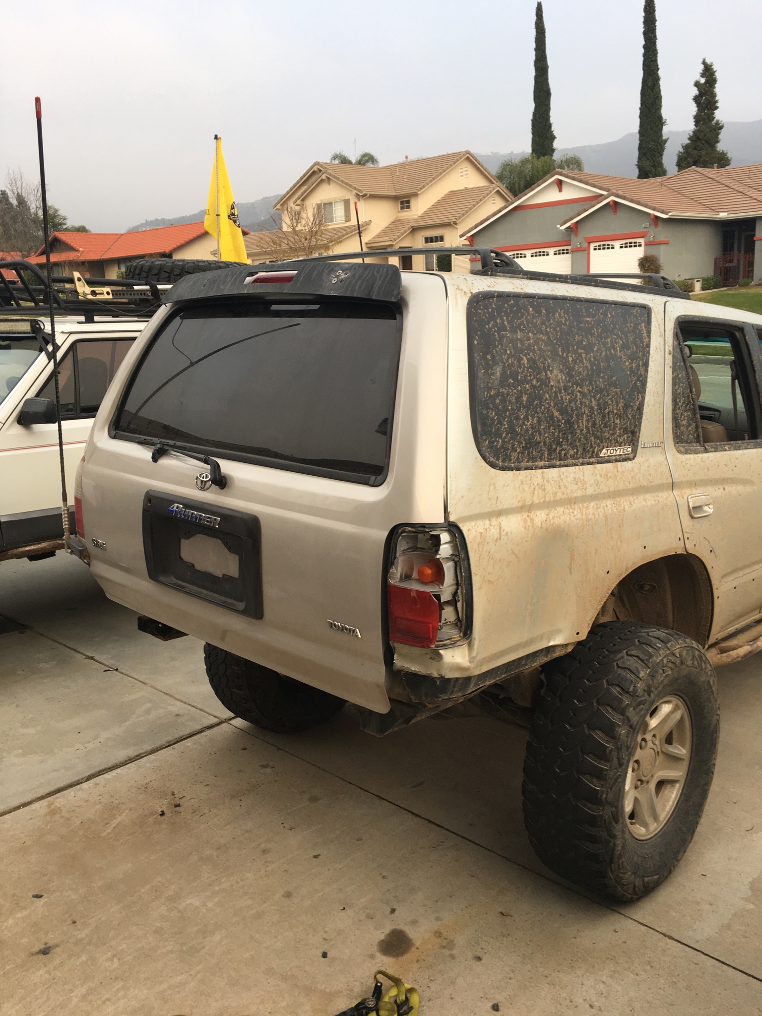

Swapped my rear hatch today. Turned out to be a much bigger pain in the ass than I expected.

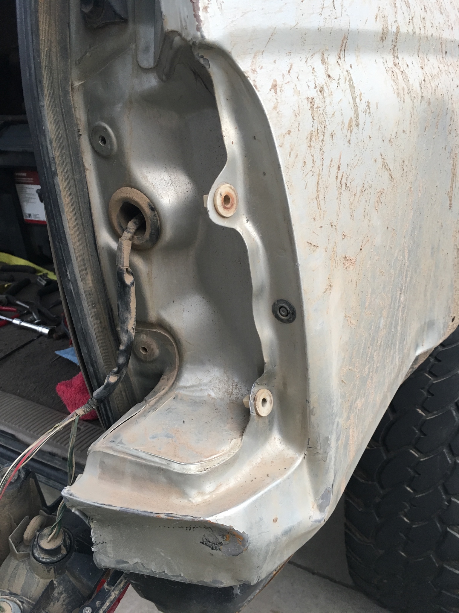

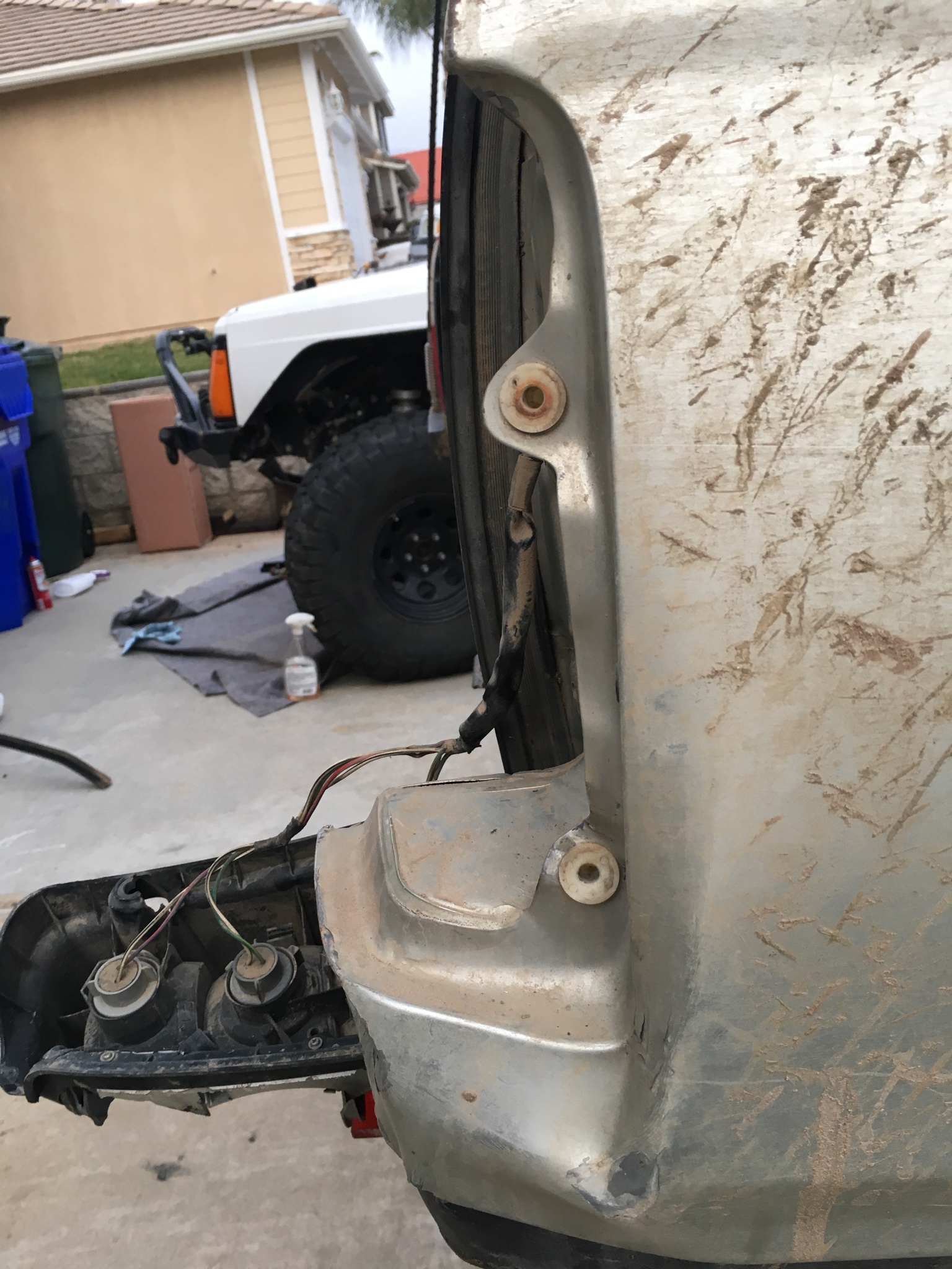

Yesterday my brother and I went and got a couple quotes for the repairs. While we we waiting my brother started looking online for replacement parts (Hatch, Tail Light). We decided to hit up the local pick-a-part to find a hatch. We found a '98 SR5 with a clean hatch that matches paint, or at least very close to matching. I think my paint has a little more metallic to it but looks like the same color. We grabbed the tail light while we were at it. For both things, the total cost was $80.10. Swapping the hatch itself was super easy with my brother helping with holding up the weight. I went to plug it in and noticed one of the connectors was different. The '98 hatch had a 10 pin connector while the 2000 has a 4 pin. Did a little googling and heard someone talk about swapping the whole harness from the '00 to the '98 hatch. I wasn't 100% sure this would work but I tried it anyway. Luckily all the connectors for the lock, window, wiper, lights, etc were the same. Swapping the harness was easy except trying not to break all the clips. Also swapped out the lock barrel for the hatch. Everything works properly but was not expecting that much work just for the damn hatch.
I went to swap the tail light housing too but since the quarter panel is so tweaked, the light doesn't fit at all. I'll be rockin the broken tail light until I decide what to do. I pulled the bumper and I think I can straighten it out with a BFH. I threw in some ear plugs and went to town with a 4lbs hammer but eventually broke the hammer before I could finish. It looks pretty close to being straight already.
