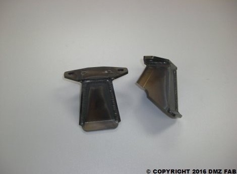

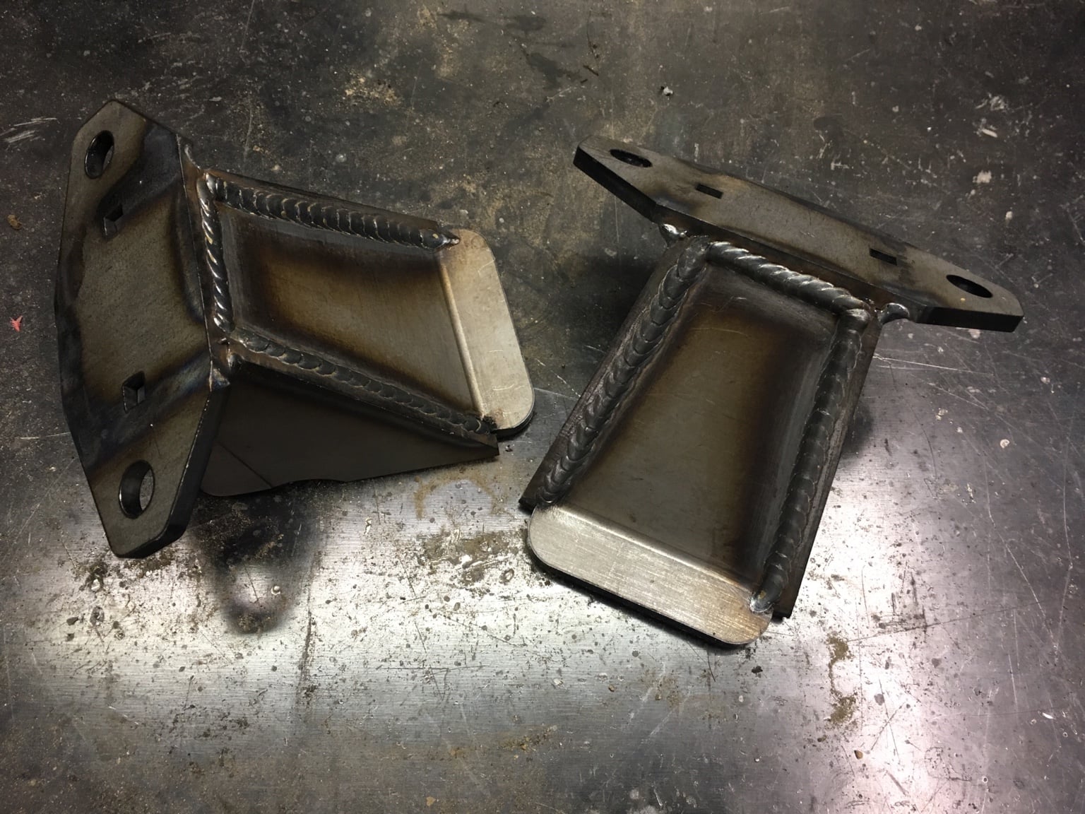

Well lookey here! I was able to find a set of pre-fabbed engine perches made out of 3/16" steel by DMZ Fab. $149.95 though. These will be cleaner than I can fab up myself and save me a bunch of hassle. I'm still pretty sure I will have to pull the engine to get enough room to cut the old ones and get some good welds on them.
Tacoma Motor Mount Perches | DMZ FAB

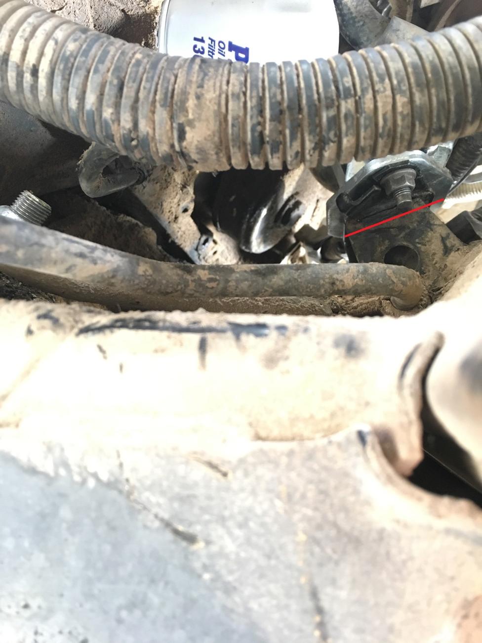

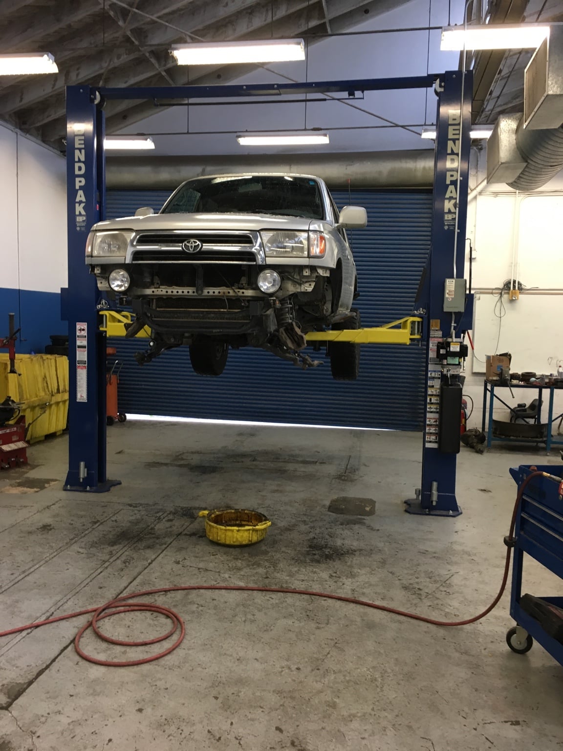

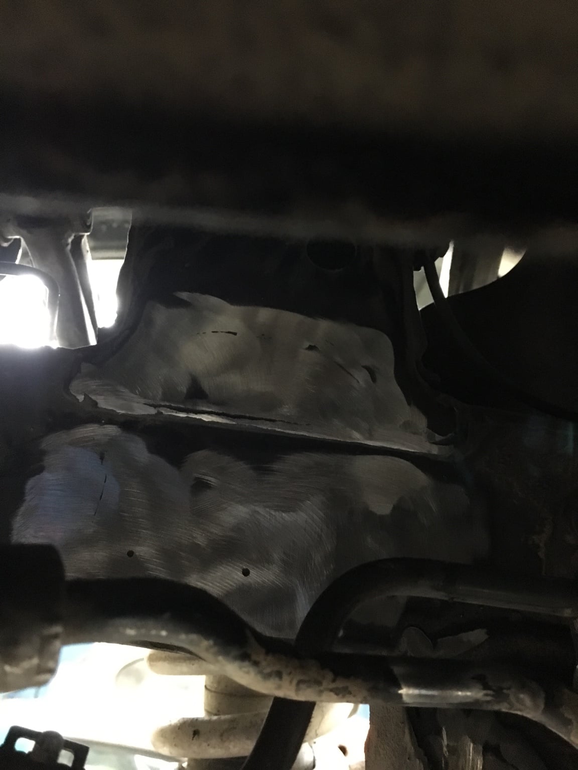

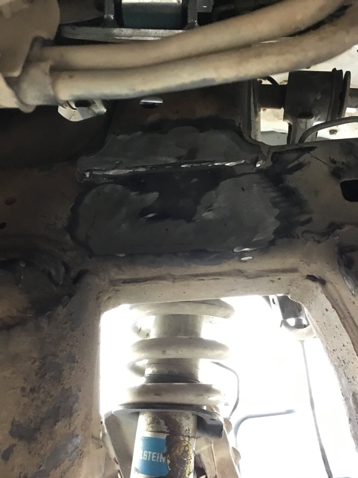

Got the new motor mount perches today. They are pretty solid and well made. Went and talked to my buddy about helping me fix this. We think we can get away with not having to pull the motor. The plan is to pull the differential, and possibly the alternator and exhaust manifold if needed. Since he has a plasma cutter and a full shop, and way more knowledge then I will ever have, I will have him assist me in this project. I only have a week to get this done before my Christmas wheeling trip. Let's hope I can get it done in time.
Finished up the motor mounts this morning. It was actually quite a bit easier than I expected. It took about a total of 8 hours of work between Friday morning and this morning. I was too busy trying to get things done to take pictures but I managed to snag a couple at one point. We only had to pull the front diff, CV's, and unbolt the steering rack out of the way to get enough room to work. The biggest PITA was after plasma cutting the mounts off, grinding everything smooth with almost no room too work and grinding overhead sucked. Didn't have much room to weld all around so I just welded the sides and bottoms, and tried to get some welds on the top. Should still be plenty strong though. Now I don't have to stress about motor mounts and getting shit finished before my trip.

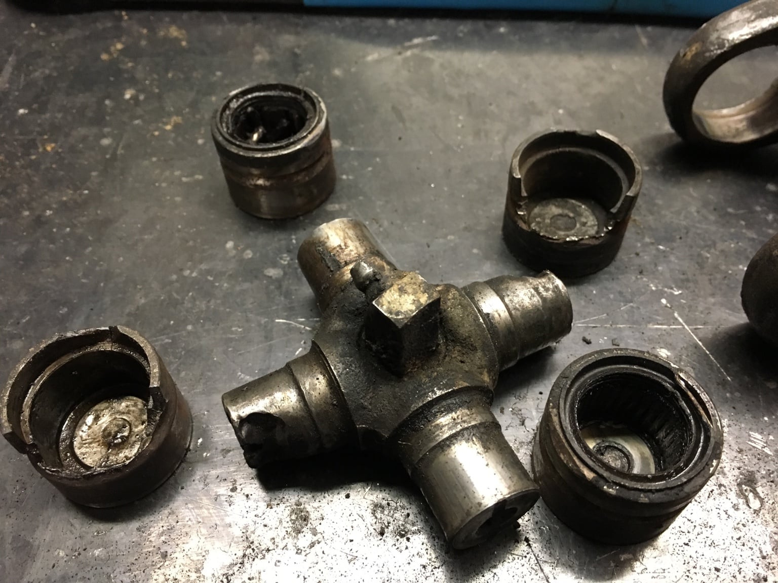

Yesterday I finally got time to install my rear U-Joint. What a ***** that turned out to be. I could not get the caps to come out. I ended up heating it up with a torch and soaked it with PB Blaster, then it finally broke loose. The old U-Joint was completely trashed and the caps where broken too. Now no more driveline vibrations.

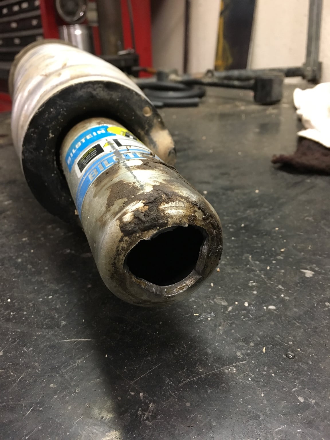

Today my brother and buddy invited me to cruise up the mountain to go snow wheeling. It was a blast until my shock broke at the lower eyelet. At first it wasn't so bad because the bump stop supported some weight and gave some dampening. Then about halfway down the mountain, the bump stop ripped off causing me to be completely bottomed out the rest of the way down the hill. I was rubbing on the fender a little bit and the wheel well where the intake box is. It was supper annoying driving home like that, but wasn't anything too bad.
Now I have to replace my shock and bump stop before I leave to Ocotillo Wells for New Years on Thursday. The plan was to go with coil overs soon but I don't really want to spend the money right now on coil overs right after Christmas. I'll just get a replacement 5100 for now and put the coil overs on hold until after tires, UCA's and rear control arms since those are ready to be replaced/ upgraded.

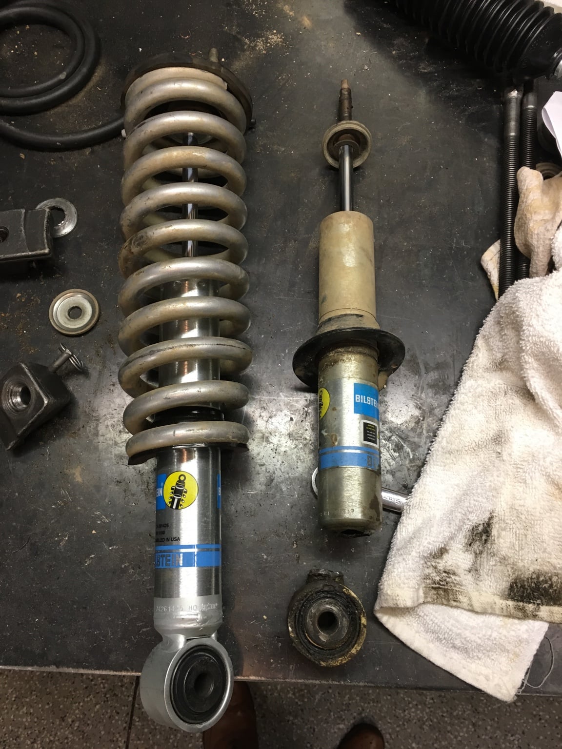

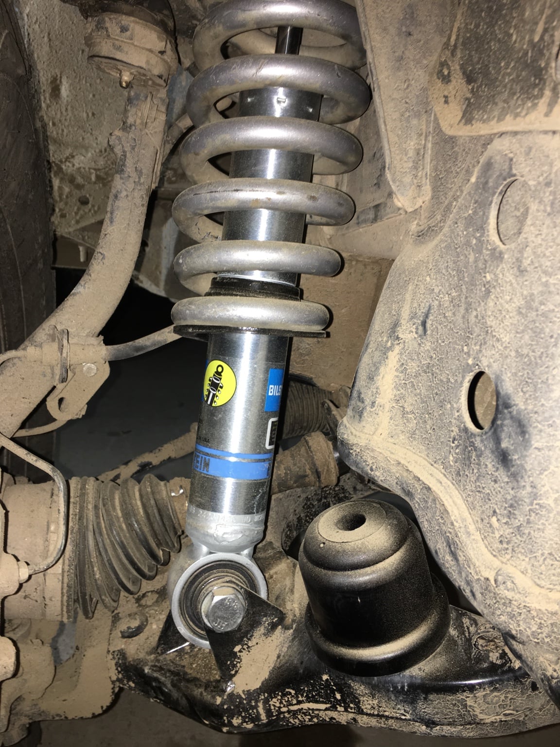

Wow what a pain in the ass putting the new front shock turned out to be! I bought a new Tundra 5100 on Tuesday and had everything assembled then realized, since I didn't use the rubber boot, I forgot the little aluminum spacer that pops into the boot but is still needed. So I compressed the spring, and started unbolting the top nut. The nut ended up getting tight while loosening it, so I put a wrench on the the top of the shaft where a wrench goes to keep the shaft from spinning. With a little force to try to get it past whatever it was stuck on, the damn thing broke! I was too pissed to get my phone out to snap a pic. Luckily I got the part through my brothers work and they warrantied the part so I cut the stuck bolt off to get my coil off the strut. Luckily it's all back together and ready to roll.

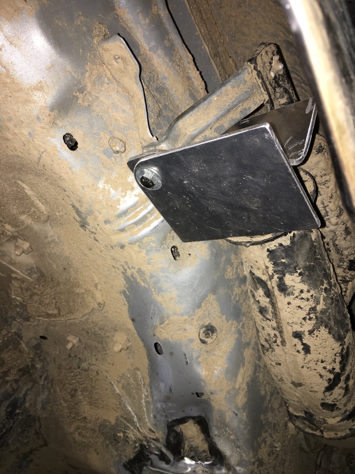

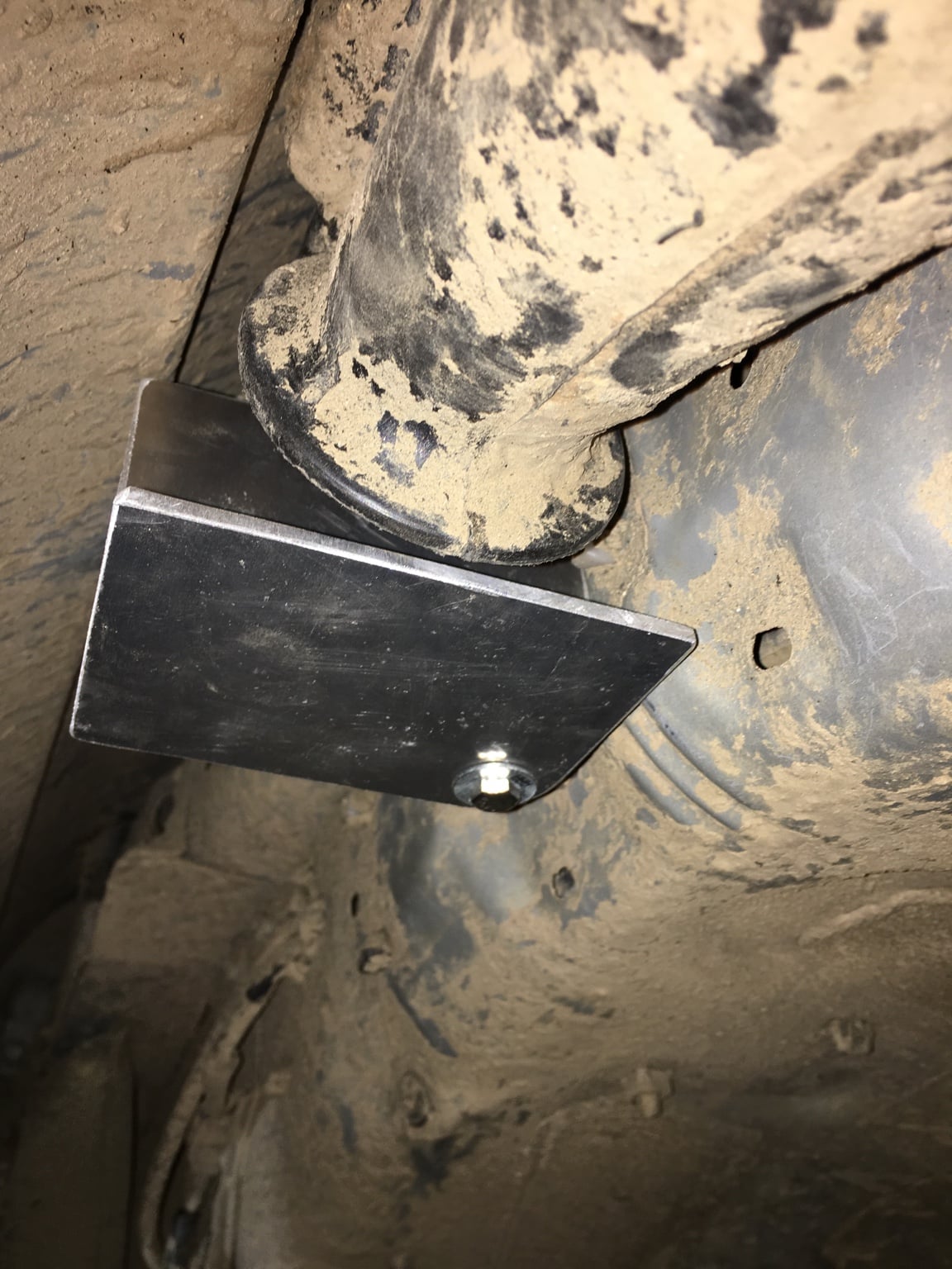

I also made a little mud guard out of two pieces of scrap aluminum. It's not pretty but it will help for now until I figure out how to relocate the intake away from the wheel well somehow. Since the plastic wheel well liner ripped out and going through all that mud last week, I sucked up all kinds of mud into my intake. There was like an inch of mud in there. I never noticed before because I don't think I've touch mud in about a year since the liner fell off. I always avoid mud whenever possible.

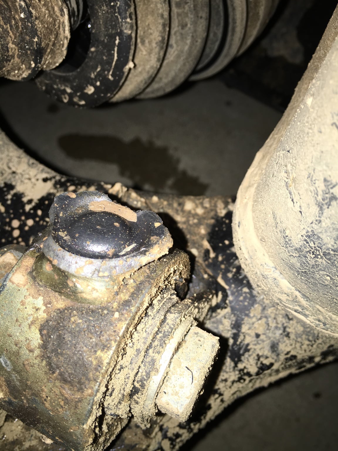

Alright so now the rear control arm bushings are completely shot. It's actually scary driving down the road at highway speed. The rear end just floats around and wobbles pretty bad and the torque steer sucks! So it's time for an upgrade. Since the control arms keep bending and bushings don't seem to last long, I need something that can handle the abuse I keep putting them through. So the plan is for adjustable uppers and lowers so in the case that I bend them or something, I can swap the joints. I'm most likely going with the MetalCloak Duroflex joints in the 2-5/16" and 2" widths. With these I will need to use tubing with 1.5" ID. Now I am deciding what size tubing I'd like to go with for the lowers. I doubt I will ever be able to bend 2.0" x.250" wall tubing in such a short control arm, so I'd like to keep the weight down. I could go with 1.875" x .188" wall tubing. This will be plenty strong and lighter but I still need to price it and check availability. I also am debating on just going with 1.75" x .120" wall for both upper and lower links. This size still has a higher moment of inertia and is lighter than 1.50" x .250" wall that most manufacturers seem to use. So I might just go with this size since it's lighter, cheaper and I already have some in the garage.

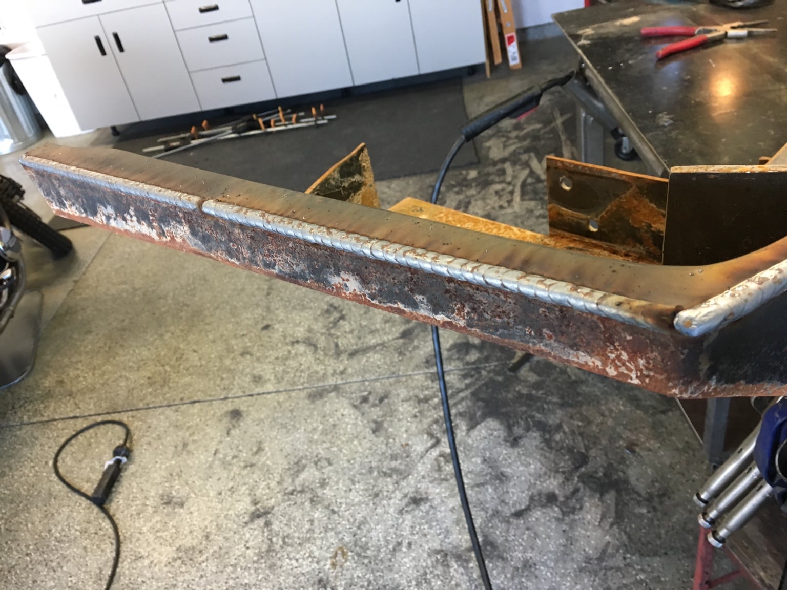

Just ordered the joints from MetalCloak and four 1"-14 thread tube adapter bungs for 1.5" ID tubing from Trail Gear. I realized that the 1.75" tubing I had in the garage was HREW, so I had to go to the metal supply to pick up tubing. Since I was there I said screw it and went with 2" x .250" wall for the lowers and 1.75" x .120" wall for the uppers. Now I don't have any excuse to mess these ones up. I got some extra 1.75" tubing to hopefully start my front bumper soon. Pretty stoked on getting this part of the build out of the way. Now I might have to wait a little longer to get new tires since I dipped into my tire and front UCA funds. Hopefully by the end of February I can get those finished though.

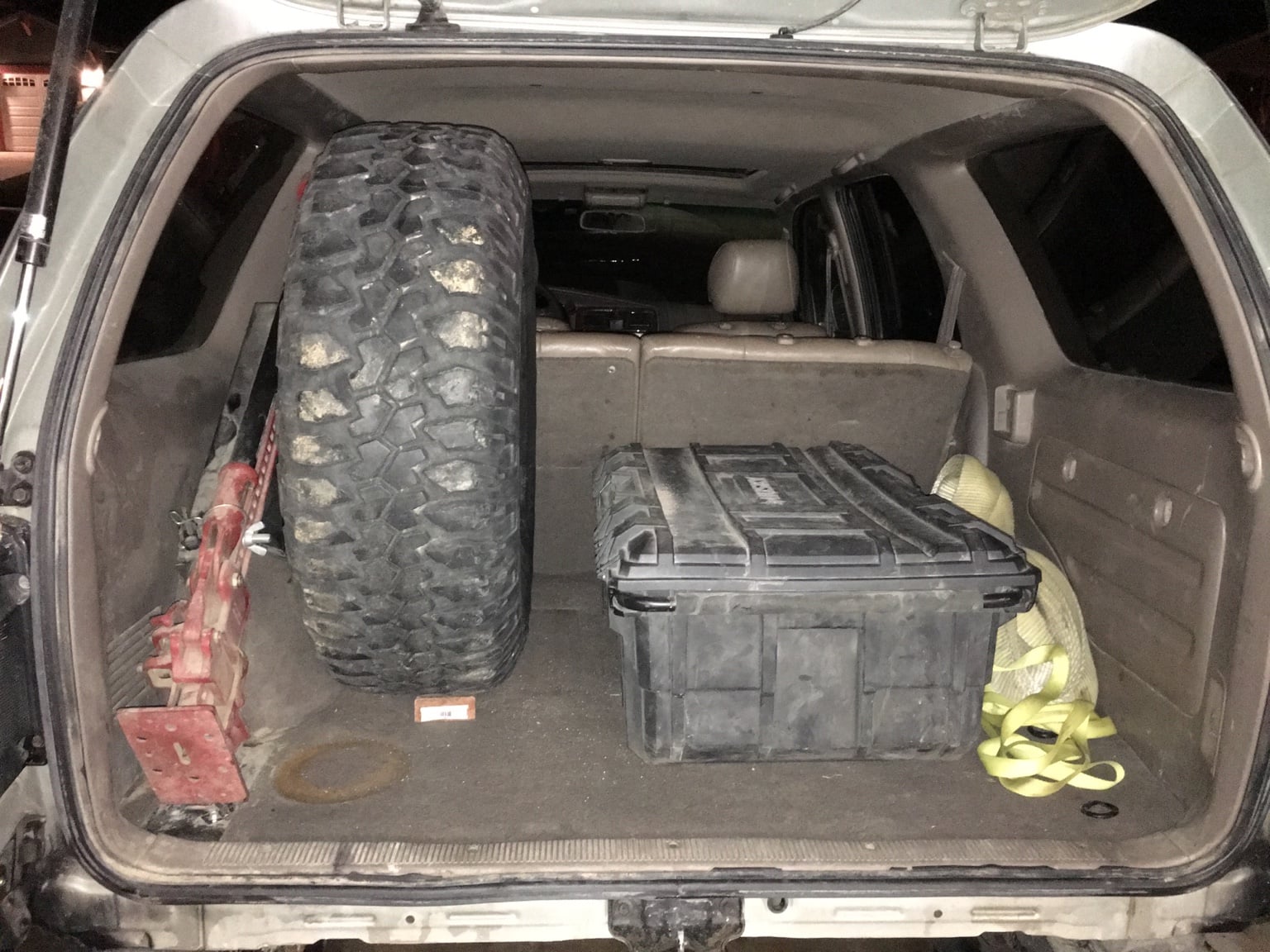

Picked up a pair of stock 5 star wheels with some Maxxis Bighorns mounted already with probably a little over 50% tread left. I've been needing a spare rim and the guy I bought them from would only sell both instead of individually. I might just keep both just to have extra spares. I'm debating whether to mount the spare onto my hi-lift mount or build a swing out tire carrier. I would like to have it mounted inside to keep the COG as low and centered as possible but not really liking the decrease in cargo space. One of the reasons I don't really like the bumper mounted tire carrier is I don't want to constantly get hung up on it if I mount it low but I also don't want to raise the COG any more. I also don't like how the tire carriers move so much when going fast through the rough stuff. I might just mount it inside for now an if I don't like it, I'll just build a swing out tire carrier for my bumper.
I also finished welding my bumper. It's been almost finished for over a month now but just haven't had time to finish it. All I need to do now is paint.
