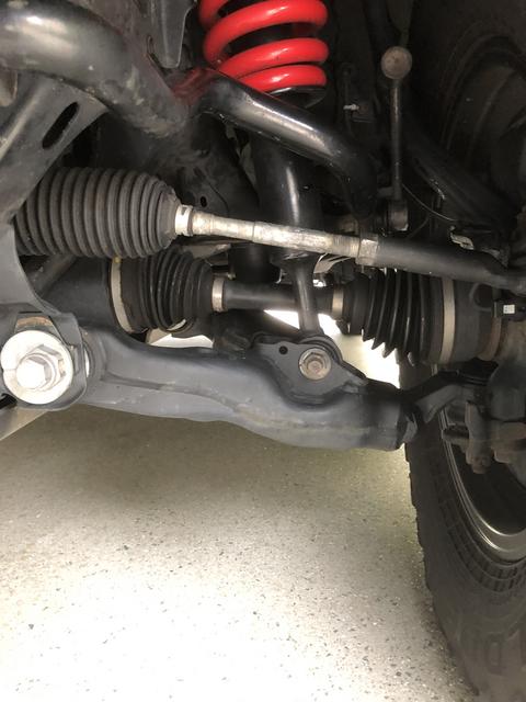

That is what I thought re. the longer axle length... thank you for confirming it. Does this look like an extreme angle?

I'd say yes its not ideal.
Mine at 3". No diff drop. This is the most I personally would go.

It does seem excessive from pic. I will post what mine looks like with 3” lift (might be little more......long story...smh) plus diff drop for comparison in morning. I forgot to take pic tonight. Little curious what your boots look like when full steering lock is added into the the picture.
I would suggest installing a diff drop kit. Cheapest option and easy to install. It will help. Next cheapest option will be to reduce the lift....new springs And/or shocks as from your pic you achieved lift with springs and/or shocks. And even then could still consider diff drop kit.
Edit.....here is mine
