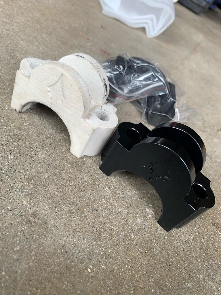

Edit. Got first batch in.
I don’t offer a spacer for the front because it’s not needed. You don’t want to lower that sway bar to try to correct a lean with a spacer. The front piston is still in the Oem location even with a lift. What’s the issue is the bushing at full droop is binding ( even at ride height depending on how much you have your pre load adjuster adjusted ) preventing a little more droop.

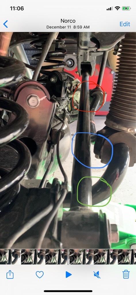

Yes the hard link on the passenger side was the first main issue for not allowing for droop.
Icon made a bar that has a bend to clear that. But then once you clear that to gain more droop it will hand up on the driver side. This piece I made fixes all that and you don’t need a bend in a track bar let alone a after market track bar.
First part is the red circle. Icon track bar( or has a bend to clear the first ( red circle ) hang up. After that clearance is done. It will allow for more droop. Next spot it will hand up is blue circle but that’s and easy fix by replacing that bolt to a button head style so it will clear as it radius’s up. Then it will hang up on the green circle area.

In short. If you have kdss 4Runner and lift it and have longer travel then stock shocks. The sway bar and track bar make contact and doesn’t allow for full droop of the rear axle.
Icon made a bent track bar to get around the first hang up but didn’t do anything else. So it will hand up on the axle side. Sonoran steel track bar is a track bar that zig zags around all those clearance to make it work but the tolerances are too tight for me. Axle must be in stock location ( front to back ) or things will crash into each other. My links are extended 1/8” back to center the axle front to back because when you lift it on the rear and don’t extended it then your axle will be more forward then centered.

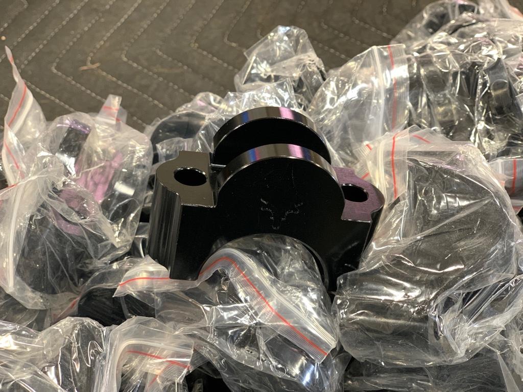

I will have enough for 100 trucks In about 30 days. They will be 6061 t6 billet smooth glossy black powder coated. And I will have some raw version as well and might play around with some anodizing.
