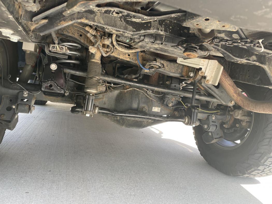

I had a local shop install the Treaty Oak "GX460/5th Gen 4Runner EIMKEITH PCK Package" today. I only have 40-50 miles on it, but it drives much nicer. After adding a dual swing out rear bumper, I added the heaviest Eibach Load-Leveling springs, and now this....feels great on pavement/not offroad with it yet.
Notable weight/mods:
BFG K02 285/70/17
SSO slimline front bumper/winch
Dual batts
Coastal Offroad dual swing out rear bumper
Toytec Lift, SPC UCA (older gen kit)
Full RCI skids/sliders (aluminum where offered)
Front Runner full rack
Best,
Michael
