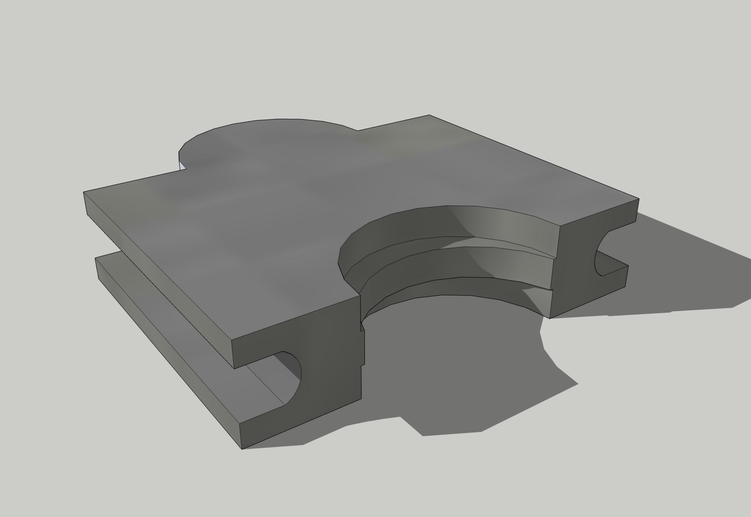

No one has really produced them for sale in a meaningful way before this because it's a small market. I think it's great that someone did it. I think the biggest hurdle is probably just whether it's worth doing and the risk that you won't sell very many.
I'd have them cast because it'd be a lot cheaper to manufacture and they're not high precision parts. It's just a block of aluminum that needs to key into the upper bracket and fit the rubber bushing.
Here's a 5 minute drawing of how you might make it so you could sand cast it with minimal or no machining. Not to scale or anything. Just a very rough picture to describe how you could do the bolt pathway that could be cast with the least effort.
