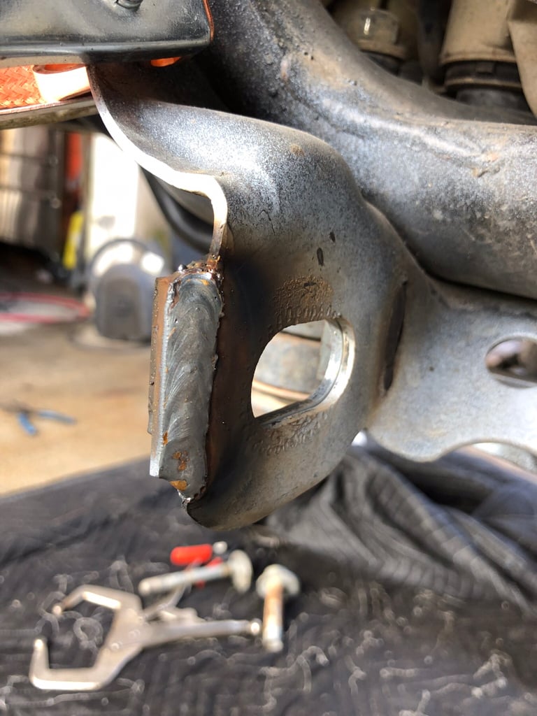

x2 nice welds.
did you pre heat the spindles before welding the gusset? they're cast right? just wondering since people seem to shy away from welding to cast.
Thank you.
No, I didn’t preheat. They should be forged steel and actually pretty easy to weld, you just need to control your heat to prevent warping. I think people associate any “cast” part with the qualities of cast iron, which is pretty tricky and requires a lot pre and post heating with very slow cooling to prevent cracking. I’ll weld anything I can get my hands on, but I’m no expert by any stretch.

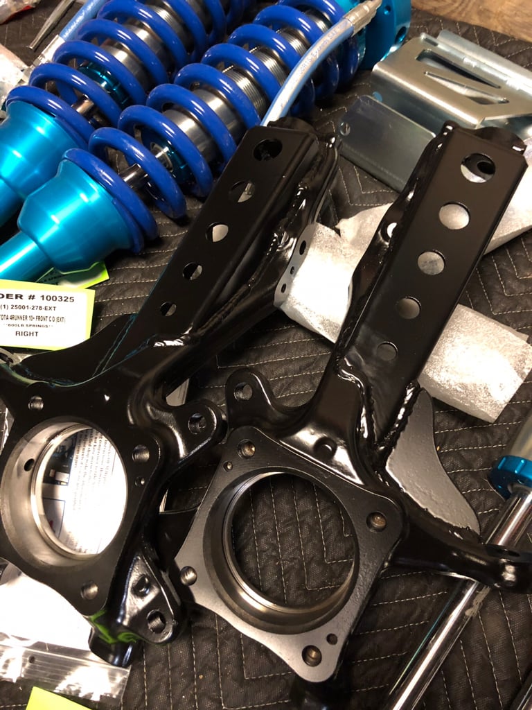

- Allpro spindle gussets (I fabbed and added the steering arm gusset)

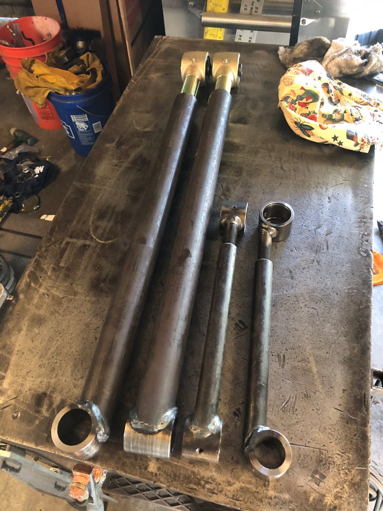

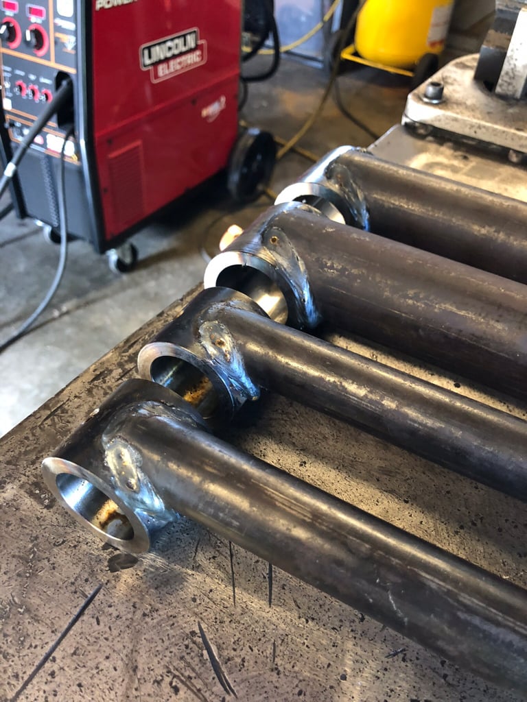

Part of this project is going to be building my own rear links. It isn’t really about saving money, parts and steel are spendy. It’s about building my own stuff. Here’s what I have so far: I used bushings and Johnny Joints for both the upper and lowers. The lower link is 1.75 x .375 wall... really heavy tubing. I’m tapping the joint end @ 1.25 - 12tpi. For the uppers, I used 1.0 x .250 and I off-set both ends. At the joint end, I used a builder Johnny Joint and welded a weldable stud that is made for doing exactly this (no, it’s not a bolt). Once the tubes are back for being tapped, I’ll post better pics.
The panhard bar is pretty standard 1.25 x .120 with some heims.

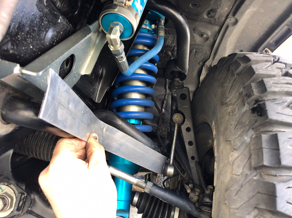

Like I said earlier, I got up this morning to rip into the truck. As luck would have it, rain was in for forecast. So, being in a bit of a hurry, I didn’t get a before pic of the old suspension. I’m pretty sure that you could use your imagination and one of the million pics on here of an old, Icon stage 2. What I do have is my spindle gussets.

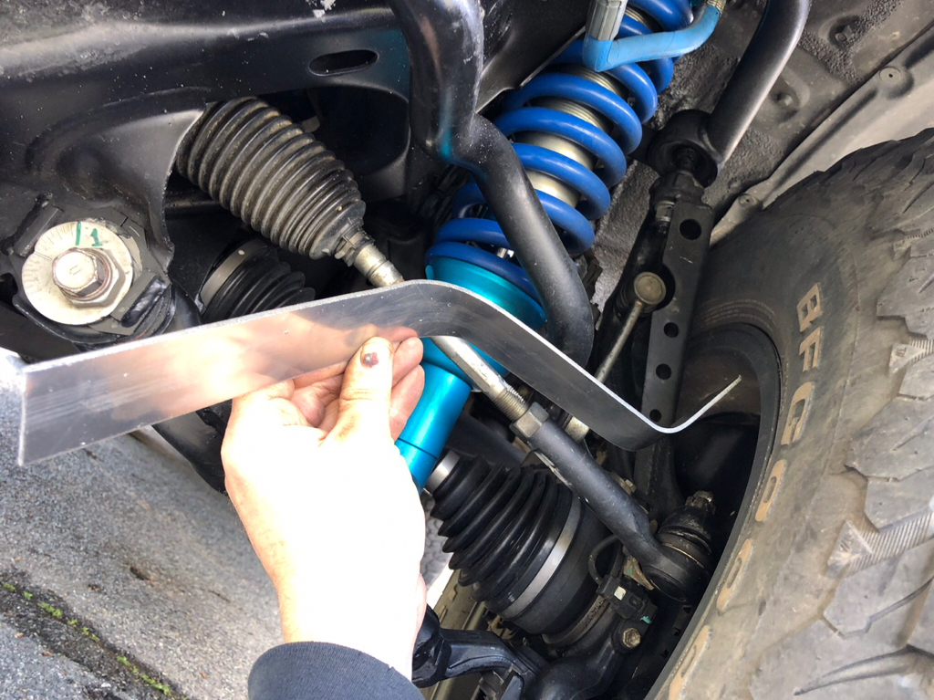

I decided that while I was at it, I’d fab a small gusset for the steering arms as well.

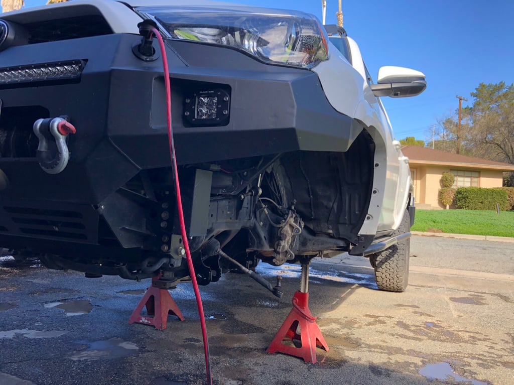

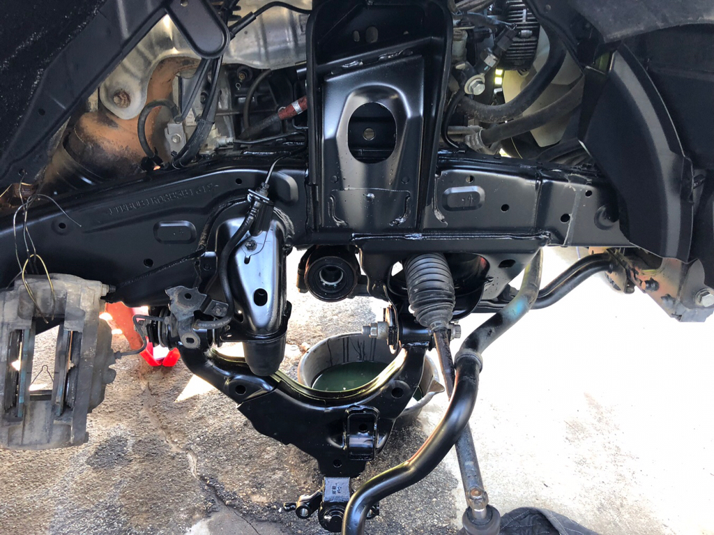

I got a little bit done today, but not as much as I’d have liked. Gods honest truth, I’m spoiled and I don’t like working in the rain anymore. But, progress is progress.

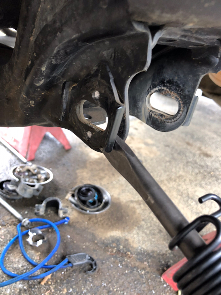

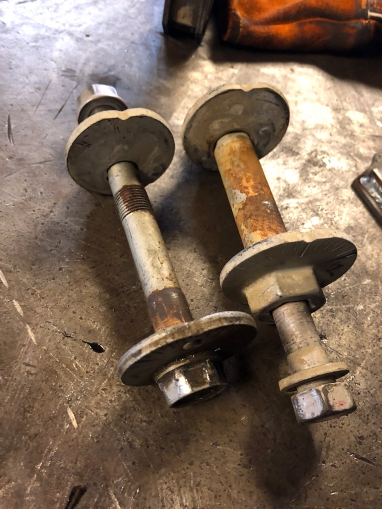

I was able to remove the LCA’s between sprinkles. I come from a solid axle world, so this isn’t really something I’ve done a lot, especially on a Toyota 4Runner. I hit the first cam bolt without issue. It’s a bolt, with the nut incorporated into the rear cam. Looking at the condition of that one and I knew that the rest were going to be cake. Moving to the rear bolt, I put the impact on the head, thinking that it was going to be the same configuration... no joy. “No worries, I’ll just grab the BIG impact”, which immediately rounded the head of the bolt. Now, understand that there was a time in my life where I fed my family turning a wrench. I used that experience, along with the immediate feeling of shame, to deduce that I was doing it wrong. Turns out that the rear is not like the front and it’s most likely done this way to facilitate removal with the axle being in. Lesson learned.
Anyone have a suggestion on a good brand of cam bolt? Factory, Moog, ?

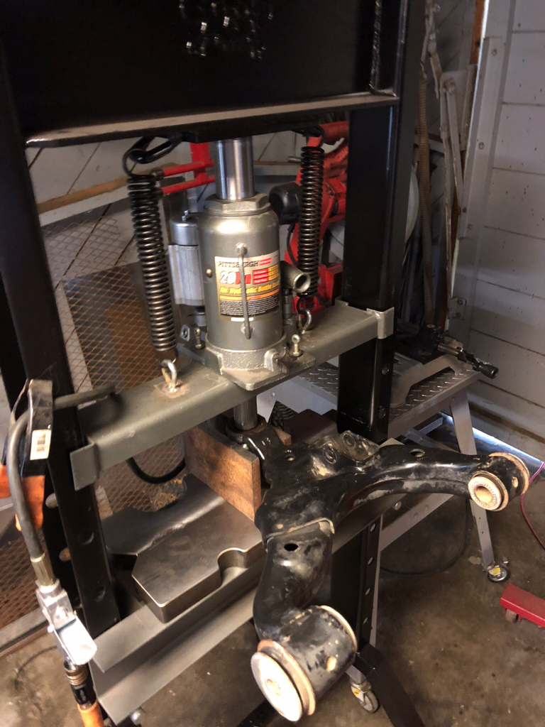

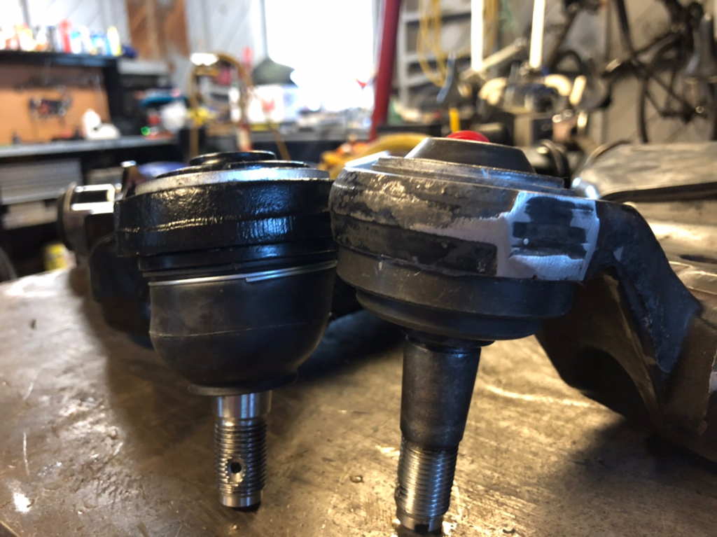

Next, I moved on to pressing the ball joints out. I honestly thought it was going to be a little more easy going than it was. It’s not that I don’t have tooling or the knowledge to do it, but there really isn’t a lot of meat around the ball joint to catch hold of anything. The first one went with just a little heat and a very jenkey setup of stacked steel. There’s really something to be said about putting several thousand tons of pressure on a stack of potential projectiles, aimed directly at your nether region.

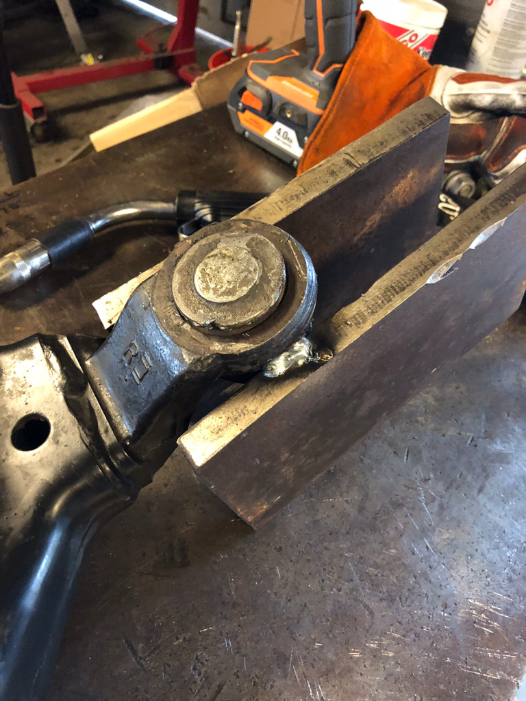

The second arm didn’t go willingly. After screwing with it for a bit, I decided not to take anymore crap and just broke out the welder. If I’m going to keep these LCA’s, then there will be provisions welded to them for this.
The bushings on the LCA’s do not look bad at all. But, while I’m in there, I’d love to change them and I’d prefer a better option than OEM. As far as I know, no one makes a poly bushing for these yet, am I right on this. I’d honestly love any suggestions.

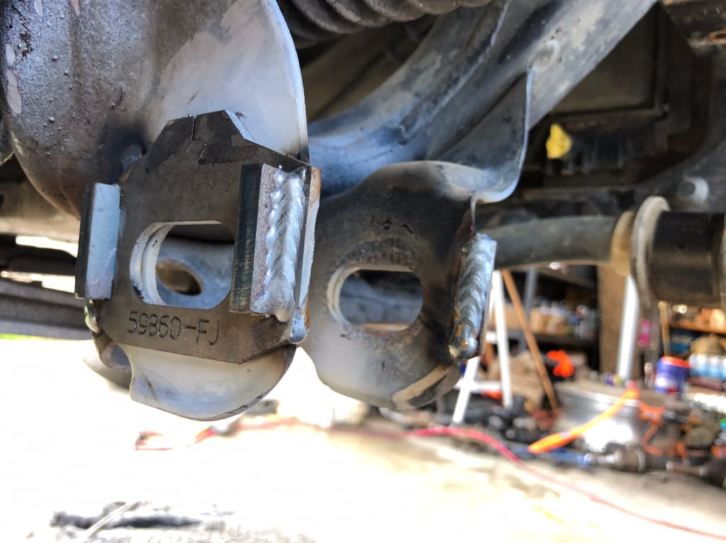

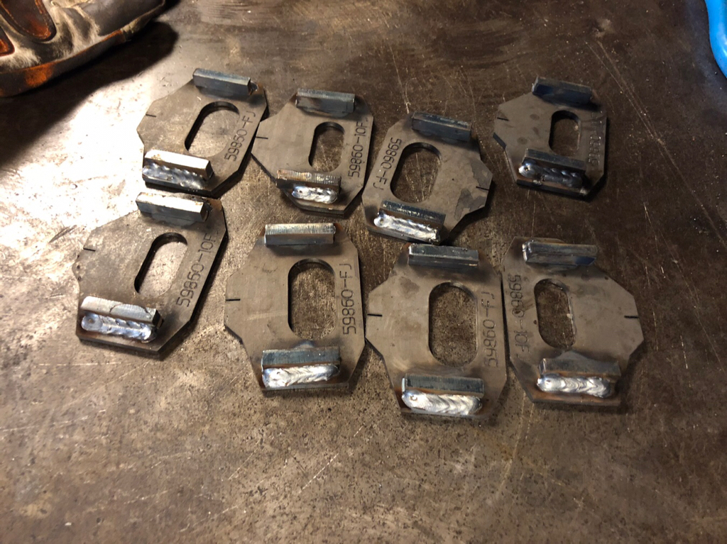

With the cam bolts out I welded up the tabs on the TC cam gussets. They all fit nicely, without any messing around.

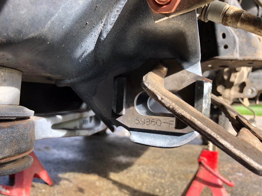

At this point I was trying to make the most of this rainy day. So, I figured I’d see how removing the OEM gussets was going to go. I was originally going to use the plasma cutter to gouge the spot welds. But, what’s on there is really, really thin. About 30 seconds with a drill and I was able to beat them off. Wait... never Mind. All-in-all it took maybe 10 minutes.
I really wanted to get them on, but lying in standing water while welding isn’t happening.
Other's can clarify if I am wrong, but I think the ball joint in the LCA's is not serviceable...meaning trying to find a OEM replacement or aftermarket joint that fits is going to be difficult. Seems like most just replace the whole LCA if they have a damaged joint.

I’m slowly finding this out. It’s weird, because they sell a replacement ball joint. My was all that bad, I just figured I’d do it all while I was in there. Since I’ve done all that, and while waiting for the new ball joint to show up, I’ve found quite a few write ups on it. Hindsight is most definitely 20/20. I’m going to see if it will work...

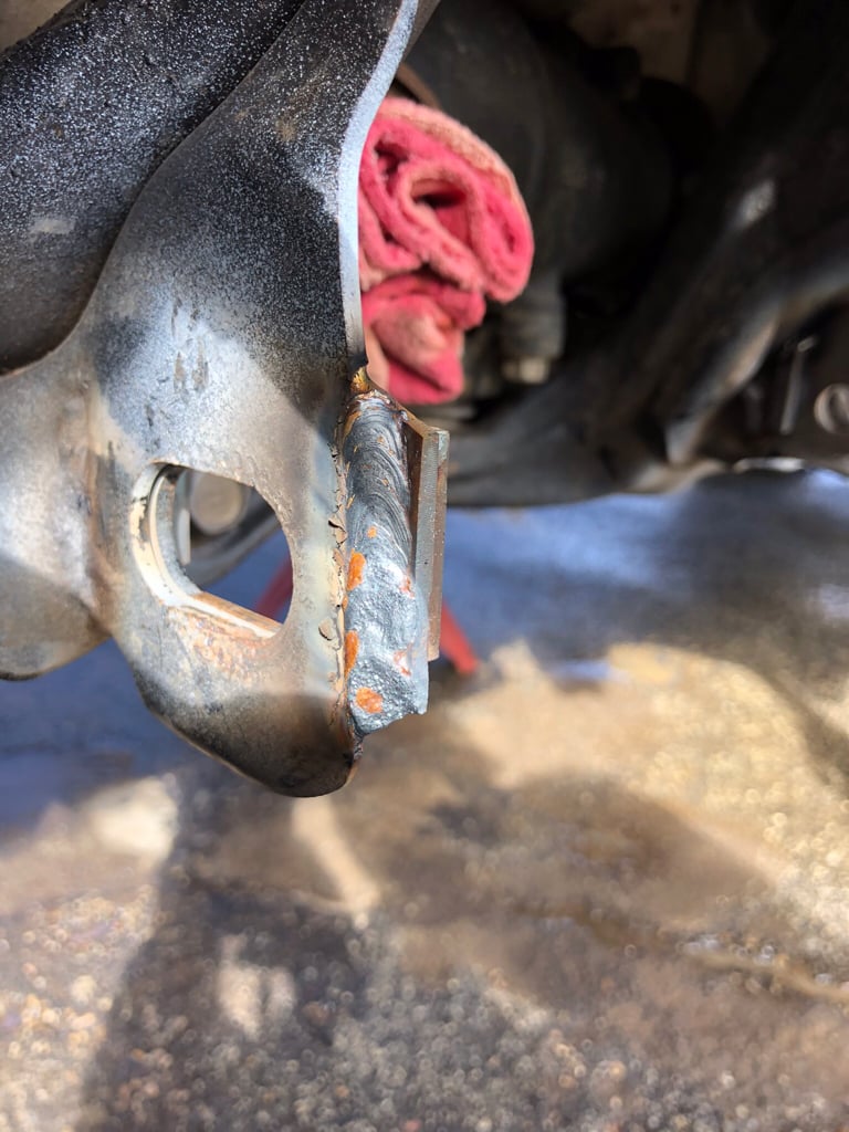

Alright, a Saturday with a break in the rain! I got the ground dried up enough to make lying on the ground a little more fun.
These took very little fitting and took little time to weld up. In fact, the wind is what took so long. I had to time my beads between gusts. Besides that, and not being very good at out of position welding, it wasn’t that bad.
Here’s a bead that didn’t get enough gas. It’s not bad enough to gouge out and redo, but you can see the effect of wind.
A bead at the front and back is all I did.

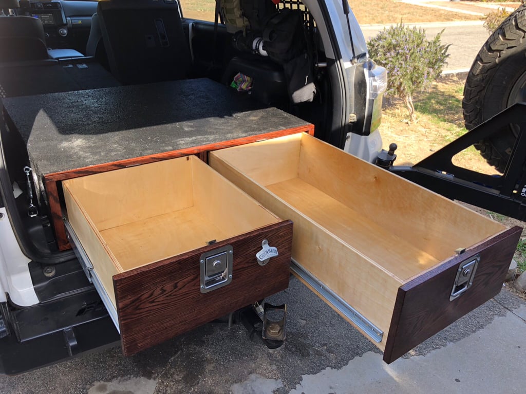

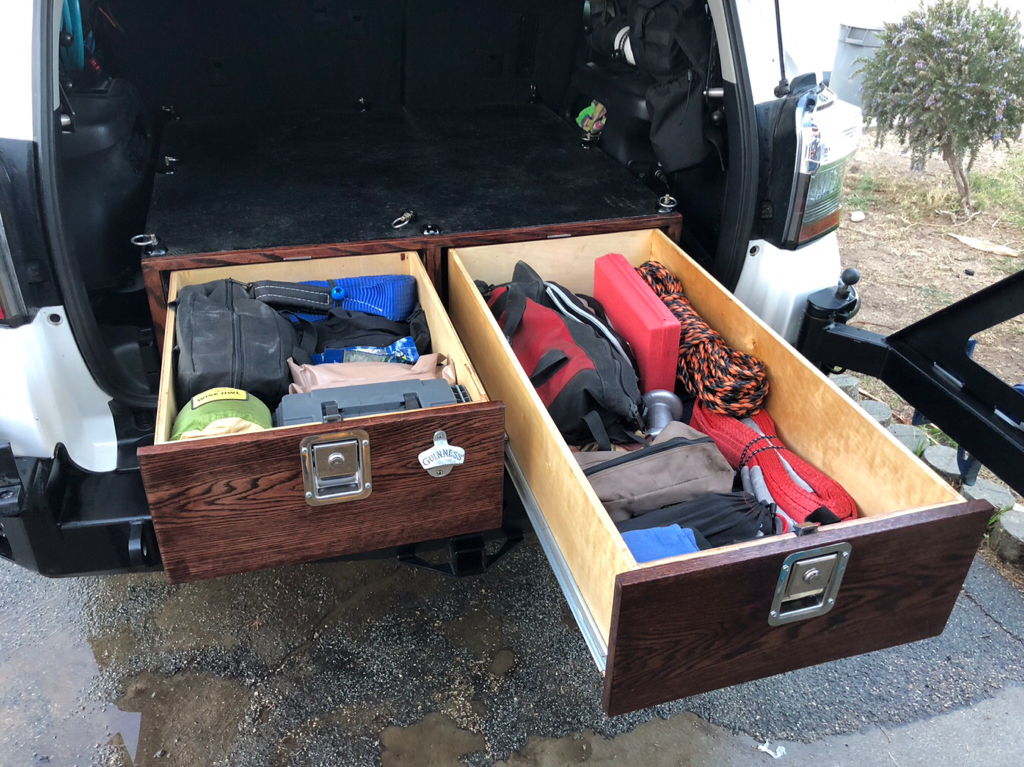

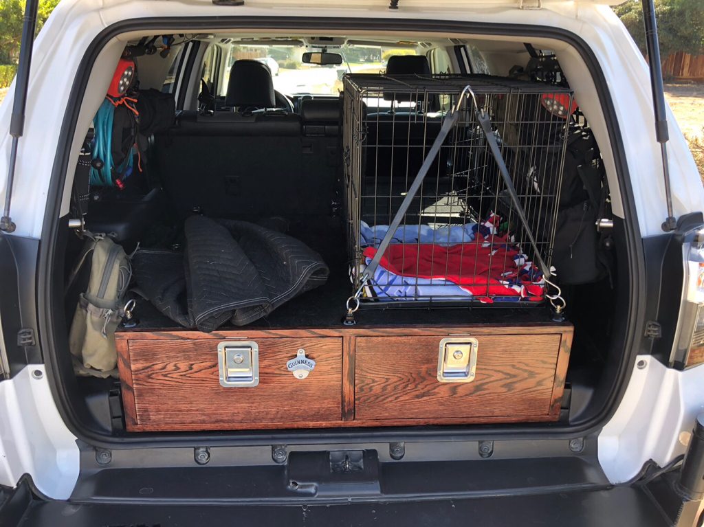

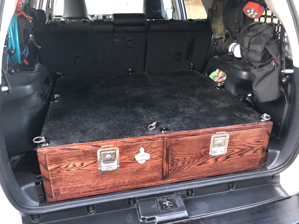

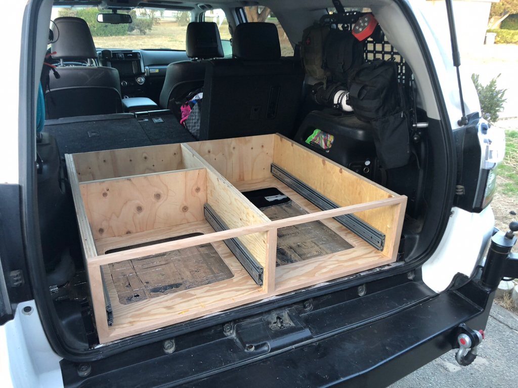

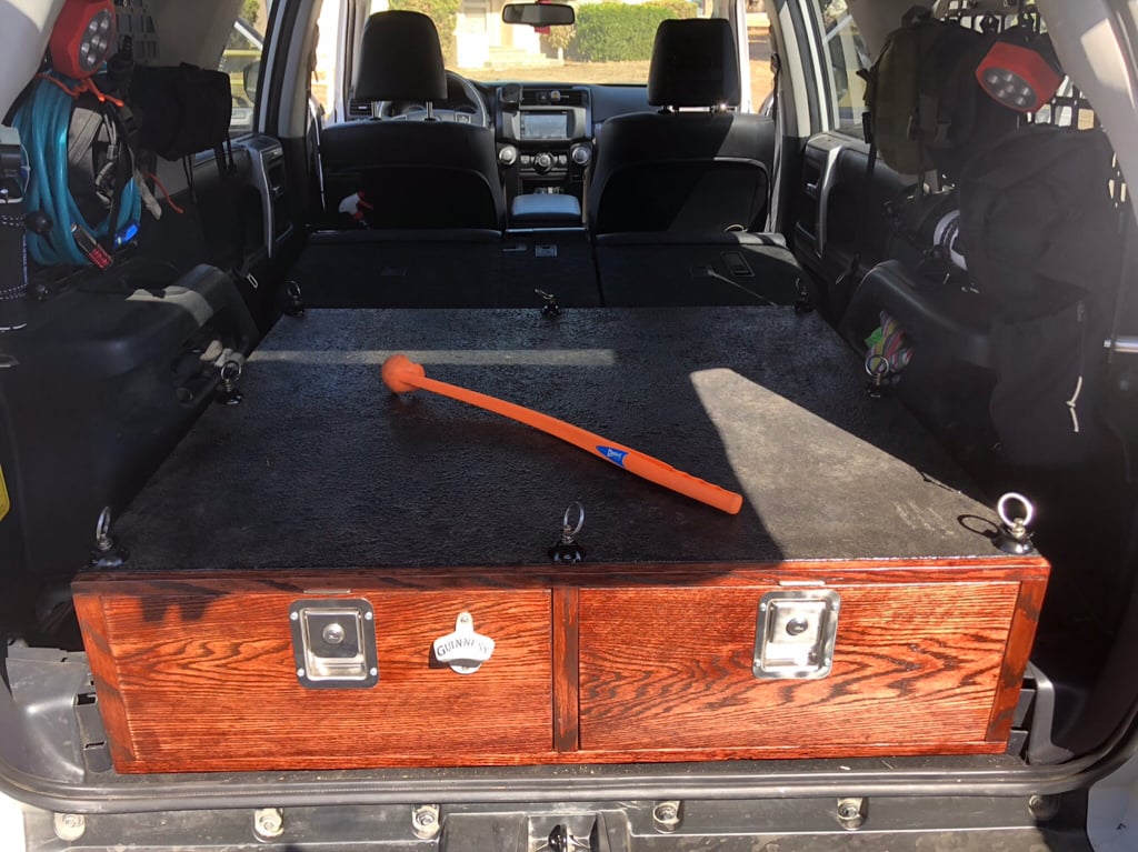

A few months ago, I was able to finish my cargo drawers. Another project that took me far too long. I don’t have a lot of pics of the actual build on this, because I had to have most of the box cut by a friend. It not that I can’t cut wood, I just don’t have the tools to do what I wanted to do. I figure I’d post this, not as a “how I built my drawers”, but just to show my subwoofer placement, that I’m kind of proud of. I started with a 3rd row SR5. I was going to trade out my 3rd row for 2nd row stuff, but the deal fell through and I decided to make it work.
The box is 11” x 42” x 37”. With the 2rd row, on a 3rd row 4Runner, the box is nearly level for a sleeping platform. It’s actually way better that a 2 row, 2nd row, IMO.

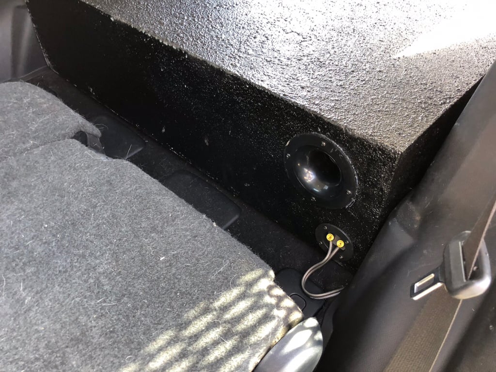

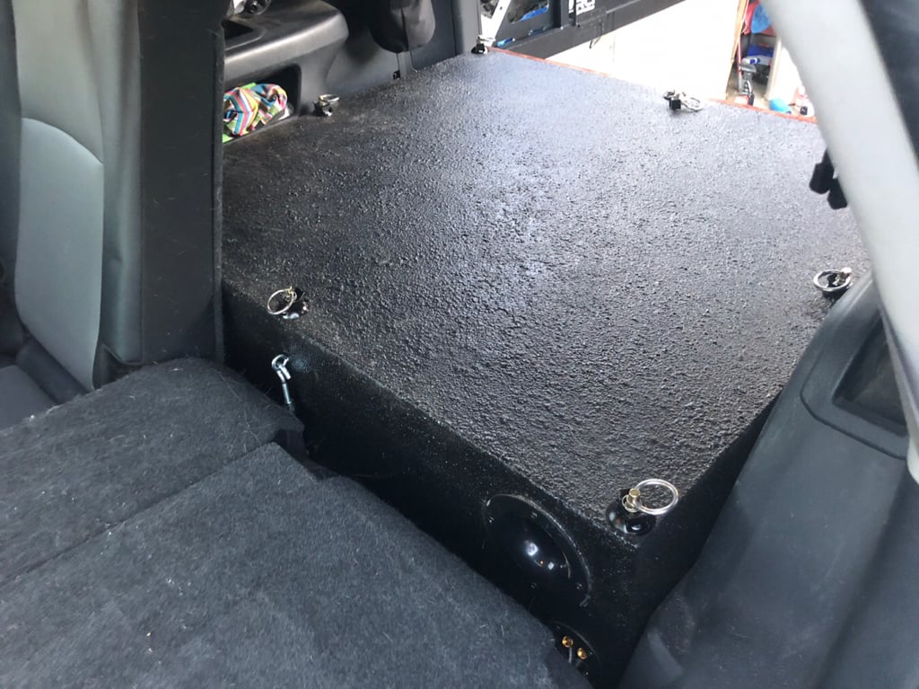

If you notice the box in the front, driver corner, that’s a 1.35 CI sob box. It houses a 10”, down firing sub. The sides are made from 1” ply. That’s way overkill and not in my plan. The person I had cut the wood, “did me a solid” by “hooking me up” with something that would hold a baby elephant. I ended up drilling 5” lightening holes to keep the weight down.
The right drawer is 36”, the left is 22”. I used 500# drawer slides, because I’d seen them used a lot in drawer builds. If you happen to be reading this and think, “ya, 500# drawer slides!” Then I’d like to tell you that they are stupid heavy and way overkill, IMO. Half that would have worked. I faced the front in oak and coated the body with Herculiner.
Here is the subwoofer port. I really wish I had better detail pics of this. I get impatient during a build and don’t stop to take pics. I typically regret it later.
I added turnbuckles to hold it down and aircraft style tie-downs. So far, I love this thing. No more loose crap stuffed everywhere and I have a great sleep platform and a hidden sub.

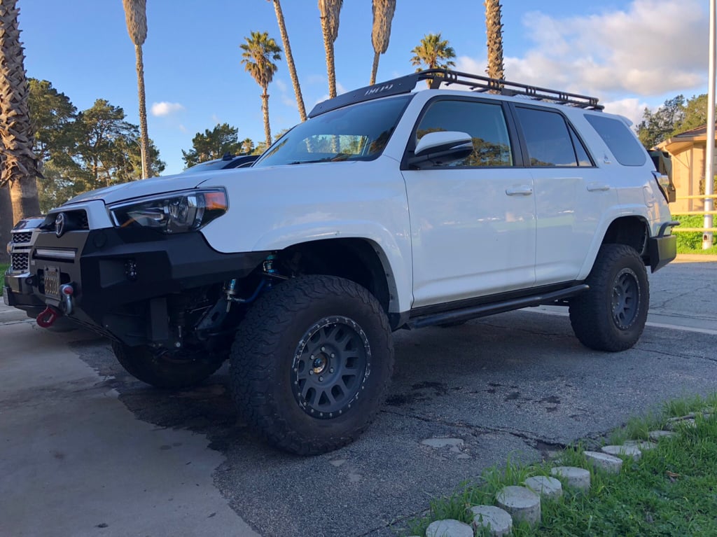

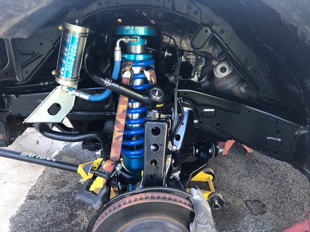

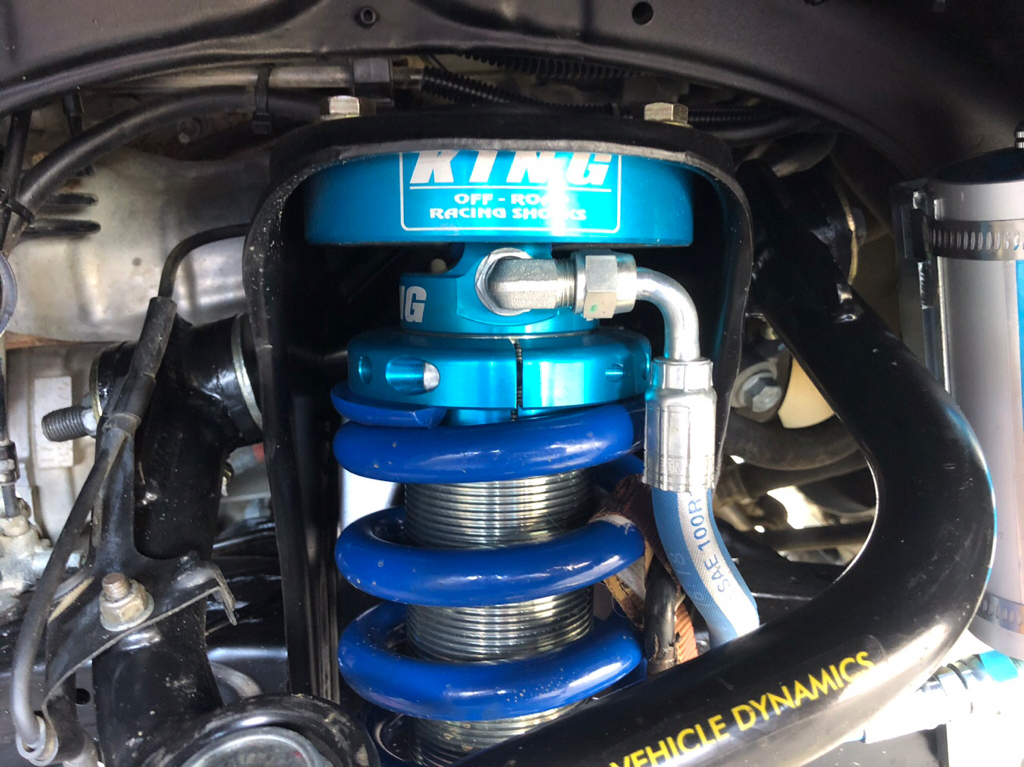

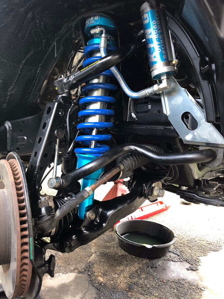

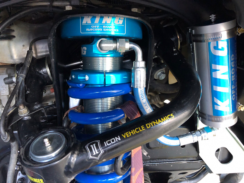

With some good weather and a nice, leisurely 3 day weekend, I got plenty done. With everything pretty much prepped and ready, the front end went pretty quick. You can see the Duro bump stop in there.

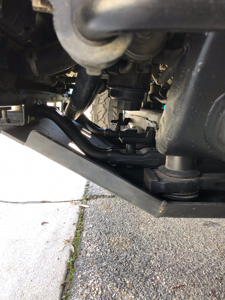

Installation has been covered many, many times in here. So, here’s the finished product. I kept the sway far, converted to Icon Delta joints and replaced pretty much everything. New Toyota CV axles as well. I destroyed one last year and had to replace it with an auto parts axle that is no where near as good. I’ll end up with one origin axle that will become my spare.

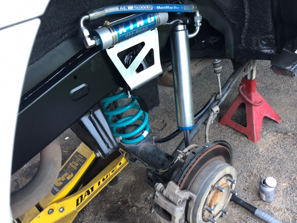

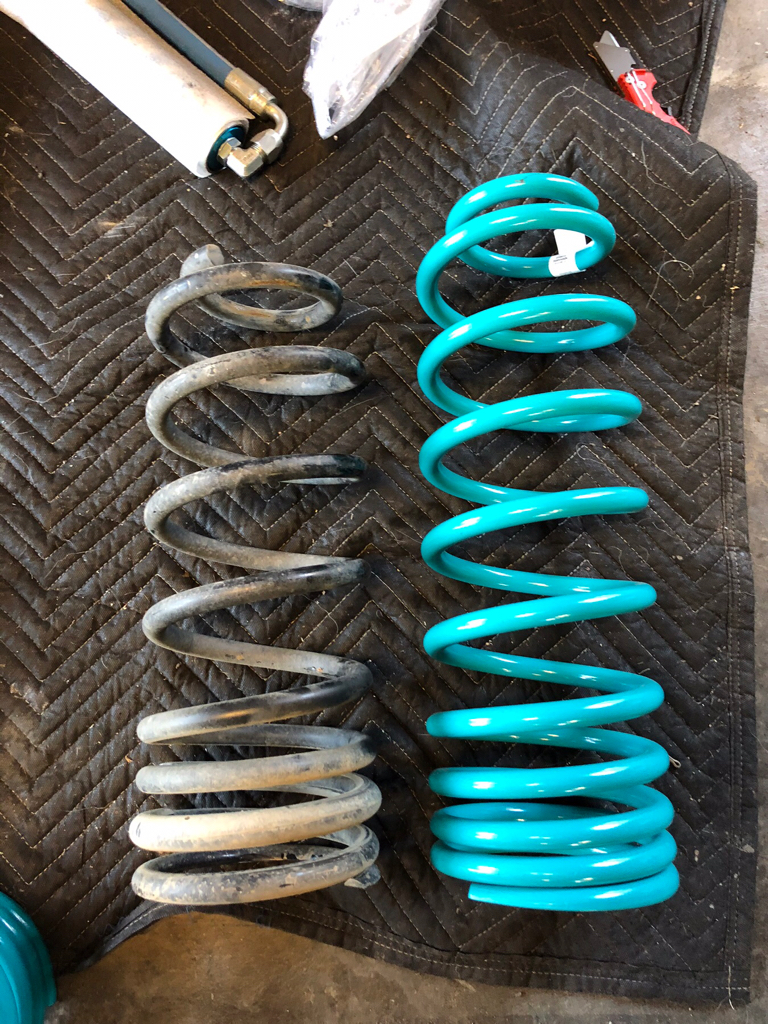

Moving on to the rear, I’d planned on having my links done. But, that didn’t work out. So, I went ahead and pulled the Icon overland springs and threw in the Dobinsons C59-701’s.
I say “threw in the Dobinsons...” like it was no big deal. Being truthful, by this time of the day I was freakin tired and starting to rush. If you look closely at the “plastics guy” duro bump stop, you’ll see that the rear bolt is completely exposed. That’s because when I tightened it, it exploded. Like I said, when I rush I break stuff, it’s just the way it is. On the other side of the truck, I had the power of hindsight. While I was tightening that one, I could almost hear it start to crack. I liked these while they were in a pile of new parts, but now I’m not so sure. Most bumps will have some steel around the mounting points, but these are all plastic. There will be more on this later, for sure.
With it finally on all fours, with 600# springs at zero preload, it sat pretty low in the front, especially with the new rear springs. I knew that the front was going to be low no matter what, so I desired to Get them a little closer before my first alignment.
I’m used to Icon coilovers and have always adjusted them on the truck. I was afraid that I was going to have to remove these, based on what I’ve read. With them on the truck, you can’t really get spring compressors in there, so I used ratchet straps to the LCA. That worked great and was actually a piece of cake.
Measuring from the fender to the hub center, I started with about 21 1/2” (Left) and 21 3/4” (right). I put 8 turns on the left and 7 on the right for about 23.5 “.
Ben, at Filthy Motorsports, who has been awesome to work with, suggested that the max measurement should be 22.5, for best ride quality. I know I’m over that, so I’m debating on taking a few turns out or just leaving it to see how it settles. I know that I’m going to be a bit high In the rear with those springs without full weight in it. Any suggestions form anyone running a similar setup would be greatly appreciated.
It sits much better now. At this point, I’m dangerously close to being ready for a snow trip!

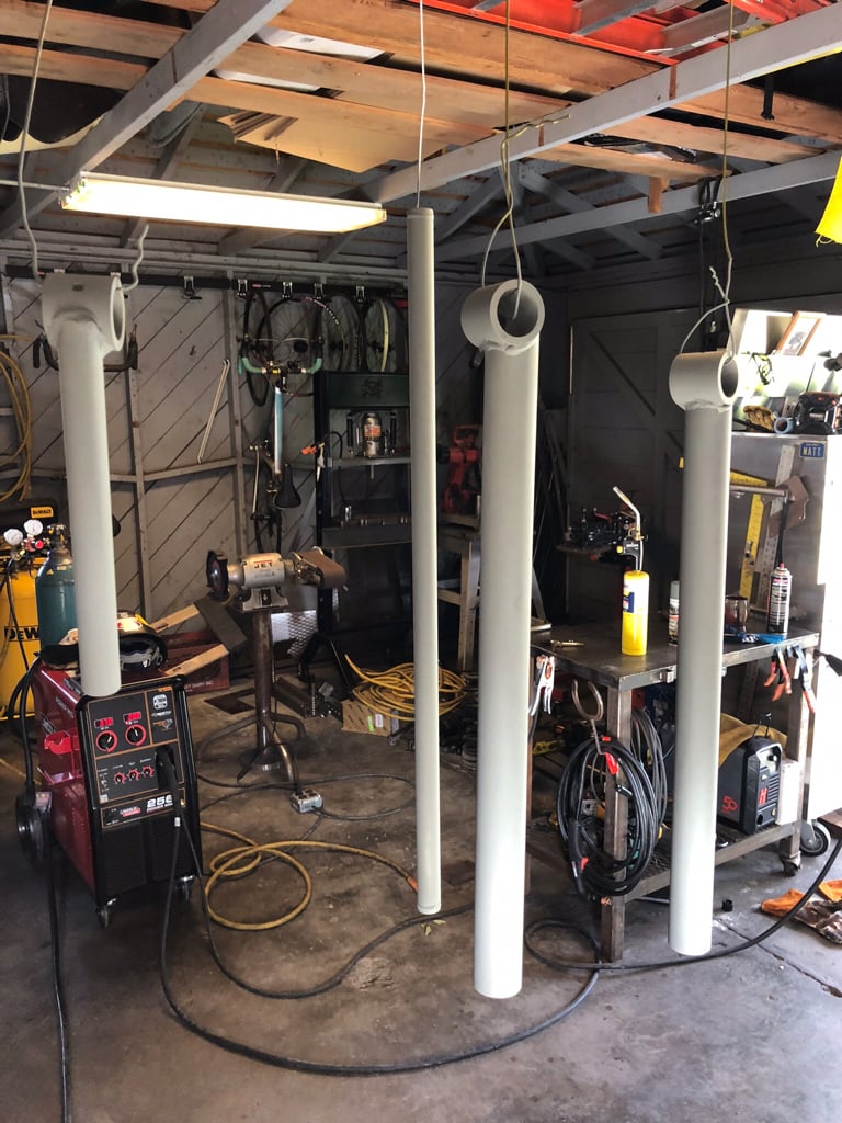

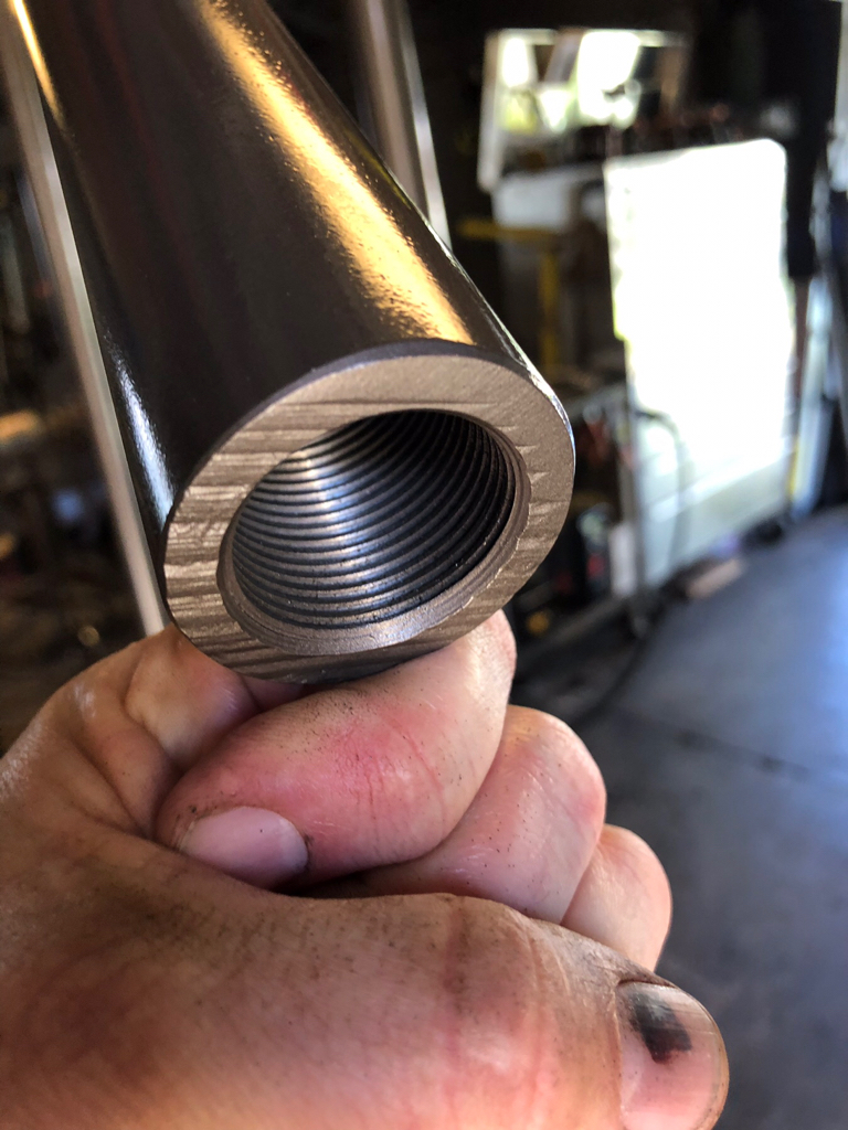

Making some progress on sorting out my suspension. I got my link tubes back from my buddy. He was able to thread them for the Johnny Joints. I love to have a lathe! #shopgoals. So, today I was able to get the bushings welded on and get a coat of paint on them, before i have to break away and go shopping...
These things are chunky!

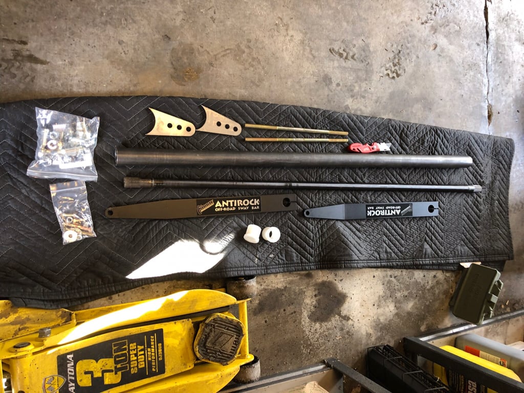

While I was painting, the FedEx guy showed up with another project to tackle. It’s a generic kit that I picked up from Summit. I have a general idea of where it’s going, but I think I’m going to wait until I ditch the CBI bumper, to do it the way that I want it. I was able to take a look at [MENTION=113049]rochmpr[/MENTION] ‘s 4x4Labs rear bumper, which is closer to what I’m looking for. The CBI has been fine, but I drag it on everything. If I’m being totally honest, the main reason I want to ditch it and build my own is, well... because I want to.
As if I didn’t have enough going on, and even before this sway bar arrived, I had a idea about how to use one in the front. Anyone ever seen one on a 4runner? Well, today the thought became a plan...
