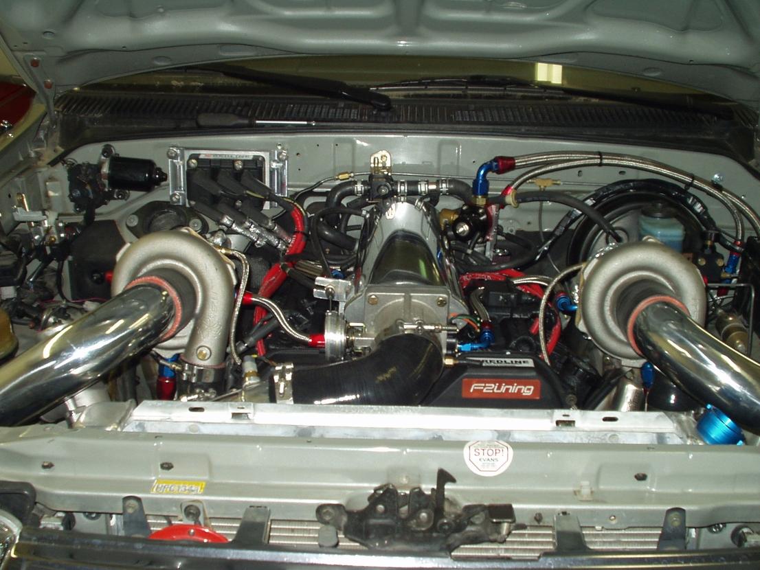

If you need tuning help I would talk gadget at urd. They made this sweet twin turbo 3vz motor in a 4runner. For tuning I think a map2 or a haltech unit would be best.

Also note that the stock engine can only handle so much boost. That URD twin turbo motor most liley had a bit of work done on the internals.

^your right. it used to be a race spec motor but they added a couple of snails and now has around 800+ hp. I'm sure LC engineering can build you a good foundation as far as internals and the turbo.
