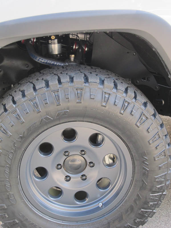

Showing them off based on above specs. which I ordered. With the ICON suspension and TC UCA's aligned to factory settings, and mounted with GoodYear 285/70/17 Duratrac's, these bolted right on (no spacers) and rubbed in front only on two places at full lock in reverse: 1) extended mud flap piece at rear of wheel well (pops off the bigger mud flap piece to solve rubbing), and 2) front inside of liner at front of wheel well (real minor - will figure out how to solve next weekend).
I opted for new TPMS sensors so the old, original wheels still have theirs; and bought the black chrome ET bolts from Wheeler Offroad along with spline socket.

Moving Chicane what brand are your black wheels?
My wheels ARE the American Racing ATX Mojave w/Teflon coating wheels as spec'd in my post above. I didn't care for either set of center caps provided by my guy, so I painted the center hub with some steel-gray automotive krylon spray paint (or similar).... I think I still have the can if you need me to look that up.
