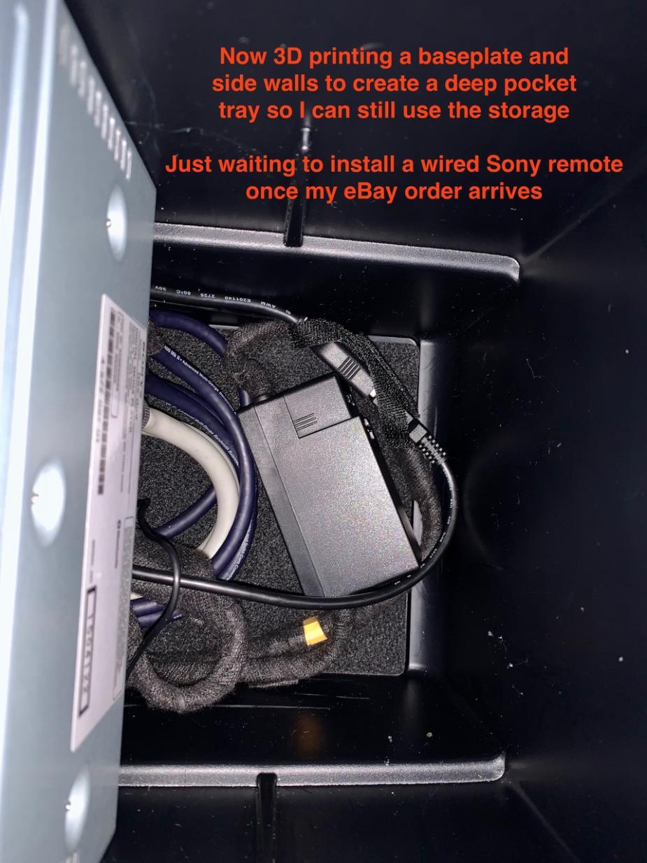

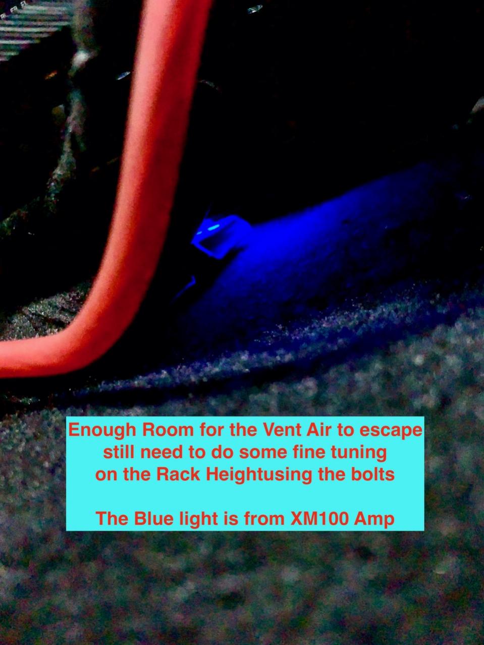

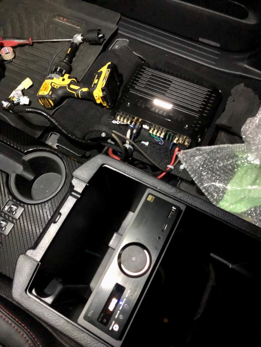

BTW I am open for ideas for where to mount the AMPS and any alternative location besides the centre console compartment for the GS9.
Maybe an amp rack from Taco Tunes. I bought it to mount my amps and HAM but haven't used it yet.

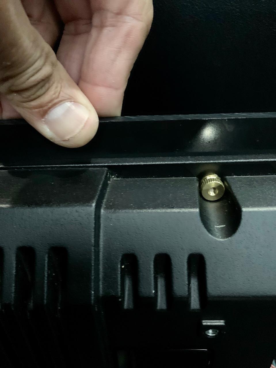

I also need recommendation for the sub enclosure if anyone knows any make then let know - i need at least 0.9 cubic ft volume. so far i narrowed down to Sound Ordnance Bass Bunker Sealed single 12" subwoofer enclosure (Model BB12-95S) from Crutchfield. Thanks much

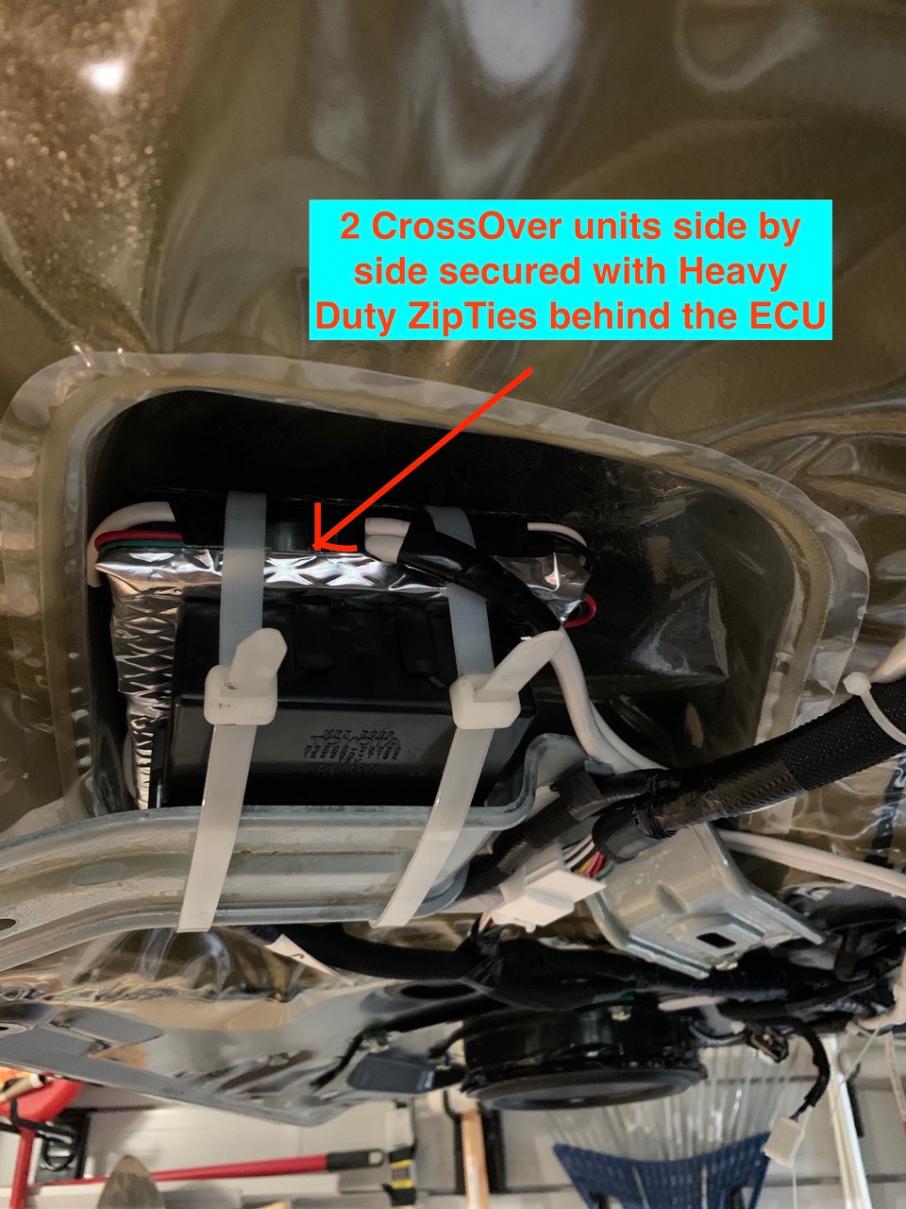

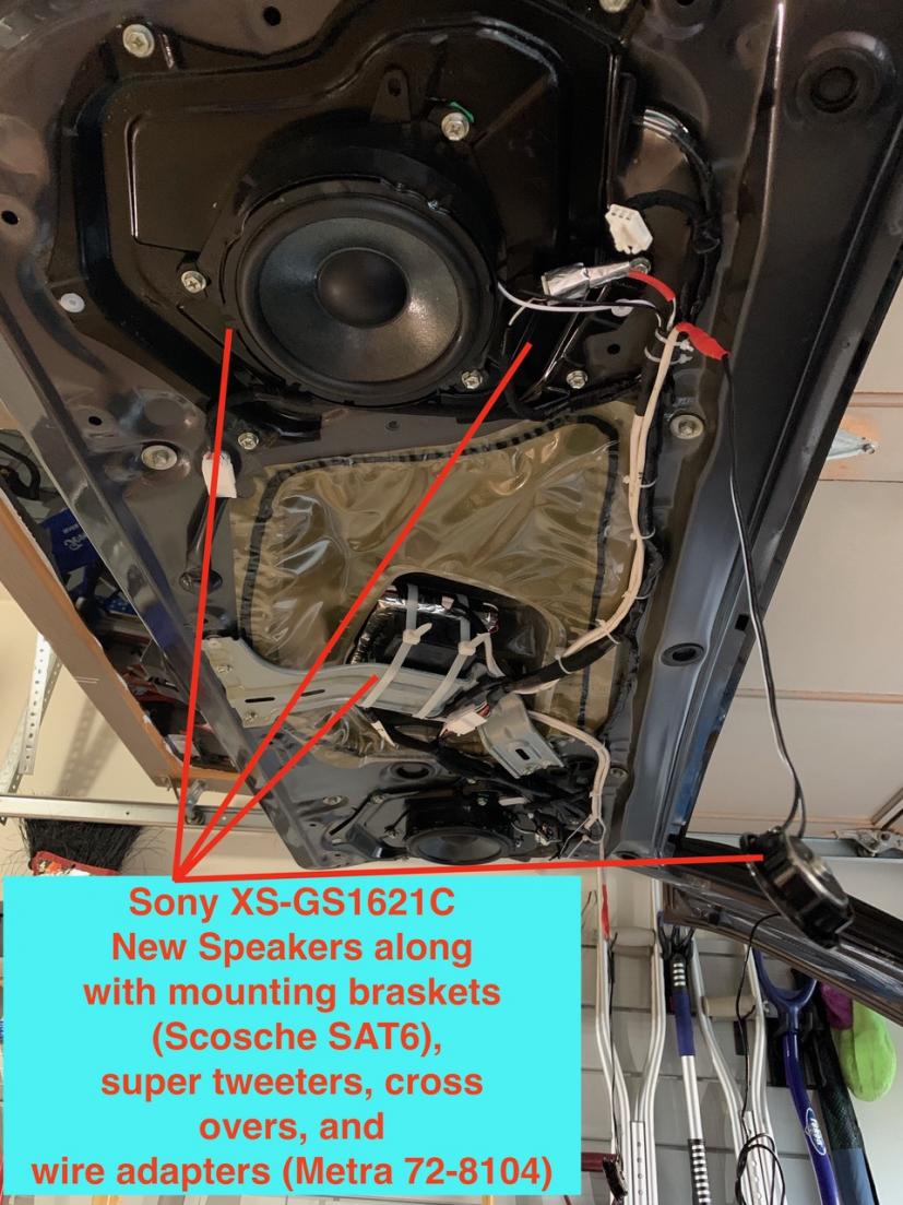

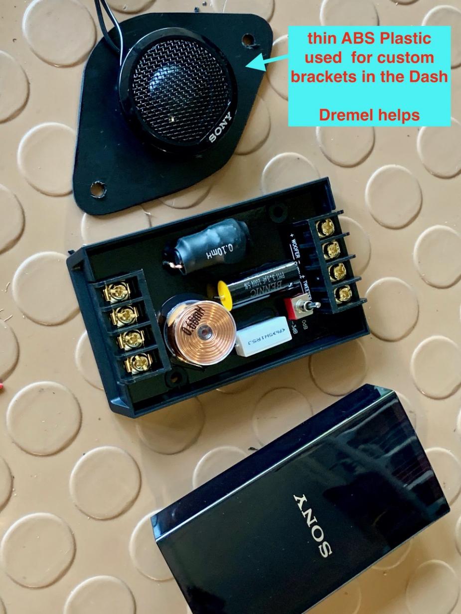

Im not sure of your system configuration, but if you are using passive crossovers with the mid and tweeter then you wont be able to properly align and EQ the drivers separately. This is only possible with an all active setup. Meaning each speaker has its own channel on the amp. Using passive crossovers severely limits actual tuning ability.
great point and thanks for the input.

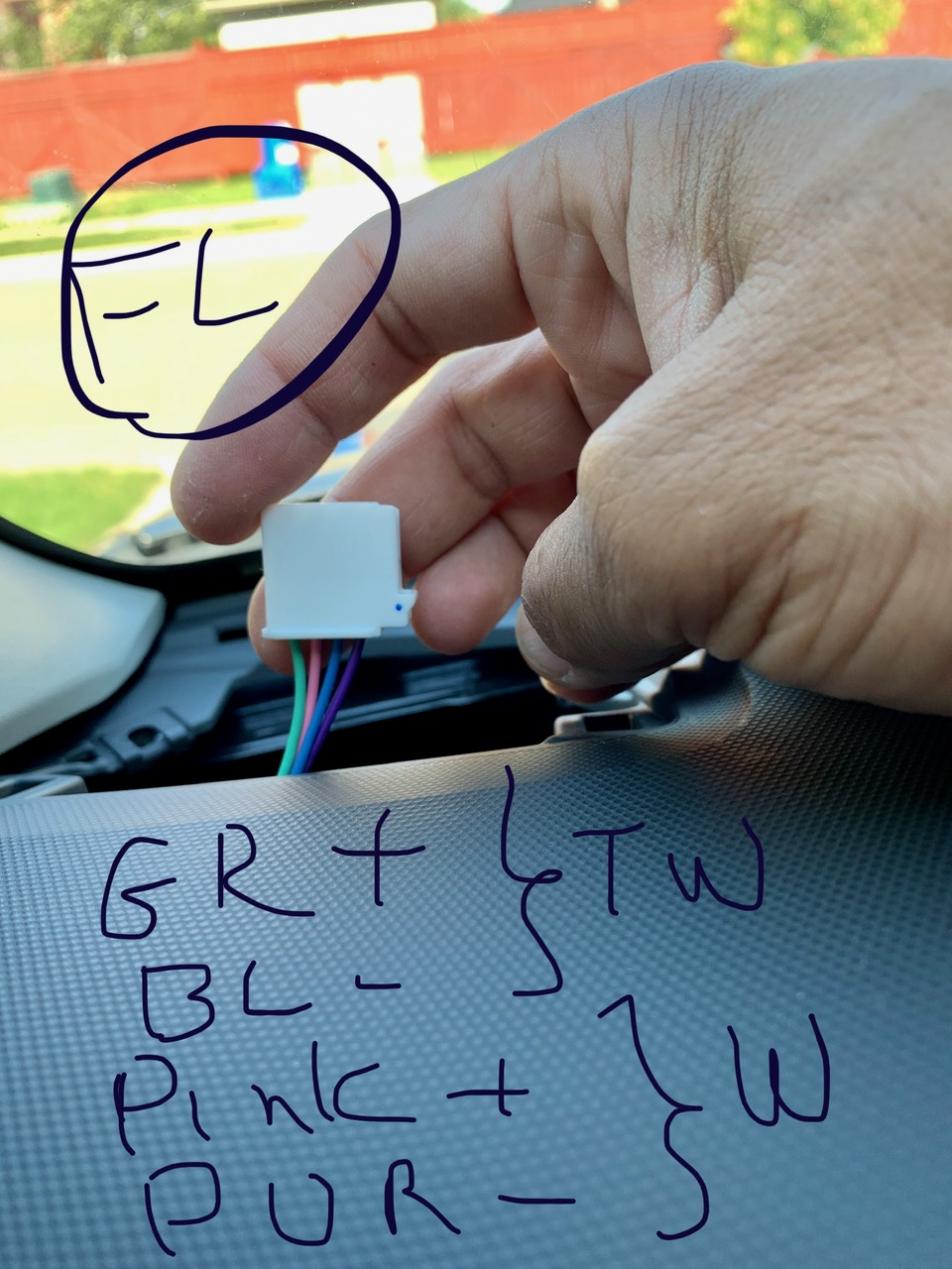

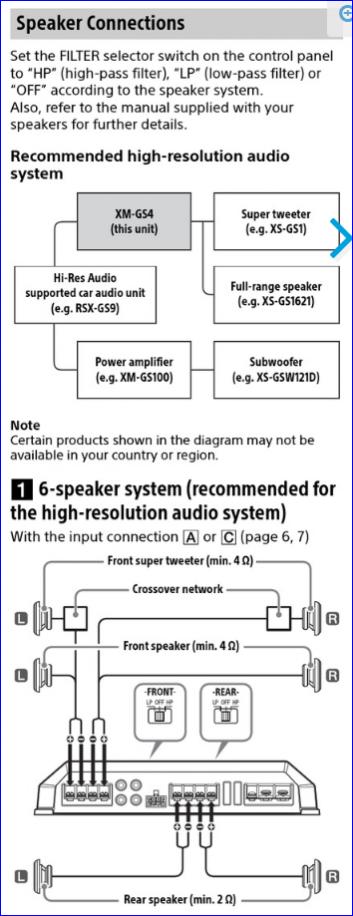

i am going with what Sony recommends from a components and connections point of view. Will be using passive cross overs however willing to draw two new wires just for the tweeters (killing the cross over module if its not optimal) to make a straight active connection. in comparison to the attached diagram, i will have identical setup for the front and the rear though. it will take me some trial-error to get everything optimally tuned. thx
Input Connections - Sony XM-GS4 Operating Instructions Manual [Page 6] | ManualsLib

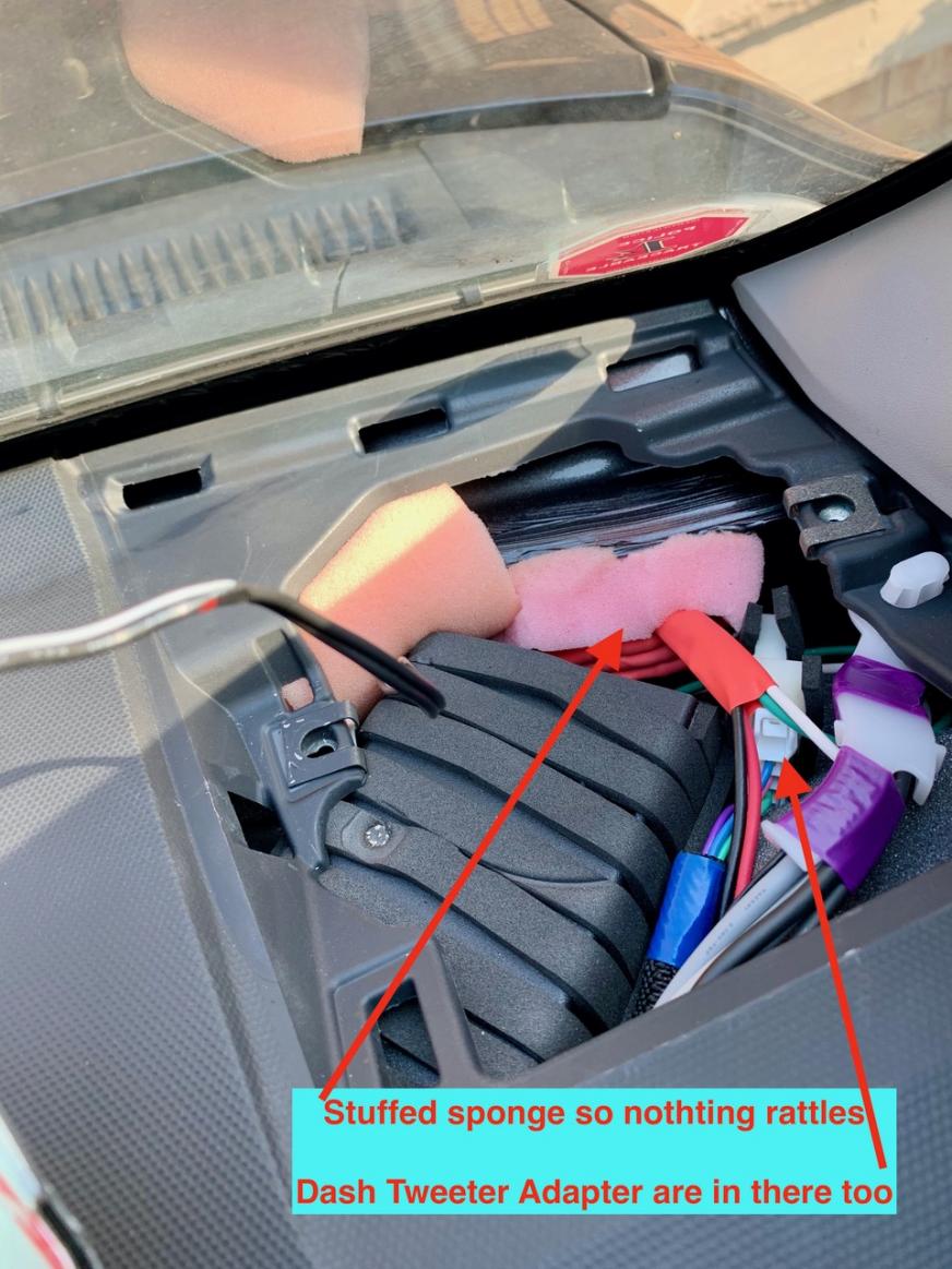

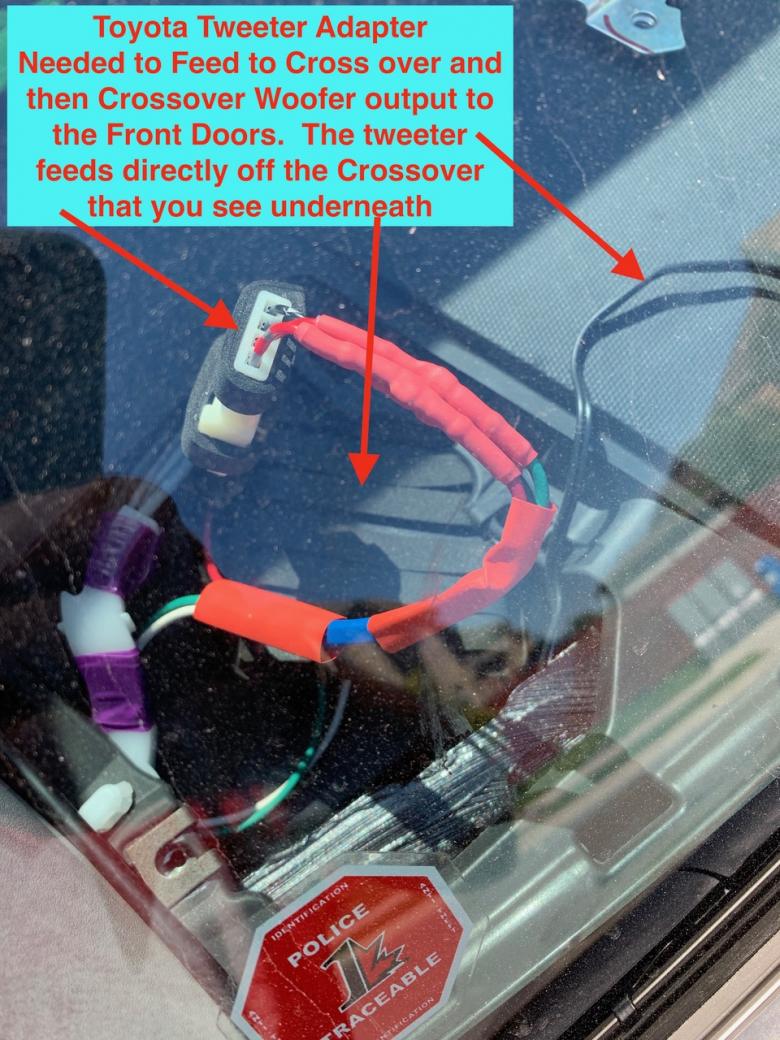

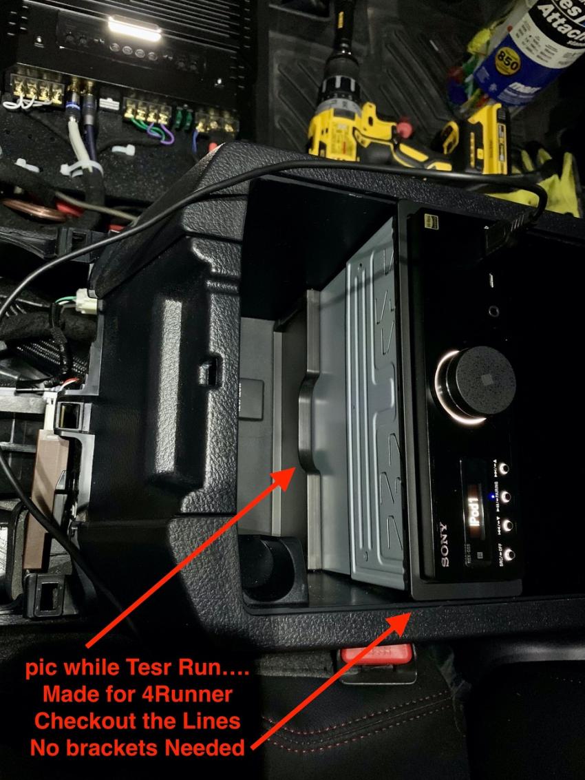

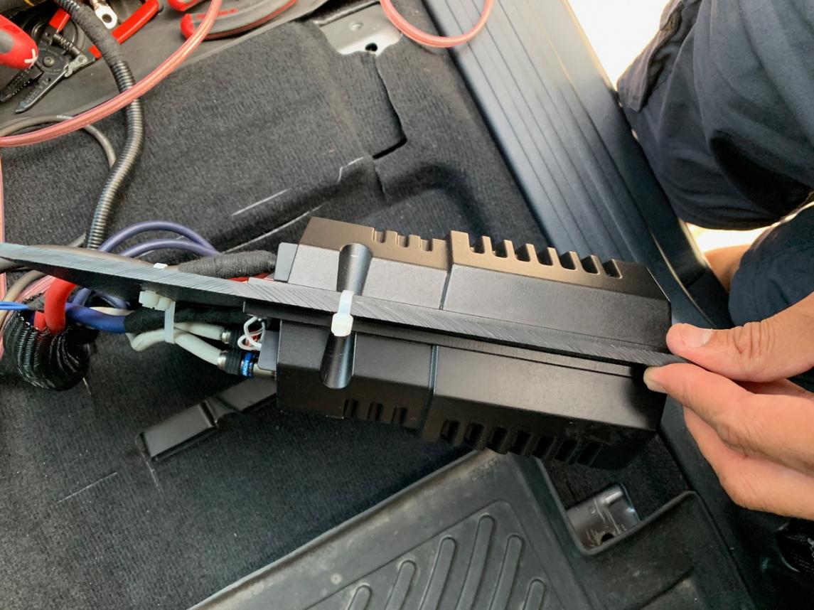

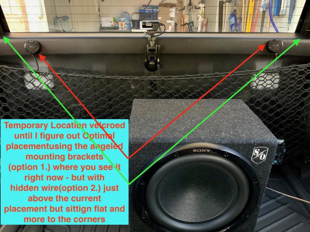

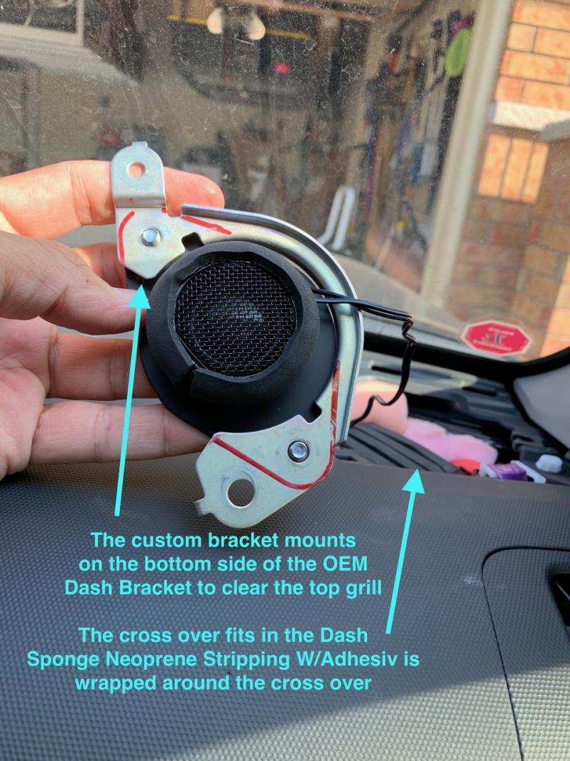

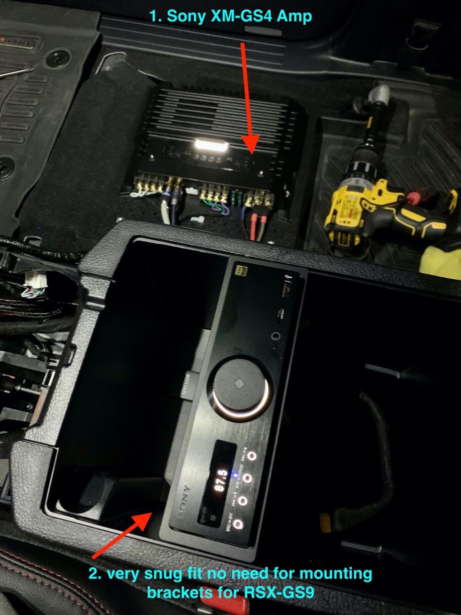

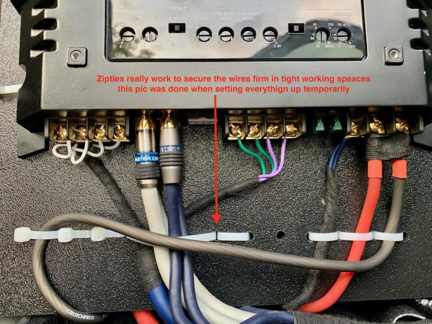

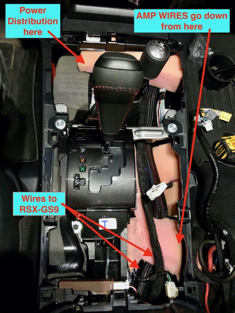

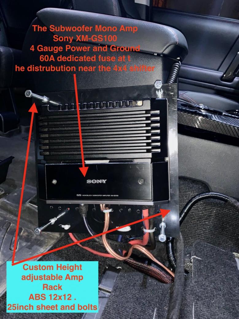

Parts list....
(01) Sony RSX-GS9 Hi-Res Media Receiver Retail $2000 x Qty 1
(02) Sony XM-GS100 Sub Amp Retail $329 x Qty 1
(03) Sony XM-GS4 4 Ch Amp Retail $329 x Qty 1
(04) Sony XS-GS1621C Front and Hatch Spkr Retail $350 x Qty 2
(05) Sony XS-GS1621 Middle Spkr Retail $279 x Qty 1
(06) Sony XS-GSW121D Subwoofer Retail $169 x Qty 1
(07) For 2020, Metra 70-1765 to connect Amplified speakers back to Factory Speaker Harness
(08) For 2020, Metra 71-1765 to connect to Factory HU Speaker Out to Sony RSX-GS9
(09) any type of 12inch Subwoofer enclosure you like
(10) wires fuses etc etc
(11) other sound dead Ning material was f your choice. I used Noico 80mil for all doors
(12) Roadkill Fast rings for all speakers
(13) Metra 72-8104 Qty 6 for connecting speakers
(14) Scosche SAT6 Speakers mounting brackets Qty 2 sets
(15) Metra 82-8147 Speakers mounting brackets Qty 1 set
(16) Toyota Factory Dash tweeter adapter (eBay) For 2010+ Toyota 4Runner Tweeter Dash/Front Speaker Harness Adapter Cable (Pair) | eBay
(17) ….I may have missed some small parts so I will list in the subsequent posts.

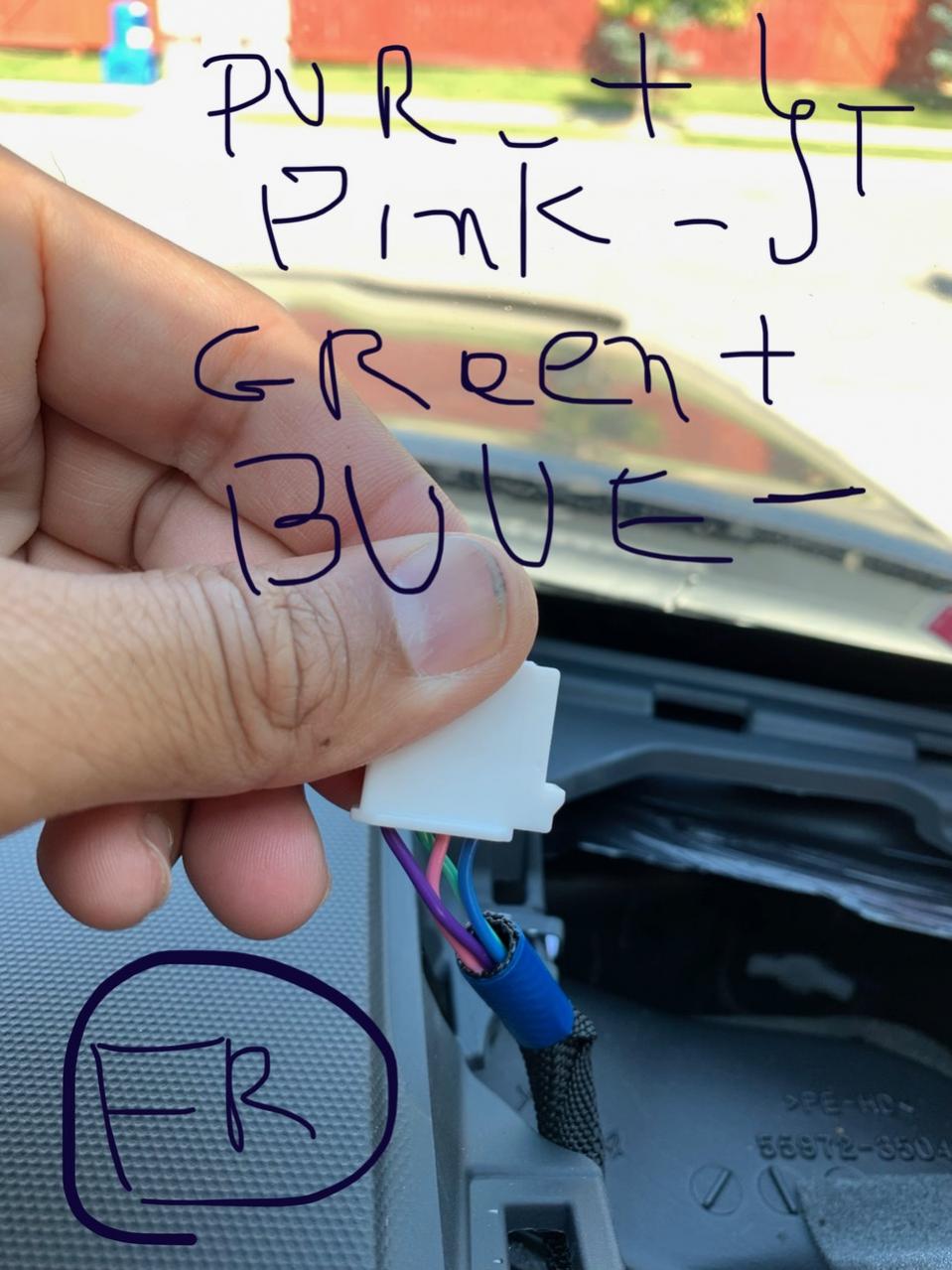

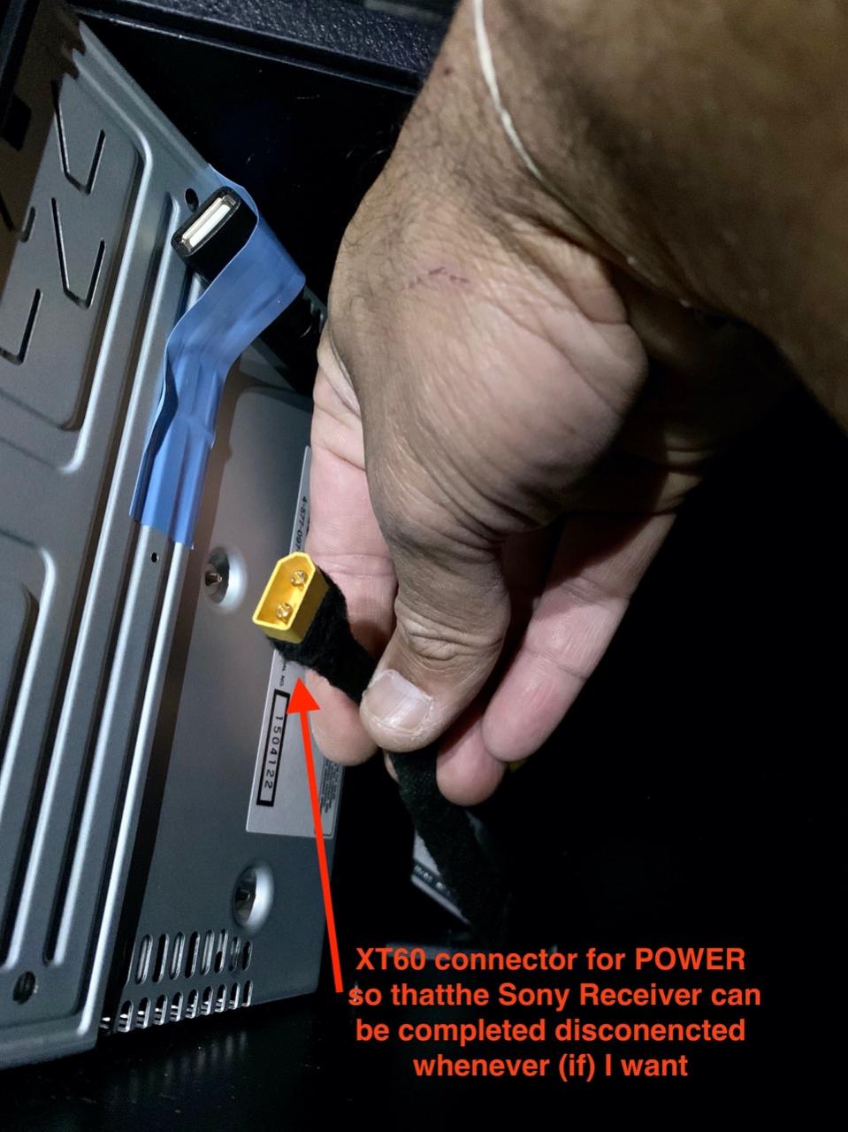

and some more pics... 2

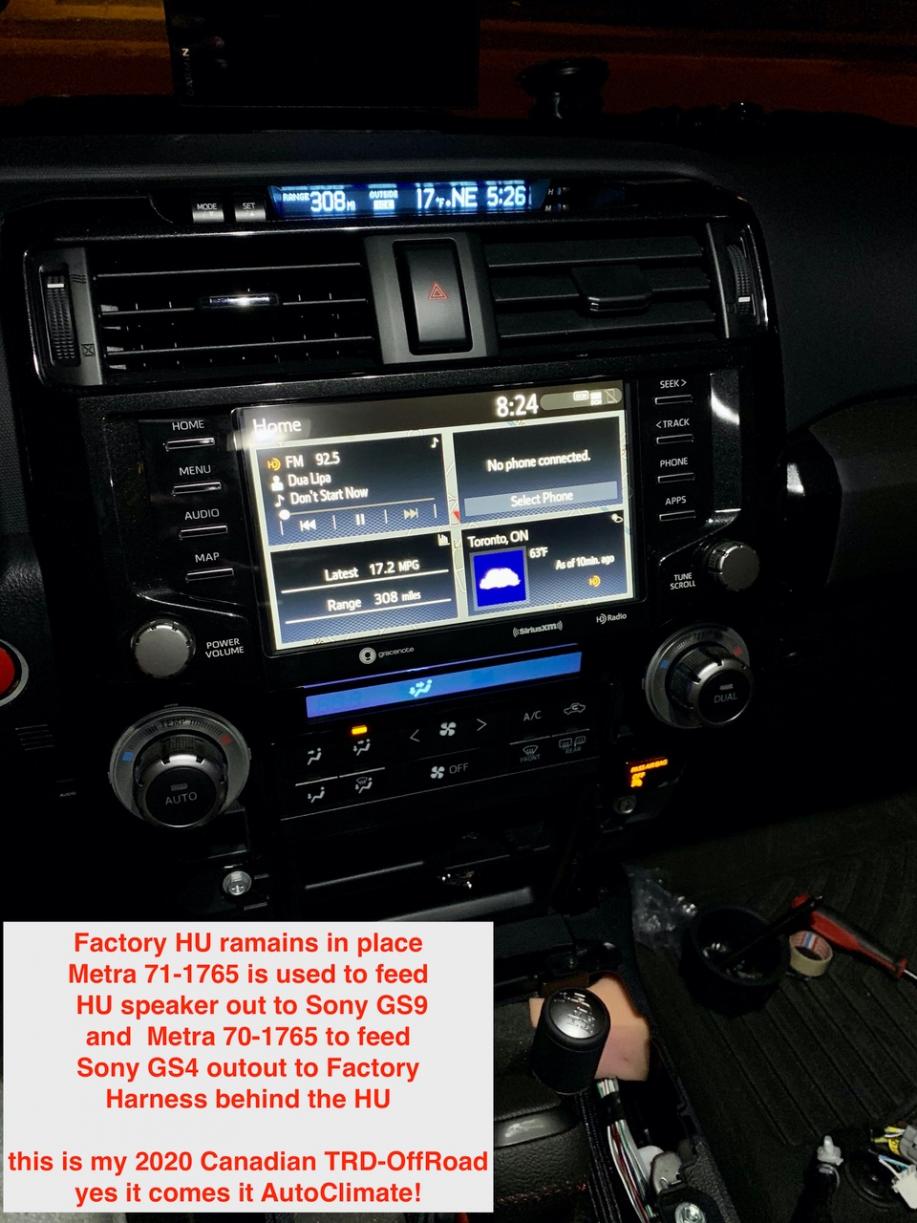

some more pics 3
some more pics 4
have some more pics but tired of converting them into smaller size.. lol
will try to answer any questions.
thee series of posts are covering the install only....
i will post separately on the sound quality review... first impression is just wow.... far better than my expectations.

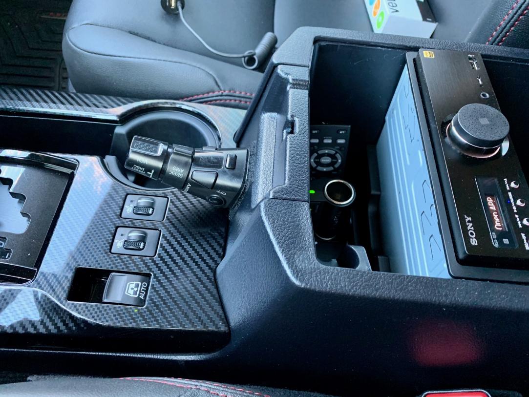

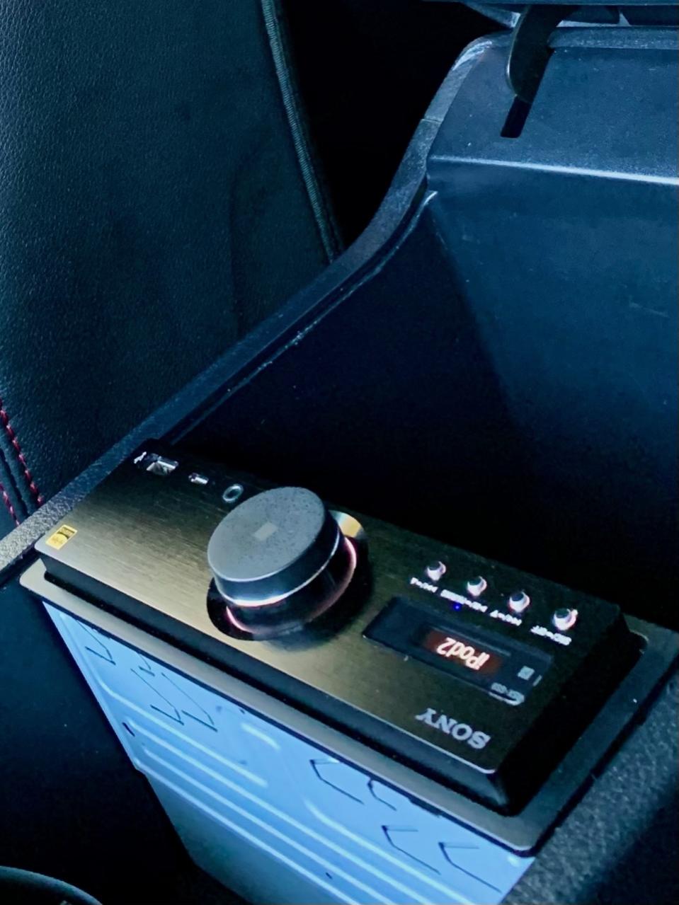

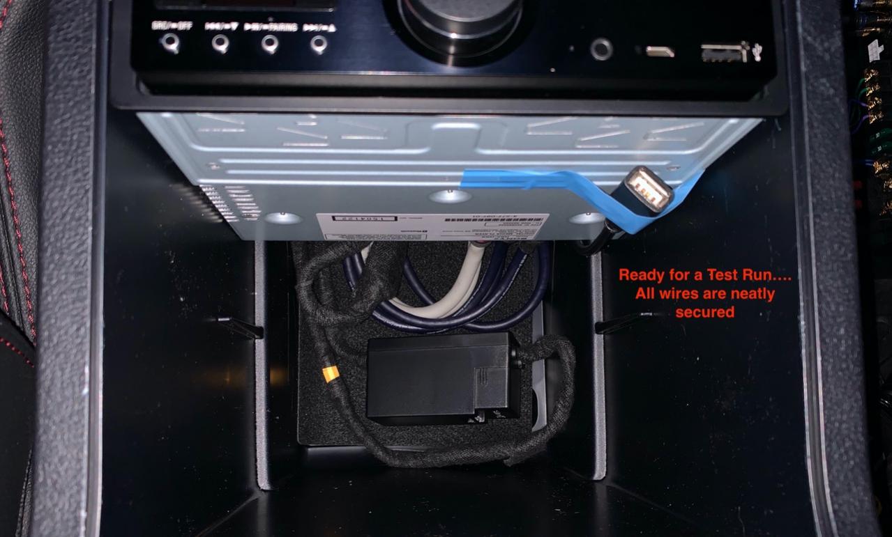

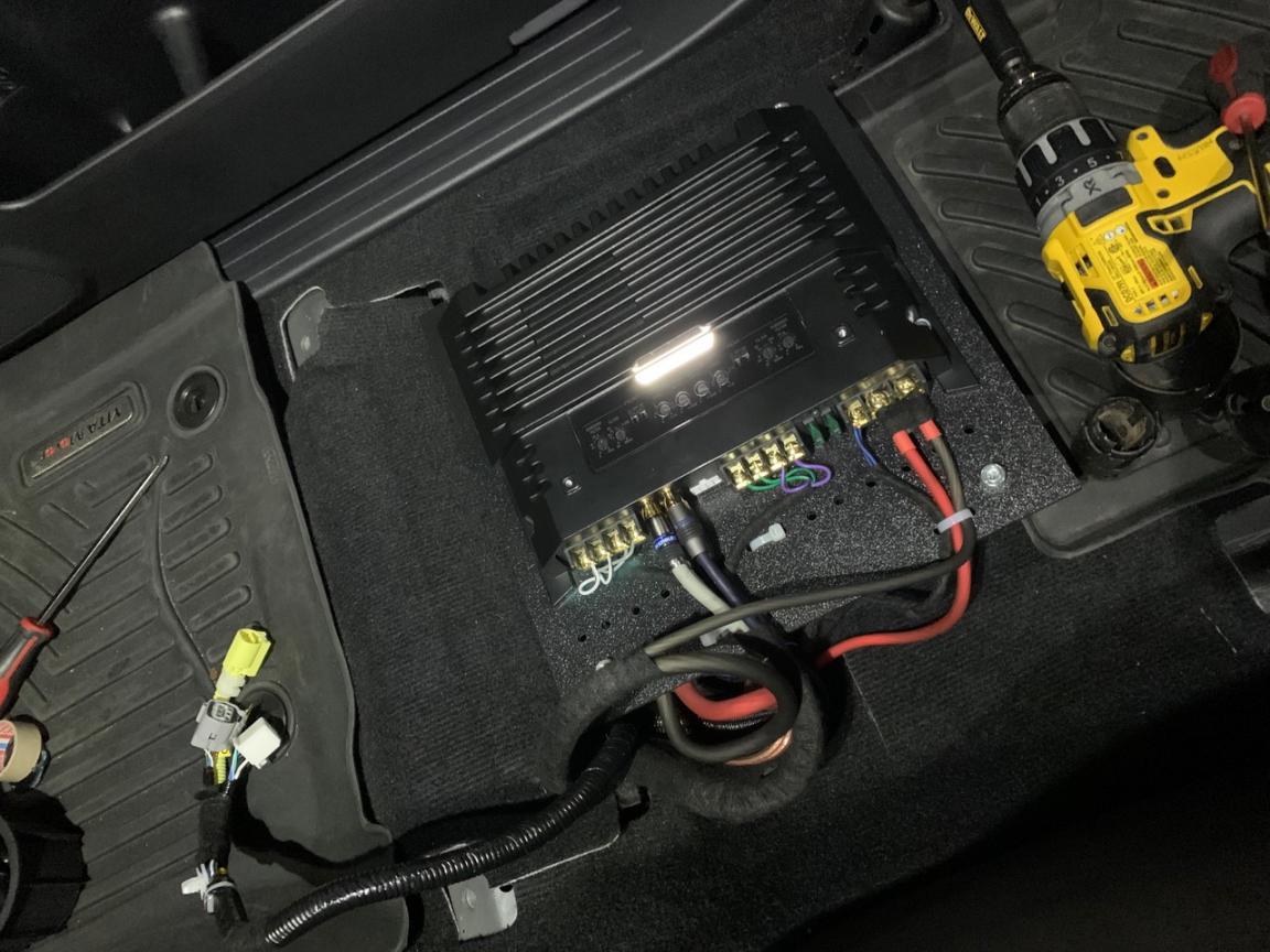

its done. uploaded some pics for reference. will post back on the quality review after playing around with some source files (varying sound quality).

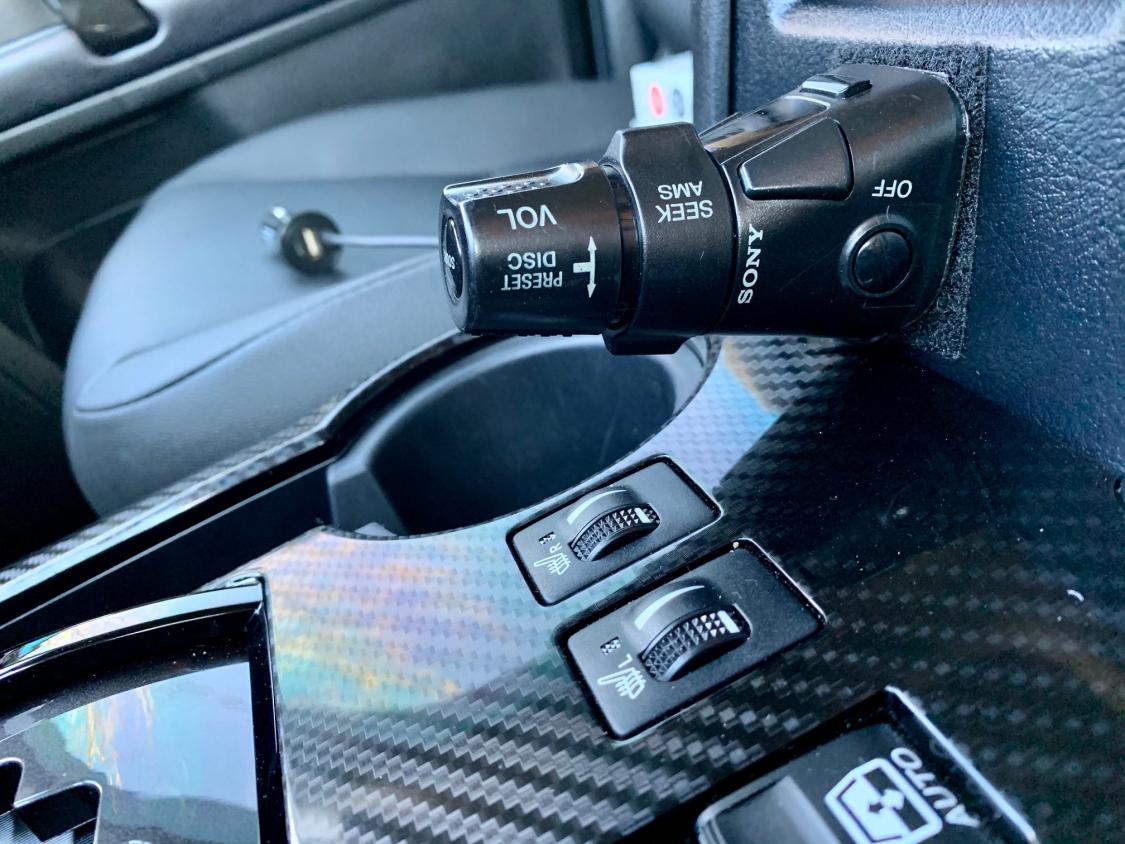

added an old wired Sony Remote... works really well.
changes source
volume
mute/att
power
track +/-
are some handy features

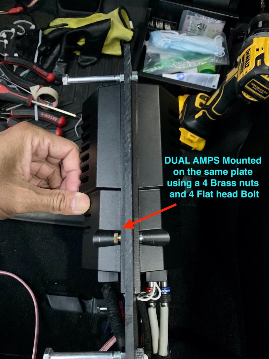

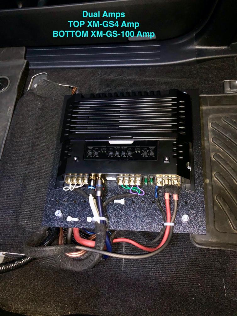

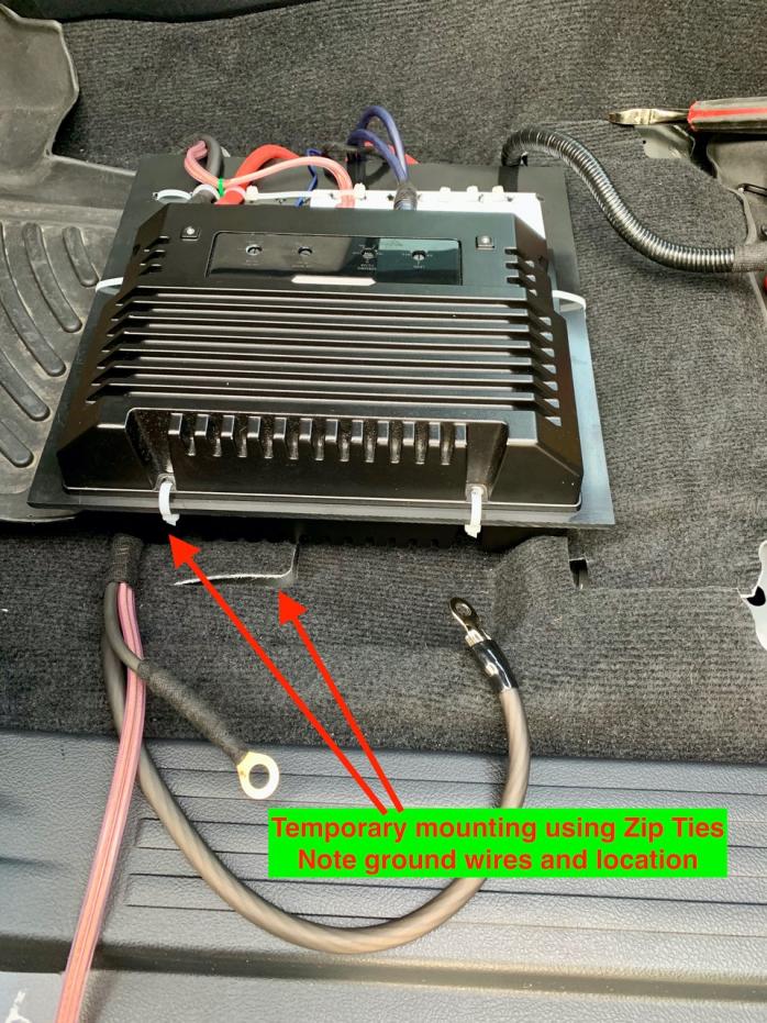

Thanks for all the pictures! I was looking to move a few things around in my 4Runner and the two amps on one plate idea under the seat may work.
Any issues with heat or noise from the wires and amps being so close to each other?
