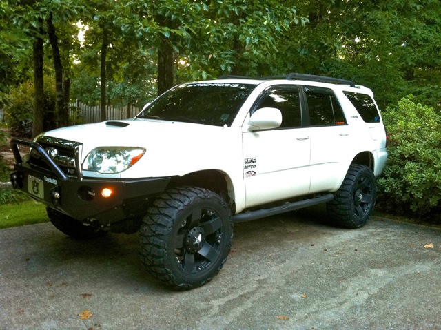

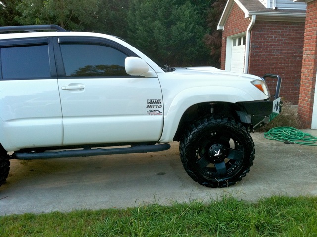

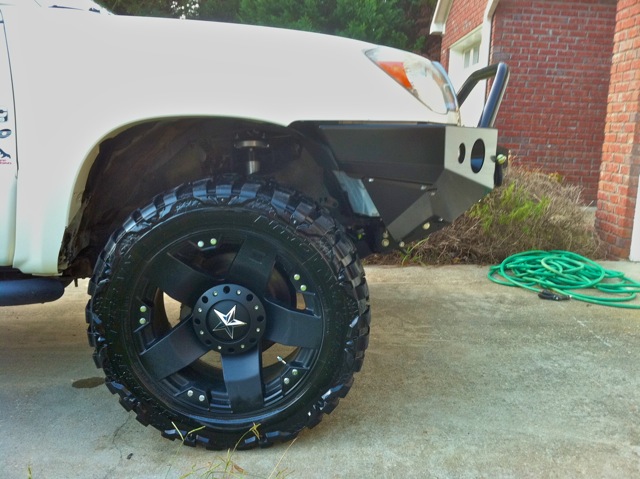

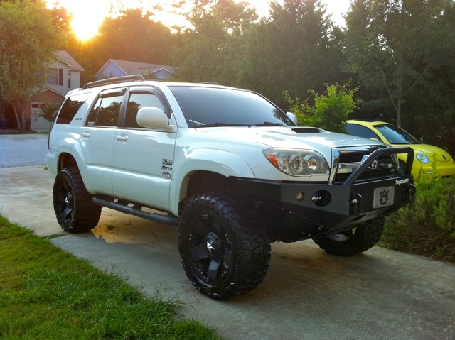

Some more new pics: The last one is a before pic
