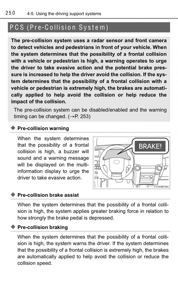

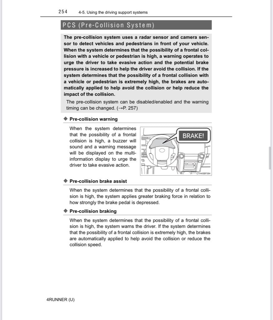

I’m not sure which model year it started, but a 2022 model will automatically brake.
From the 2022 owners manual:
Pre-collision braking
When the system determines that the possibility of a frontal collision is high, the system warns the driver. If the system determines that the possibility of a frontal collision is extremely high, the brakes are automatically applied to help avoid the collision or reduce the collision speed.

Right out of the 2020 brochure and owners manual.
https://cdn.dealereprocess.org/cdn/brochures/toyota/2020-4runner.pdf
