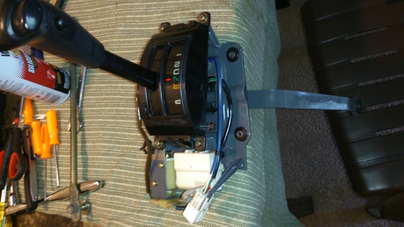

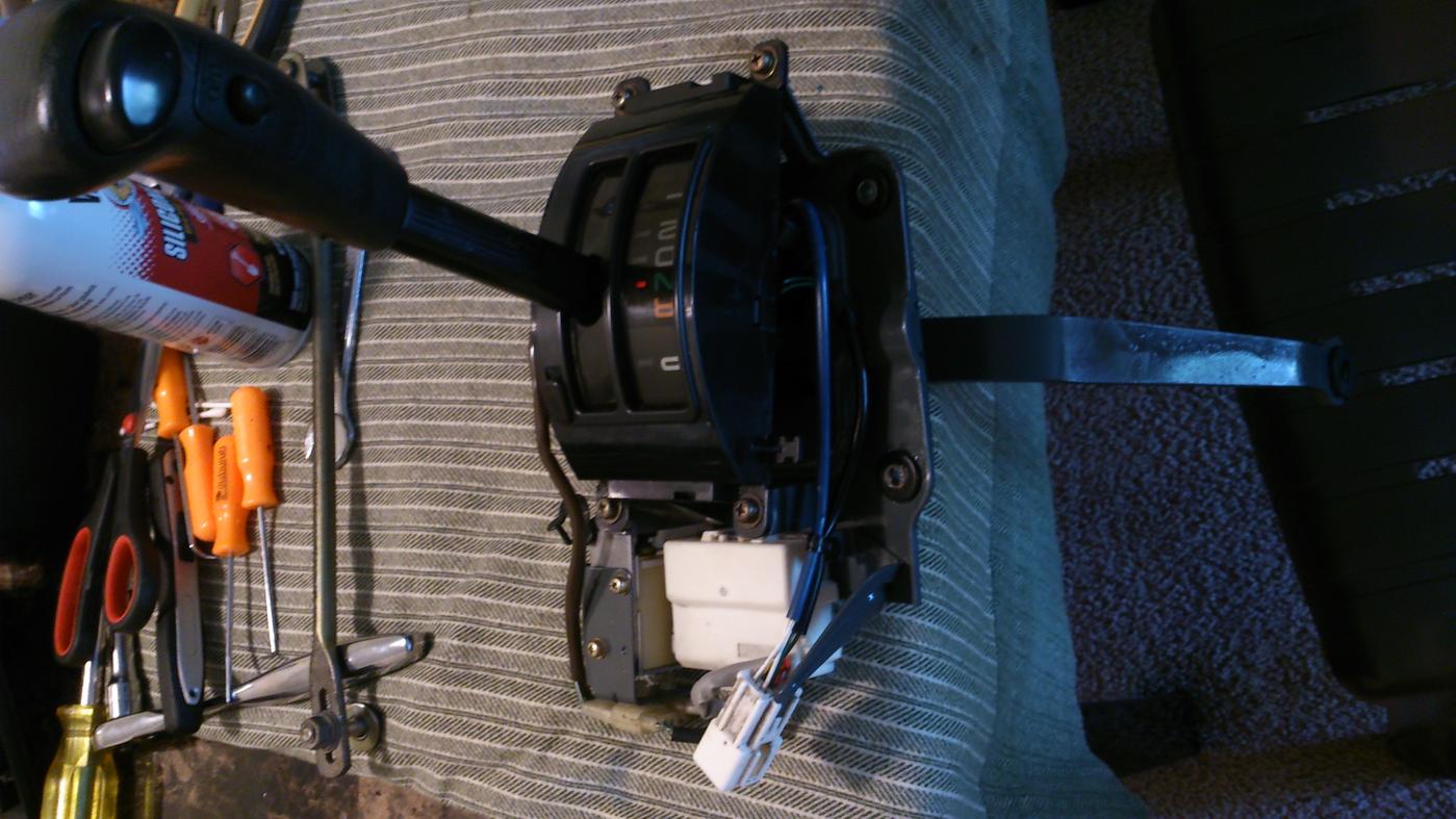

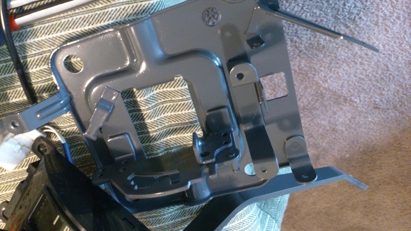

I fixed my 4runner 2.7L RWD shifter, even paint the rusty base in gray glossy color
looks much better

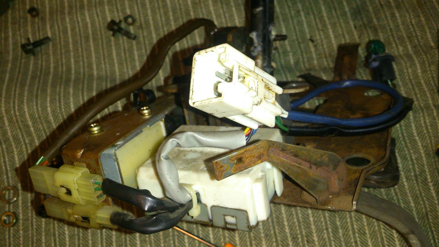

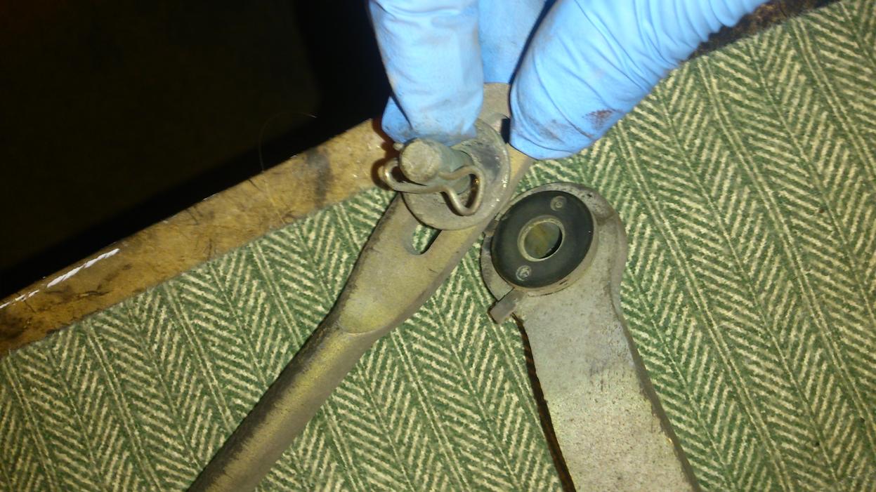

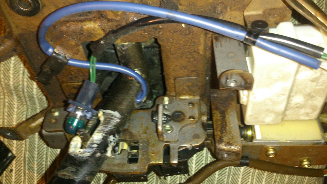

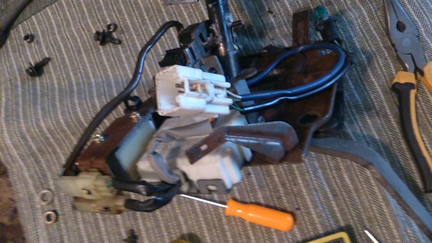

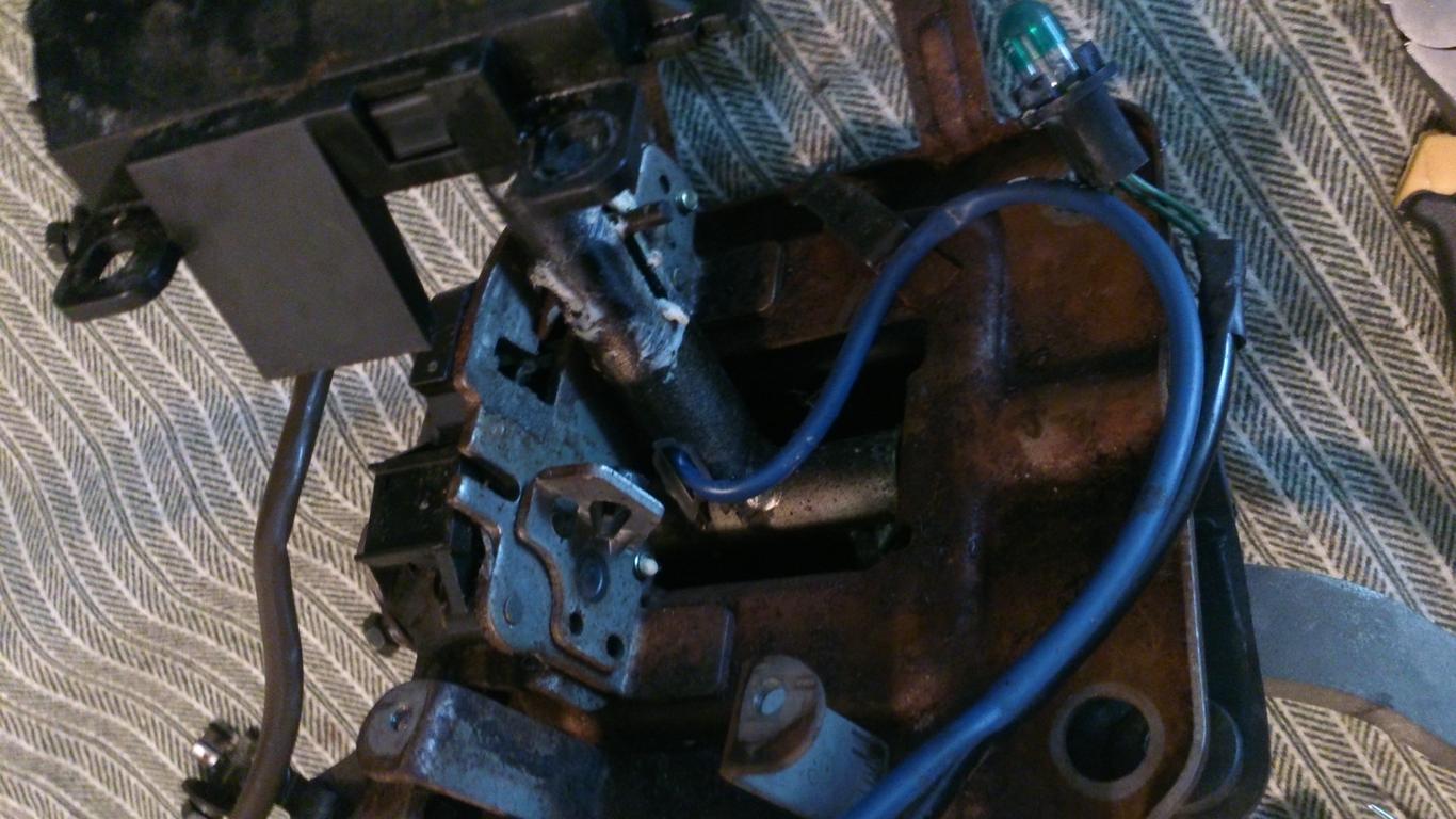

Finally did mine tonight after a year of ownership, 185,000 on the odo. Old bushings were blue powder, shifter bolt was like a hot dog in a hallway (to borrow the euphemism). I dare say nothing has changed the "feel" of driving it like new shifter bushings.
What's funny about this.... I bought a set of bushings with the expectation of replacing them. My shifter bushings were still perfect. And it looked like this before I cleaned it up:
-Charlie
