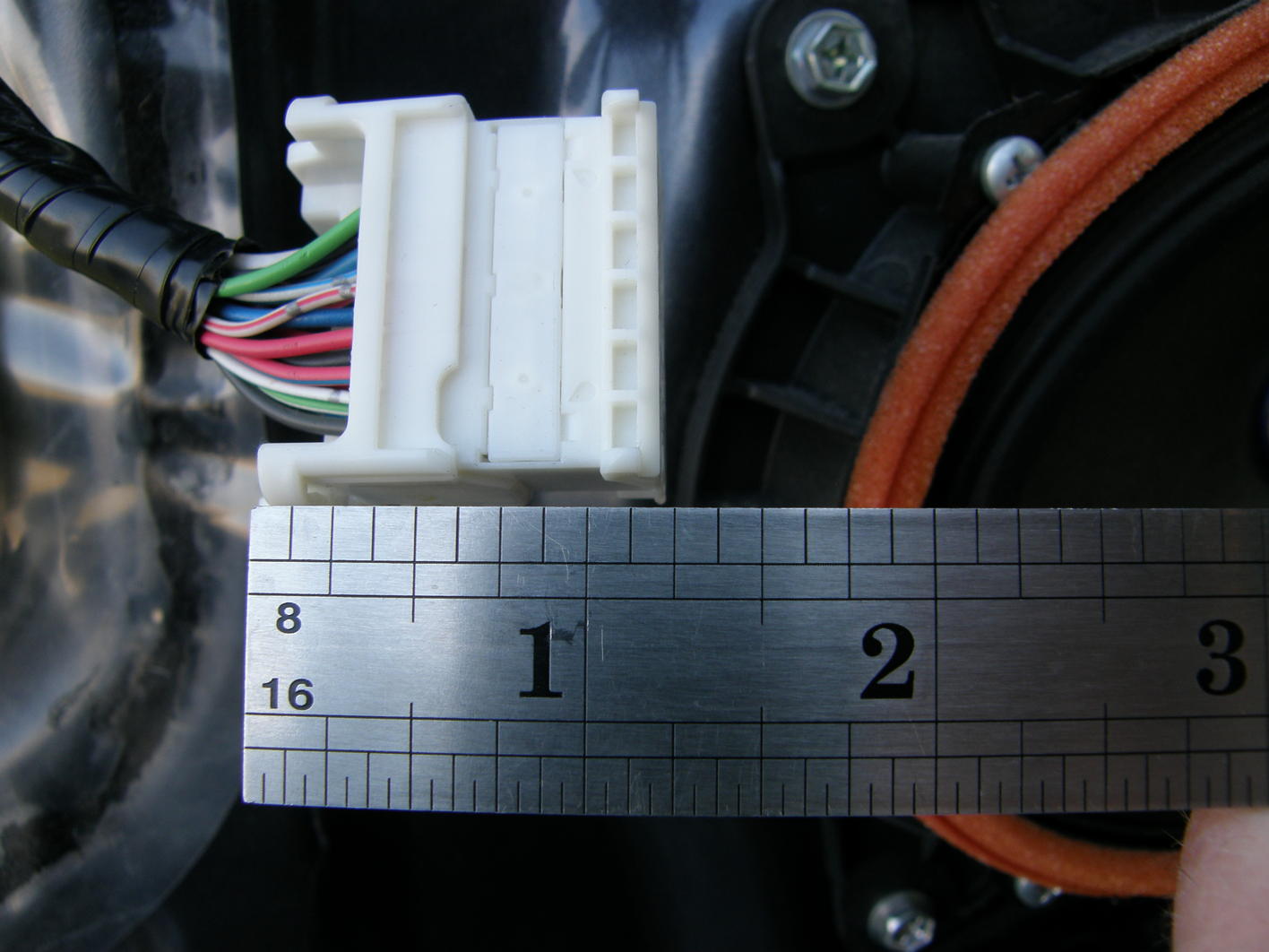

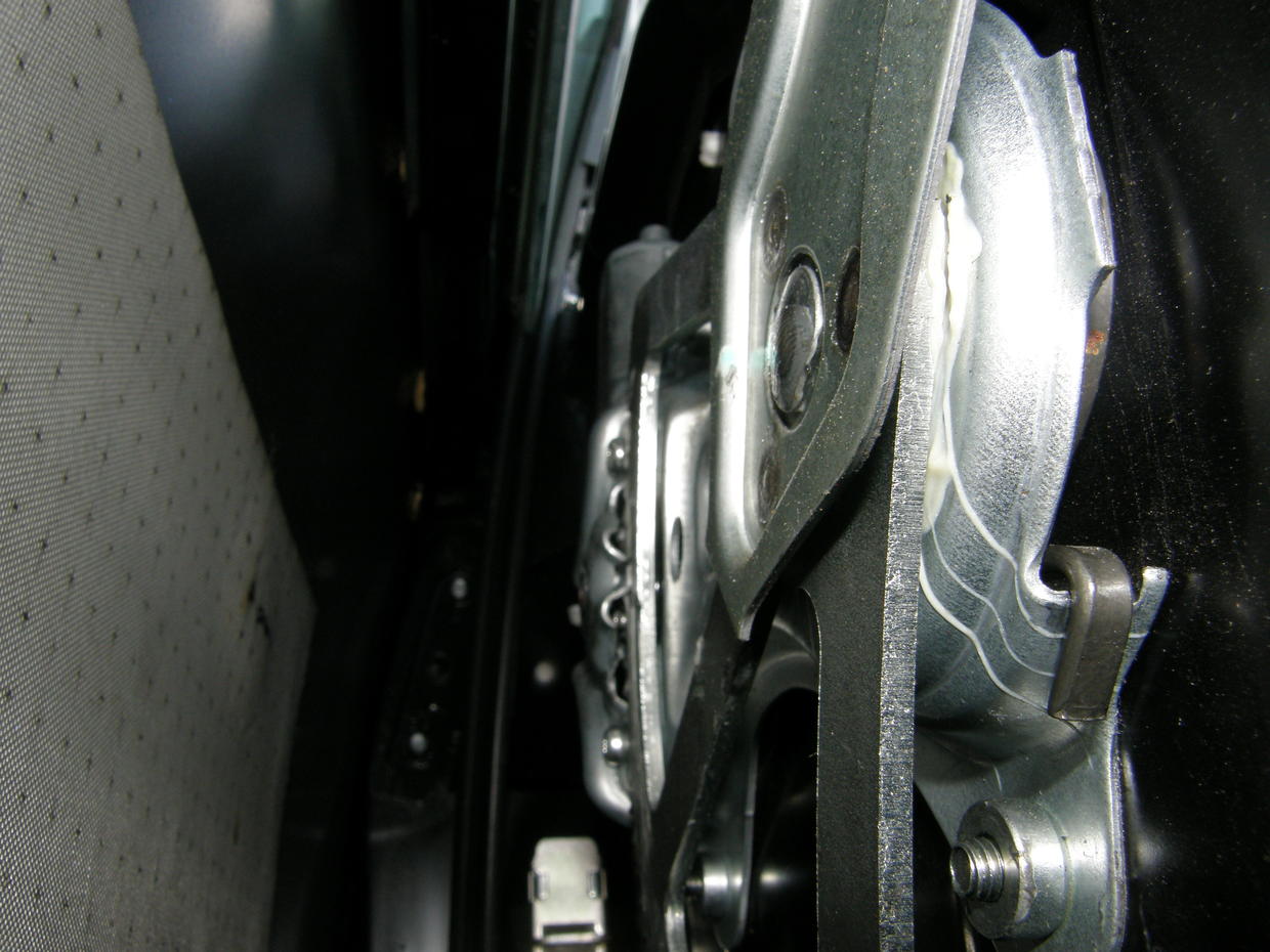

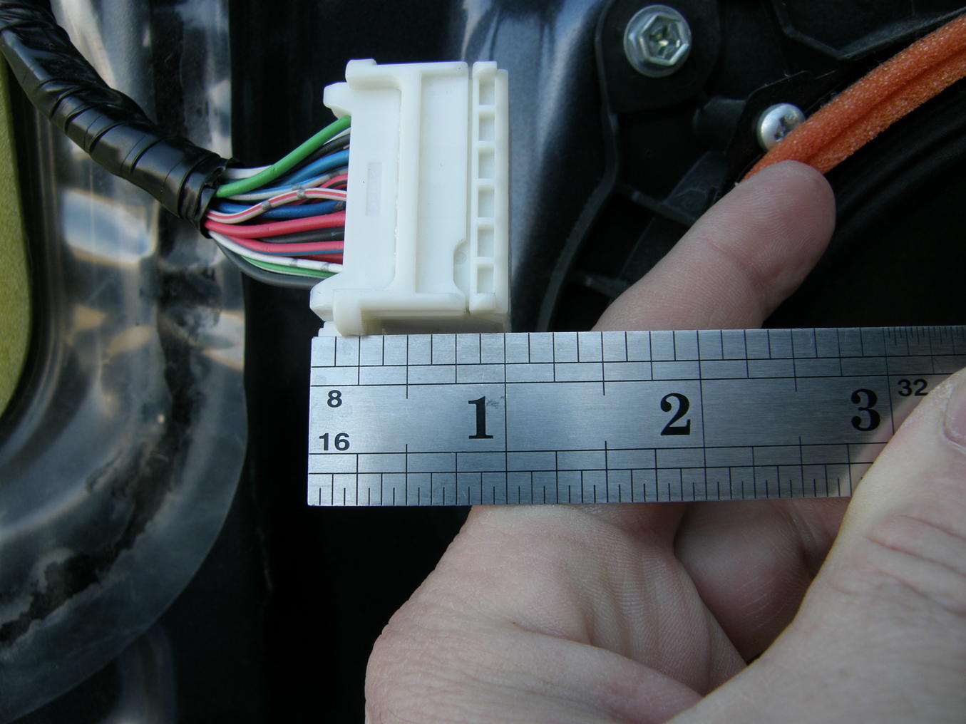

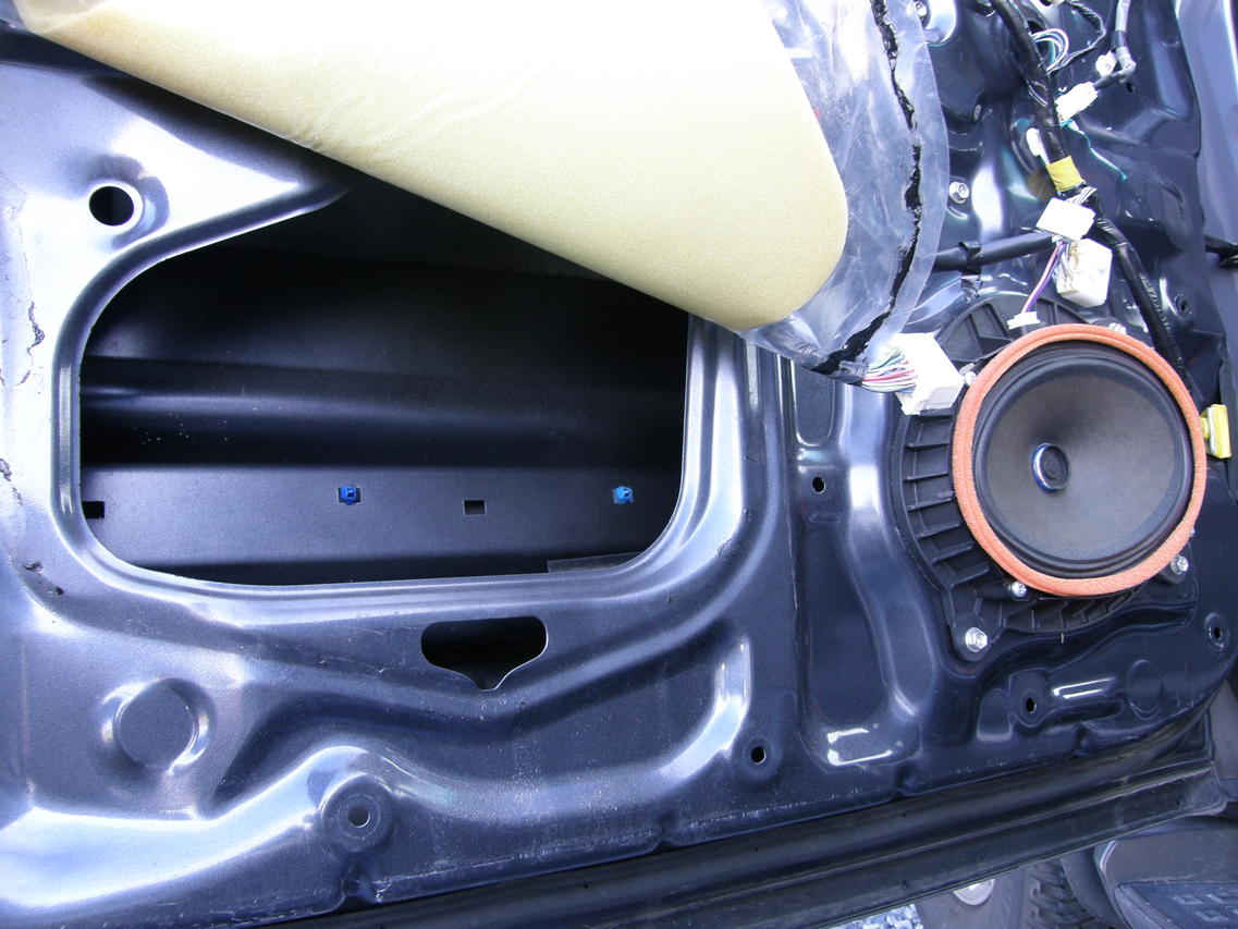

I finally got off my lazy @$$ and went and played with the stuff, all the wiring continuity stuff checked out so I guess I'll get a window regulator when I can and report back.
Well almost 13 months later I finally replaced the regulator & motor. It probably would've taken longer if I hadn't happened upon a deal on the regulator from someone who bought the replacement switch I tried. He's a member here, but not active and I don't know his username.
Anyway, it was a pretty easy process. I couldn't find a 4th gen writeup or video so I followed the 3rd gen video attached at the bottom. The process essentially identical except for the removal of the door panel, but there are several threads about getting the panel off so I already knew how to do that.
The new motor is a little louder than my old one but it does normalize and the auto function works. Thanks again for the help Paul!! [MENTION=66389]BlackWorksInc[/MENTION]
