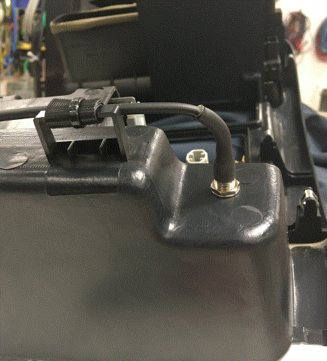

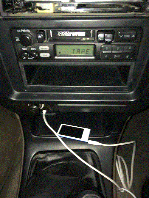

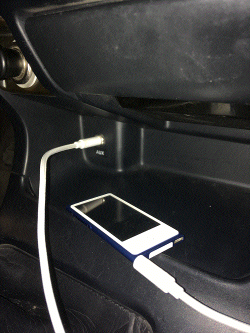

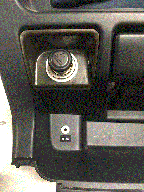

I admit, I have a bit of an OEM, original obsession. I grew up with these Toyota stereos and have a fondness for them. Plus they have great radio reception which is handy in a lot of places where towns are far between. They are actually made in Japan. The cassette deck still worked, but I was getting tired of the 4 tapes we still have. I wanted an Aux cord. So I put one in.
I have disabled the tape deck so it no longer works (easily reverted) and now selecting tape on the face keys switches to the Aux input. I taped into the cassette audio lines after the first pre-amp so the audio levels are pretty nearly matched between FM radio and Aux in with the Ipod set to 50% volume.
Very happy with this mini mod. May be my favorite yet.
I won't bother with any details as I doubt anyone would have the same stereo (or want to do this) but could provide if there is any interest.

It is the factory radio that came with my 96 base model 4Runner. I’ve not seen any others at junkyards so it might not be a common one.
Only 3 wires were connected and those were in the radio itself. Audio L, R, and signal ground. Harness was not touched.
