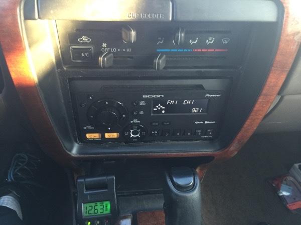

May be to clarify. I put an OEM scion radio in. It’s a T1819. It looks factory like a factory radio should. Not bling bling looking.
Look at that nice Call and End button to make phone calls through the radio.

The scion radio is both android and iPhone capable. Bluetooth calling is awesome. I spend 50min in my rig each way to work and back. I wanted connectivity and tunes for my drive to and from work. I paid 50 dollars and it included the Toyota adapter cables to convert the new radio wiring to the old stuff. I just needed to buy the Mic to do the hands free talking.

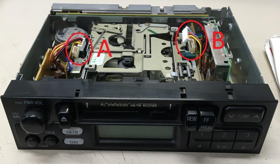

Well, thanks for digging this up again. Here is a little more info on how to do it. I know that LOTS would rather just put in a new stereo and that's fine. I just like the OEM stereo and wanted to keep it. This was a winter project to figure this one out so I don't mind the time it took me. I'm happy with the results.
This is for the basic radio in my 96 Base model. I would assume the tape deck and connections would be similar in other models.
There are 2 connectors on the tape deck assembly. The one labelled A needs to be disconnected and left that way, it powers the tape motor which is no longer needed.

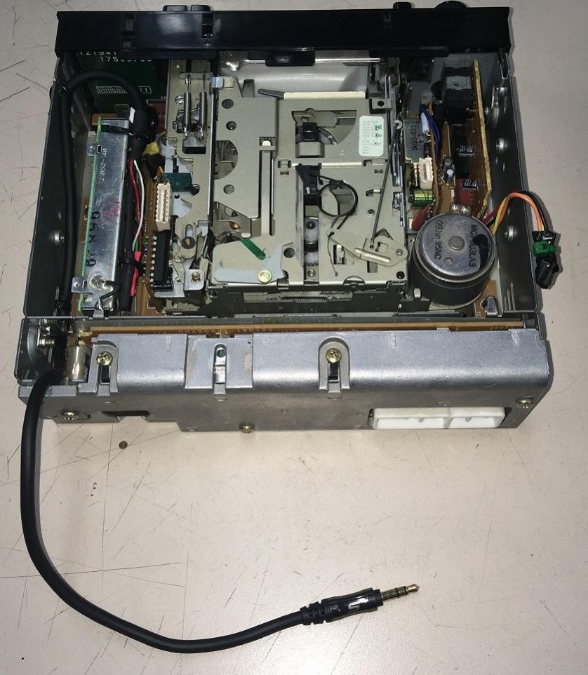

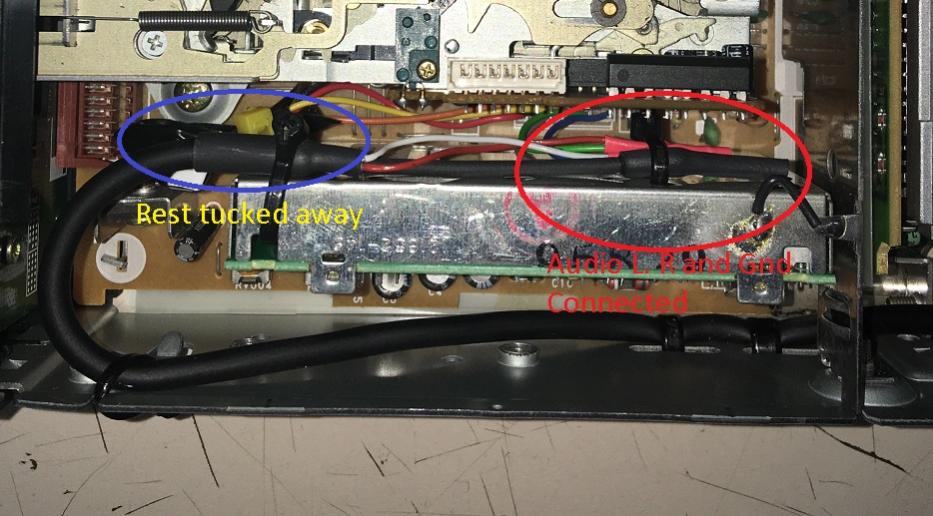

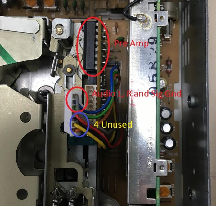

The connector labelled B needs to be disconnected also and here you will find the left, right and signal ground that you will need to tap into. The Tape deck assembly has an audio pre-amp built in. By splicing into the wires at the connector you are tapping into the circuit after the pre-amp which is good. I found the audio levels to be just about right here. When switching from aux audio to radio the sound levels are about the same.
I used a normal stereo aux cord and chopped it to suit then neatly tucked it into the stereo and fastened securely. I used a bulkhead type connector in the dash for plugging the Ipod or phone into.
I can't guarantee this will work for you but I have had no issues with it to date.
