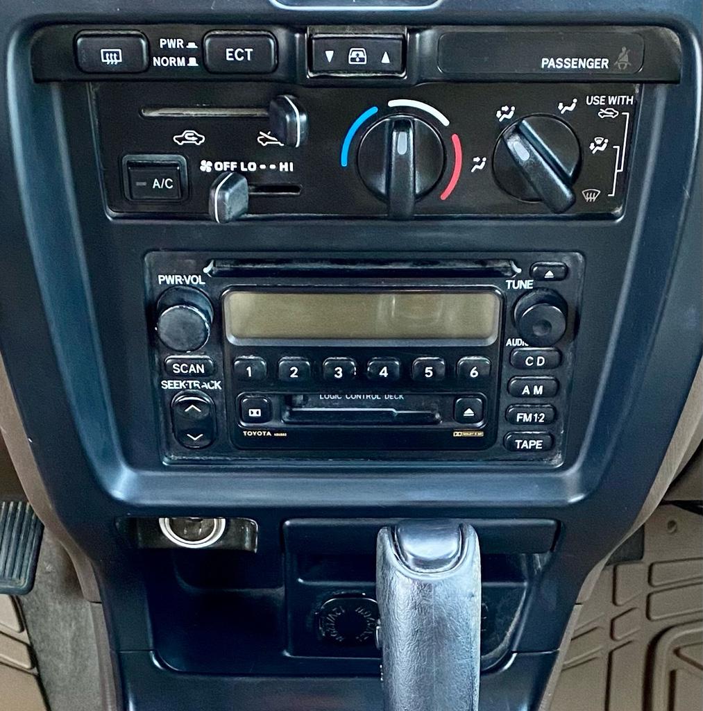

My symptoms:
1. Tape deck doesn’t play at all, it just immediately ejects the tape.
2. Screen is not backlit.
3. The Tune knob is not very responsive and sometimes either doesn’t change the station, jumps multiple steps, or even changes in the wrong direction.
So I have two questions:
1. Do I have any chance of repairing the unit?
2. Does anyone have a working unit they want to sell?
Bottom line, I can live with this broken unit. It's not the end of the world, the radio still works, and I can send music from my cell phone to the speakers with a little bluetooth/radio thing that plugs into the lighter.
But if I can fix/replace, I just might.
Thanks!!
I've encountered 2 of those issues. 1 I owned had a very sensitive knob ;), and would change the bass, tremble etc every time I tried changing the radio station. The easiest thing to do is to buy a donor head unit and swap the face plates if the mechanics of the player are fine.
The backlight issue is likely related to the face plate. If you've ever removed the faceplate you know that the faceplate interacts with the main PCB using some pin connectors. The chances that the LEDs themselves are bad is small, my bet is that it has poor connection or no connection.
The tape player ejecting the tape is one problem I haven't encountered, but there is a section in the FSM about it. Toyota's FSM doesn't go into working on the head unit, and I've had to get by using a service manual for a similar head unit. For that reason I would make your current radio a parts donor, it has too many problems.
Your best option is to buy other head units, and try to cobble one working head unit. It will be easier for you since you only use the cassette player for the adapter.
Each part of the head unit is modular component, there is a cassette mechanism, a CD player component, a faceplate, and the main PCB board that interacts with all 3 parts. Its a little difficult to swap out these different modules, and the cassette deck is by far the hardest to swap out since there is a ribbon cable that you cant pull on. If you want to swap parts between the cassette mechanisms (like gears), its very difficult since the most commonly broken parts lie at the heart of everything.

#1 depends entirely on you. Anything manmade can be repaired... the usual issue is if the repair is worth the cost ($$$ and/or time). For instance, do you have ANY electronics background? Can you visually identify a bad capacitor, or feel a sticky pot? Are you any good with sourcing (often times making) replacement parts that were never intended to live 20+ years? I can guarantee you that the unit CAN be repaired, it's just a matter of experience and money.
As for #2, looks like you could get an "A" grade part for $25+ shipping through car-part.com (just looked at one of the 3 variations of the cd+cassette combos, the others may be more and I can't tell which you have for certain, nor do I know if it matters).
