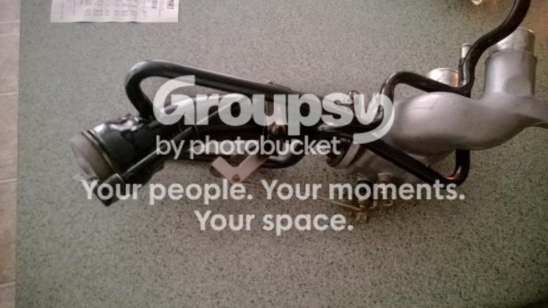

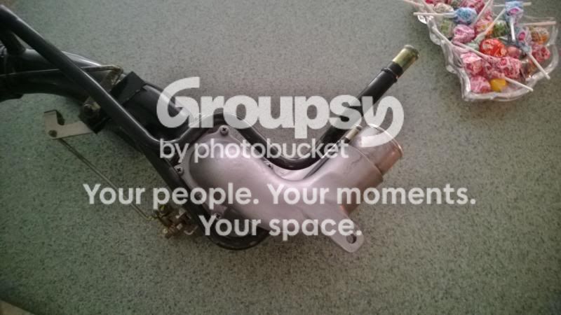

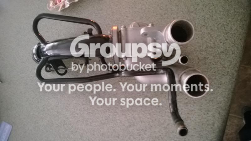

Well I scored the LC dual filler neck, should have it this week some time. Pics will follow once it arrives.
Time to figure out what tank to use as the auxiliary...
