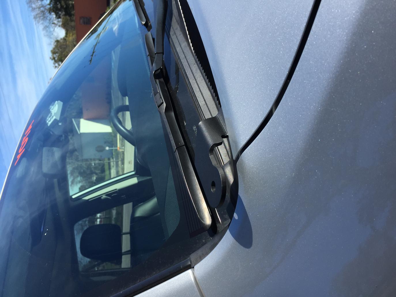

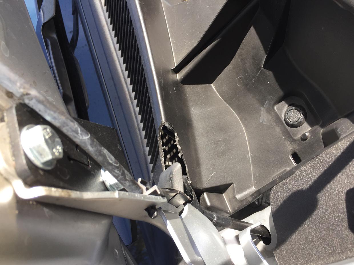

on the 4th Gens... the only fitment issue is that the cbi ditch bracket directions tell you to leave off the side cover trim pieces (not sure if the 5th gen have these same trim pieces or not...). I didn't like the way it looked with the bottom of the w/s exposed on the sides so I notched out the pieces around the bracket, which required more time but gave it a more finished look. The hood isn't removed so there are no alignment issues (the bracket gets mounted on top of the hood bracket base and longer bolts are used) as long as you're careful and do one side at a time. In other words, if there are alignment issues its the installers fault, not the brackets fault..
It helps a lot to have a 2nd par of hands to hold the hood open and in place while the bracket is getting installed/bolts are getting swapped out.
It can be done with one person but it involved a lot of swearing for me....
See attached pics. Alignment not good of the pics but you can get the idea
