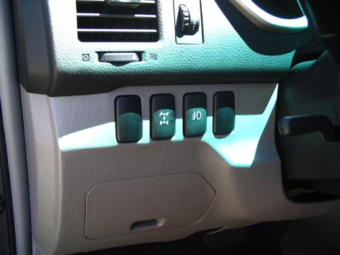

here's the info on the taco switch
84160-04010 - Taco switch
90980-11090 - harness that clips to the switch that will hold the wire plugs
82998-12340 - wire plugs, 4 Req'd
can one of you mods make this info a sticky??
Thanks Lou! Is that everything that is required to hook up the 525's? The Taco switches fit into all the blanks we SR5 owners have, right? One last question. With that list, can you wire up the LED seperately like Alex was talking about?
SCRunner said:
Thanks Lou! Is that everything that is required to hook up the 525's? The Taco switches fit into all the blanks we SR5 owners have, right? One last question. With that list, can you wire up the LED seperately like Alex was talking about? [/QUOTE
YES!
fits like a glove...
