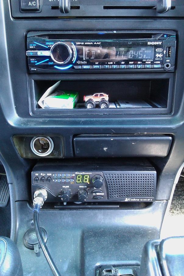

My 2M setup is under the radio. I made spacers and mounted it with the factory radio mount. The dash comes apart easily and the radio mounting bracket comes out with 4 screws. There is enough room and ventilation that the heat dissipates well (my radio is 75 watts but I run it at low power unless necessary). I have run a similar setup in 2 1995 T4Rs with no heat issues. The CB is where the ash tray was.

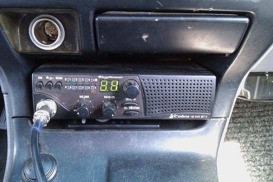

I am running my Cobra 18 under my single Din radio and my Kenwood TM-271 on the side of the transmission hump. My plan is to put the TM-271 under the single DIN and mount a Uniden 520 in the ashtray spot like Ozark did. Right now though it works fine n the side of the transmission hump and passengers have not complained.

yeah i love my Cobra 18 WX ST II cb, to me i find the NOAA weather feature invaluable especially in an area like Moab where flash floods and weather can happen fast and change repeatedly thought out the day. and its also nice having the built in speaker front facing. to me its worth every penny i paid for it.

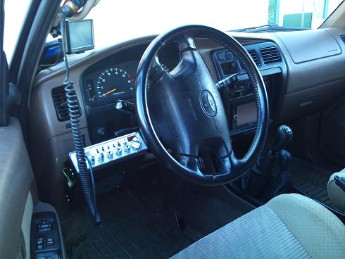

They said it cant be done...lol
Its the best place for it really.. No holes were drilled because you can use the existing dash mount hole... i just used a longer screw to reach it. Then zip tied the other end of the mount (closest the door )to the metal behind the dash ( just remove a small plastic cut out and zip to something metal..lol)
You have to mod the standard mount that came with the radio make it look like this \------\ so it pushes the radio closer to the steering column ..
You can do a far better job buy drilling holes but i want to be able to keep my interior mint.
Oh ya! the 4runner comes standard with a perfect mic mount! it holds it tight for some reason too!!
Does not interfere with the hood latch or gas flap... i do have to go behind the CB to hit the clutch start cancel button.
There are two issues with the mount,
Issue #1 it just touches the door when closed but very lightly were you have to watch for it , but no visible wear in the door.
Issue #2.. if you sloutch down while driving your leg could touch it.. but So far I havent.. and if you move the seat back one notch you wont hit it.
