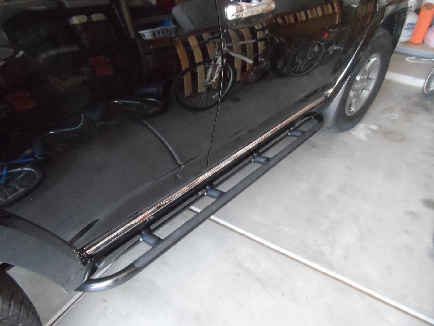

This is my second 5th Gen 4Runner. Loved my 2010 but needed 3rd row with growing family.
This time is decided to go with sliders instead of nerf bars. I am so glad I did.
I found a great local company that did an awesome job fabricating. (Avid Off Road)
Now I can get a lift and the short legged people in my family can still get in.

That looks good. Nice job. The reason you doing this is because it's cheaper(how much doe it cost by the way)? Or you have some special needs?

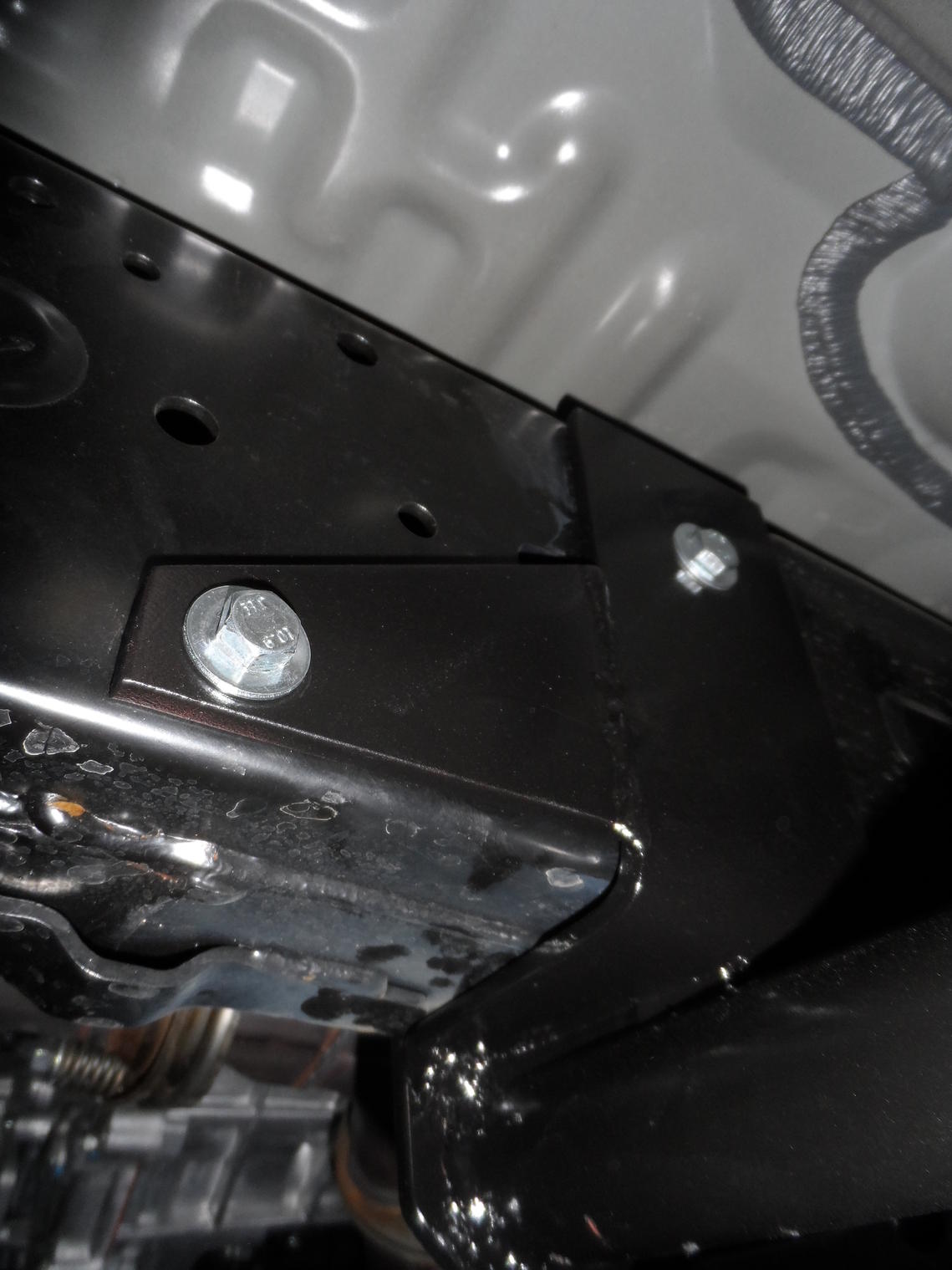

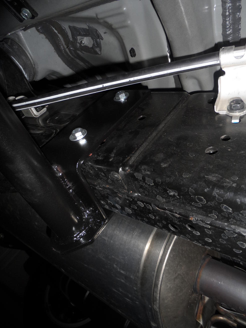

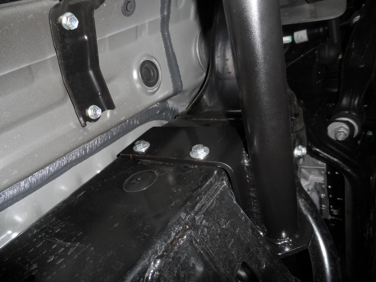

Do you mind posting an upskirt picture of those sliders? The mounting feet on those look pretty serious. How many attachment points do they have?
Looks good!
6 mounting bolts per side.
I think they are very well made. Granted this is my first set of sliders.
It was a little more then nerf bars, but since Avid is local, I didn't have to spend anything on shipping.
I did it for three reasons:
1. Short people need help getting in, especially when I get my lift.
2. Parking lot armor, for people that don't know how to open their doors.
3. And to be ready for off-roading

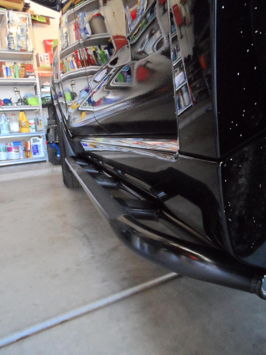

1 - These slides are designed for an SR5, hence the bar UNDER the frame in order to accommodate the rocker panels. Because they have to clear the lower rocker panels, you are losing a little ground clearance.
2 - Because they do not have gussets, they MAY be a direct fit for the LTD, but that's hard to tell from the pics. The XREAS lines may still need to be bent out a bit on the LTD in order to not rub.
Looks like a pretty nice job though!

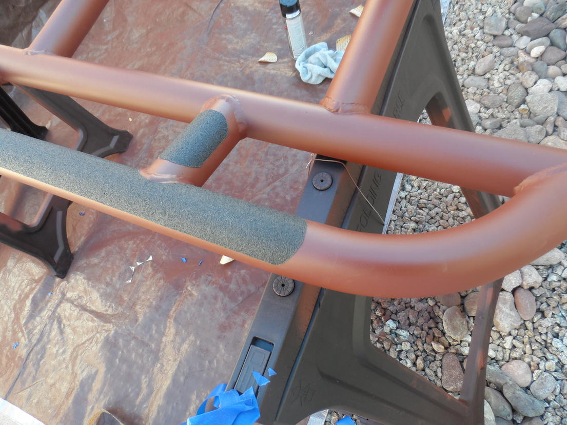

off topic, is that skateboard grip tape?
Could be. Also sell huge sheets at home depot for stairs and whatnot Same shit basically.
I wouldn't really recommend tbh. Grip tape gets pretty gummed up with mud. You would have to carry a skateboard grip eraser around. Just another thing that will require attention.
