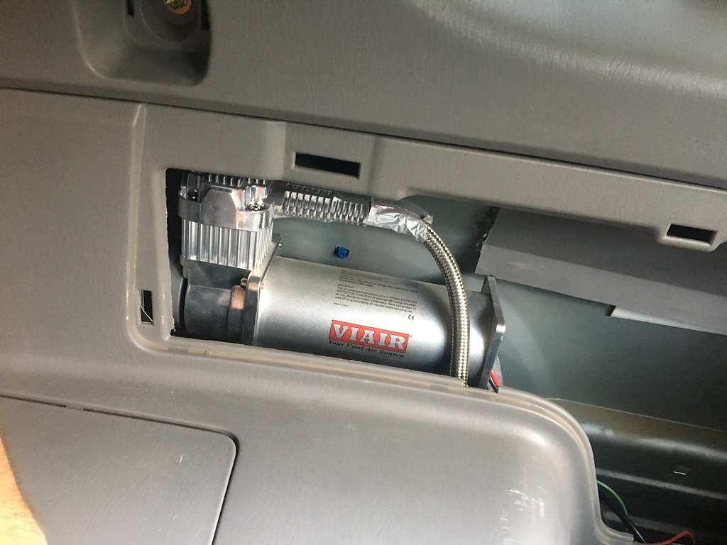

I bought a Viair Air system a while back on a 4wheelparts sale. It has the Viair 450c compressor which is a constant duty compressor and a 2.5 gallon tank. Just got around to installing it this past week. I have the compressor mounted in the back in one of the storage compartments, along with the switch. The tank is mounted underneath in the spare tire area. I used some u-bolts to go over the brace that holds up the spare tire.
I went out to the Ouachitas earlier this week to go fishing at Lake Winona and aired down to test out my new OBA sytem. The compressor is able to fill the tank to 150psi in about 3 minutes which is what I expected. I aired down to 18psi and using the system I was able to air up to 38psi in about 10-15 minutes. It is hard for the compressor to keep up with me filling up the tires, so after every tire I let it fill back up most of the way

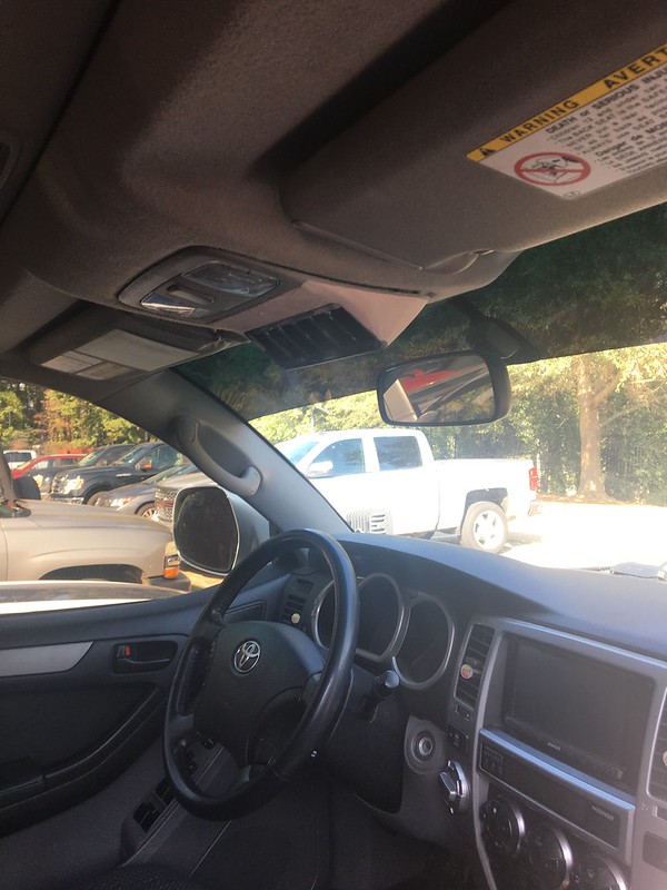

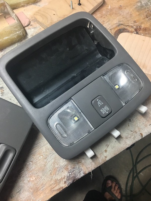

I've added some lights to my rig and each light needs a switch so I decided to make a switch panel in the overhead sunglasses holder compartment. I'm going to try and do somewhat of a write up on this since I haven't seen anything much like what I'm doing. So first thing I did was take out the overhead panel and then take the sunglasses holder out of it.

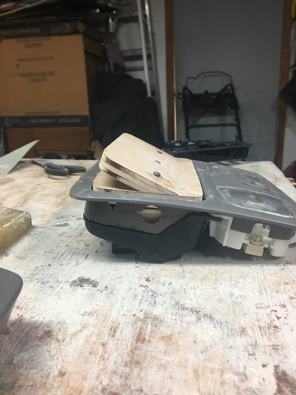

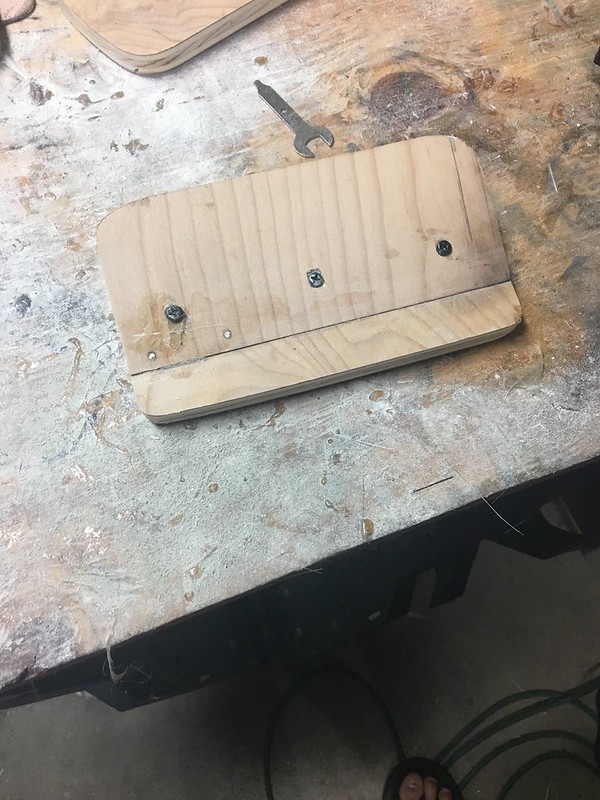

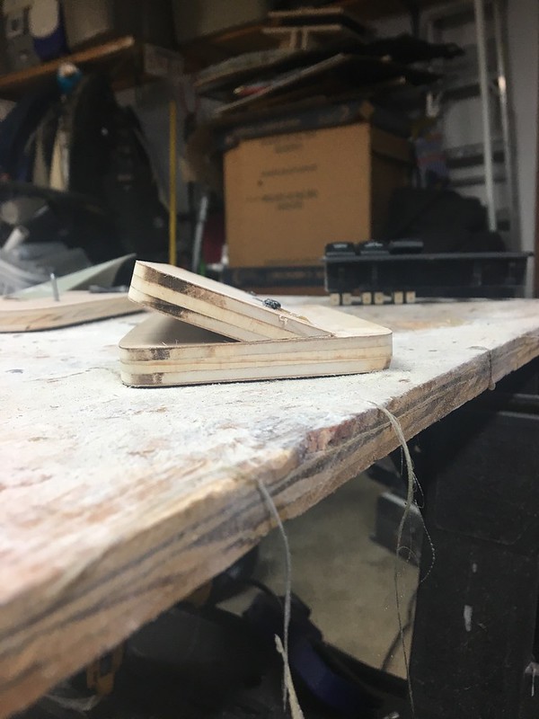

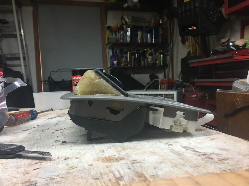

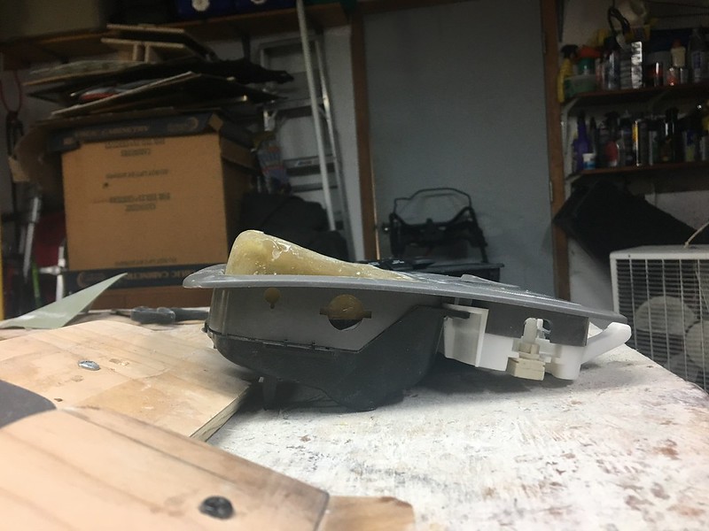

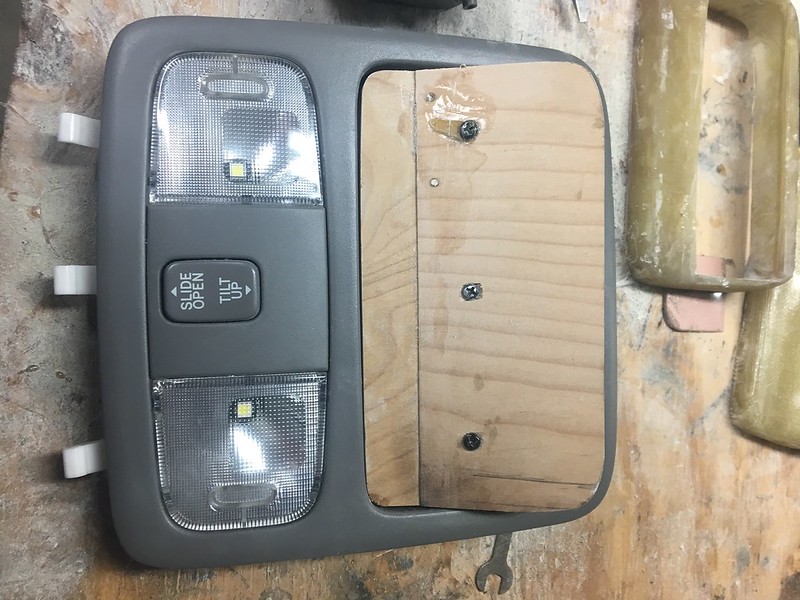

Then I traced the outline of the holder onto a piece of wood I had laying around to make the base for my mold. I knew I wanted the switch panel to be angled slightly so I could see the switches so then I traced the 6 switch panel I bought from OTTATRW onto another piece of wood then sanded down one corner to the angle I liked and screwed the two pieces together. It looked a little something like this. I didn't want the panel to cover the rear view mirror so its not a huge angle.

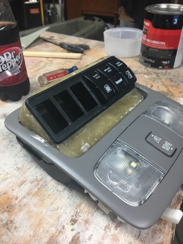

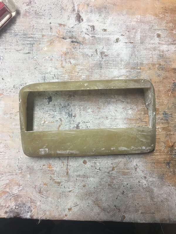

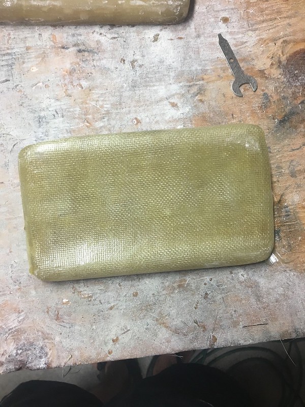

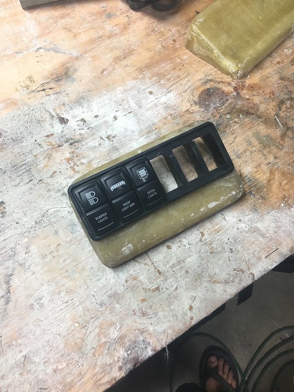

After that, I tried to form some kydex to that mold I had made and that didn't work out so I ended up using fiberglass. I wrapped wax paper around the mold so the fiberglass wouldn't stick to it. The first attempt with the fiberglass was too large, but I was able to sand it down to where it would fit. It was too thin though and I ended up cracking it trying to get it in perfectly. So I tried again but with a different approach. I put a layer of fiberglass cloth over the mold, and once it dried I sanded it a little bit and then put a layer of fiberglass mat on top to so the corners would be smooth. After that had dried, I pulled it off of the mold and so the fiberglass would not be too thin, I put two layers of fiberglass on the inside. It worked like a charm and I was able to sand it down and get it right while still having the strength. After that, I cut the hole for the switch panel to fit. The fiberglass looked like this after I was done.

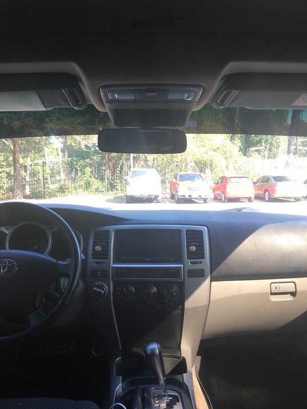

After putting the overhead console back in and playing with the panel for a bit, I realized that my rear view mirror could move more than I thought so I was able to angle it more than what I had originally anticipated. After figuring that out and playing with it some more I got it to where I liked it. It's not covering any of the mirror, but a little bit of it can be seen in the rear view mirror. I marked it, then glued it in place.

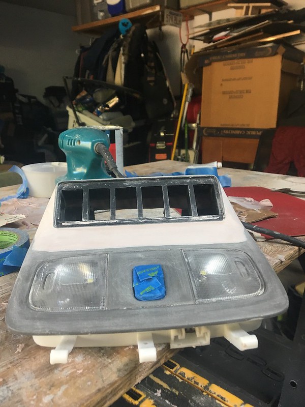

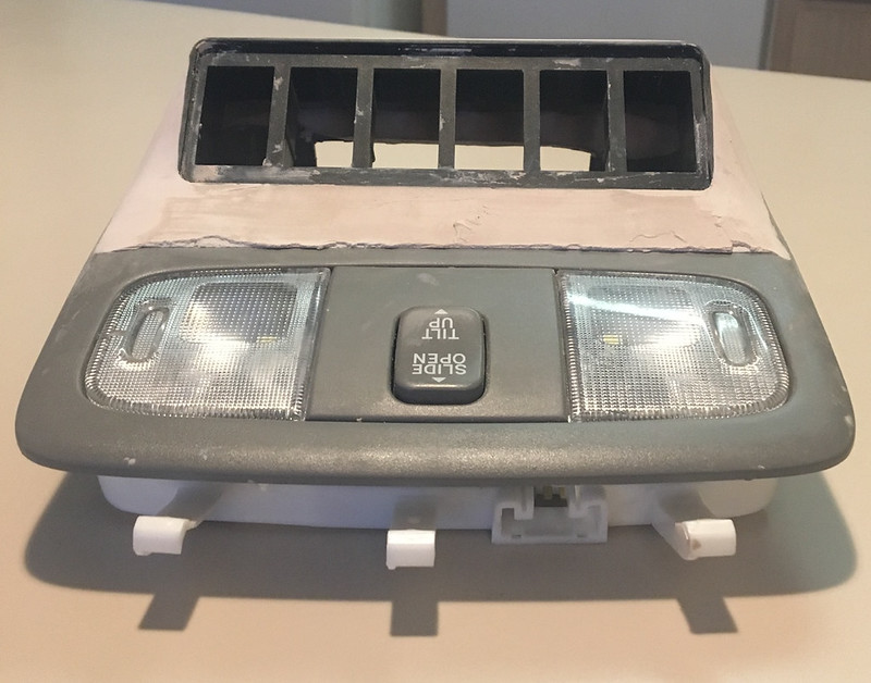

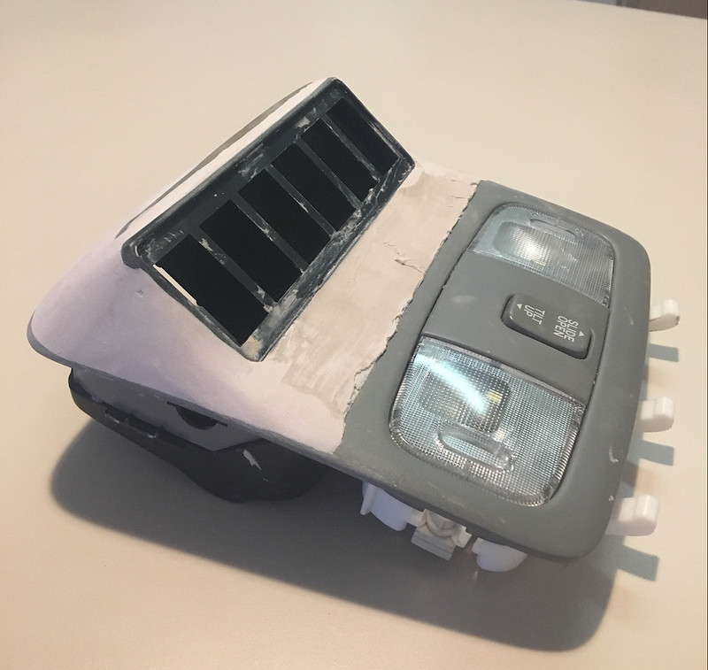

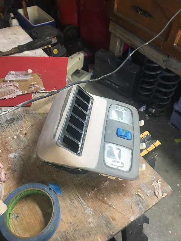

I've started to bondo it so that it's seamless with the overhead but haven't finished. So far I think it looks pretty good. That's all I have been able to do so far, but I plan on finishing it up later this week.

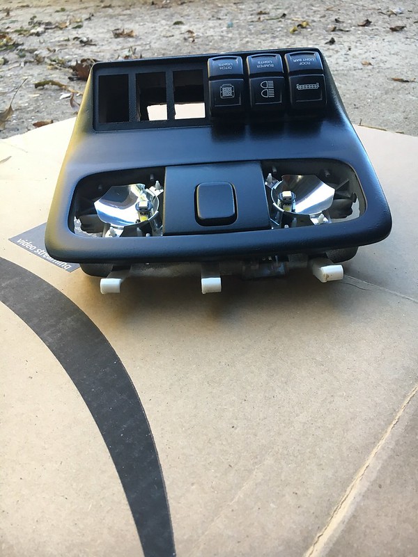

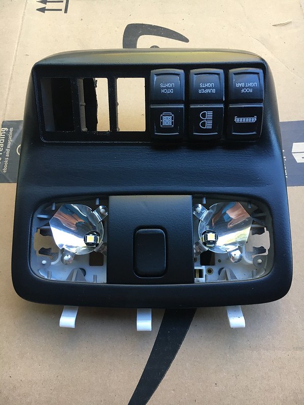

Well I got it all sanded down last weekend and tried painting it. The painting didn't go too well. I couldn't find a paint to match the rest of the interior and thought it wouldn't bother me much so I just got the one that I thought was the closest match. It ended up bothering me enough that I stripped all the paint off. I'm going to try and find some paint that will match it to the rest of the interior, but don't know how well that will work out. Looks a little something like this at the moment.

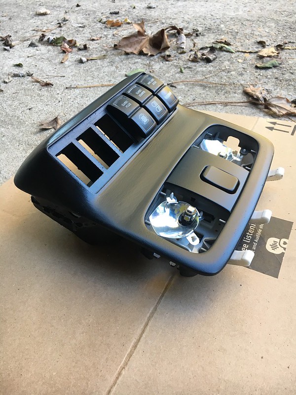

Got tired of looking up to see the two tone overhead so I ended doing some quick and easy plasti dip. Should be easy enough to pull off if I ever find a good paint to match the rest of the interior. For now, this is what it looks like.
Got tired up looking up to see the two tone overhead so I ended doing some quick and easy plasti dip. Should be easy enough to pull off if I ever find a good paint to match the rest of the interior. For now, this is what it looks like.
