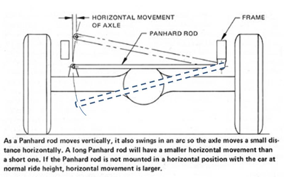

So, my question is what would potentially resolve this. The track bar seems like the obvious place to start, but it seems odd that I would need to shorten it. That seems like the only way to keep it centered with the driver wheel tucked. Normally, you lengthen it a bit after a lift to match normal ride height... In this case, the arc should already be starting to pull it towards the passenger side as shown in the attached picture. Thoughts?

yeah, typically you lengthen your panhard to re-centre after a lift. I have the MT LT set up too, plus the MT adjustable 4 link with an adjustable panhard. can't say I've noticed any rubbing as you describe. I'll crawl under tomorrow to see if there has been any contact

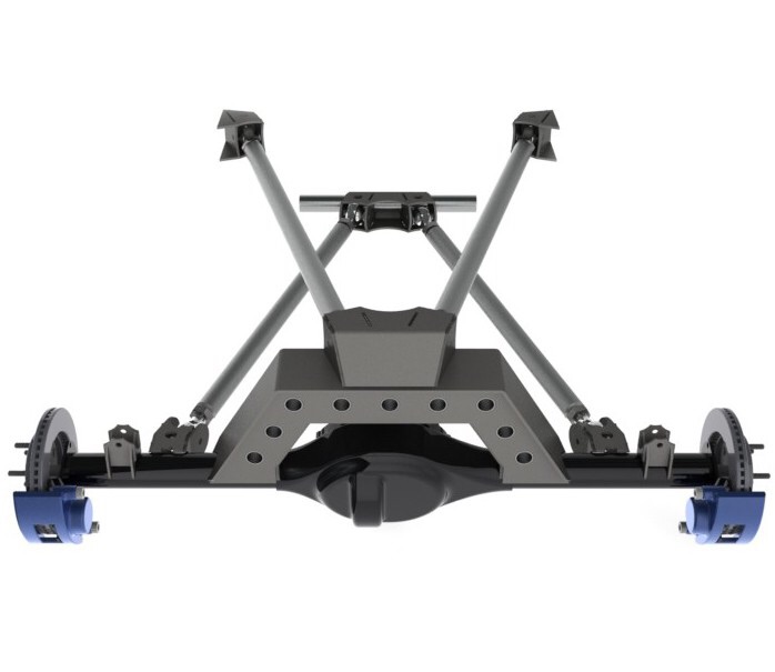

The only way to totally solve the issue of axle drift under droop, is to eliminate the track bar entirely by triangulating the upper control arms, which wouldn't be that difficult

I'm wondering if lowering the track bar mount on the frame would fix it. That should
a). Make it more centered at ride height
b). Pull it more towards the passenger side at full compression...
However, I'm not sure it will work.

Put fuel tank where spare tire is. Do a true 4 link with longer triangulated upper and lower links

Simple fix.
Would be nice, but I'm not looking to go that complex, I need about 10mm of clearance... just a minor adjustment somewhere.

Quite possible, but at less than 6k miles, not quite ready to ditch the KDSS. It works for what I have run, not looking to be a ramp queen, so at this point, I am happy with what I have. 8 can understand your frustration, tho. Like has been said, adjustable panhard or lower the top connection point to achieve stock geometry
