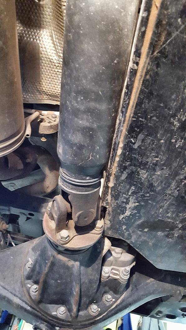

Guess I have this issue after all. Looks like I will be altering the fuel tank skid even more. I am still running the stock panhard bar.
Ha, this is an old post. Just to update it. I'm still on the stock panhard and mounts.. I just messed with the gas tank skid more to eliminate the rubbing. It still scrapes ever so slightly on rare occasions, but I can't really hear it. Just see the evidence of very sight scraping when fully tucked on the driver side.

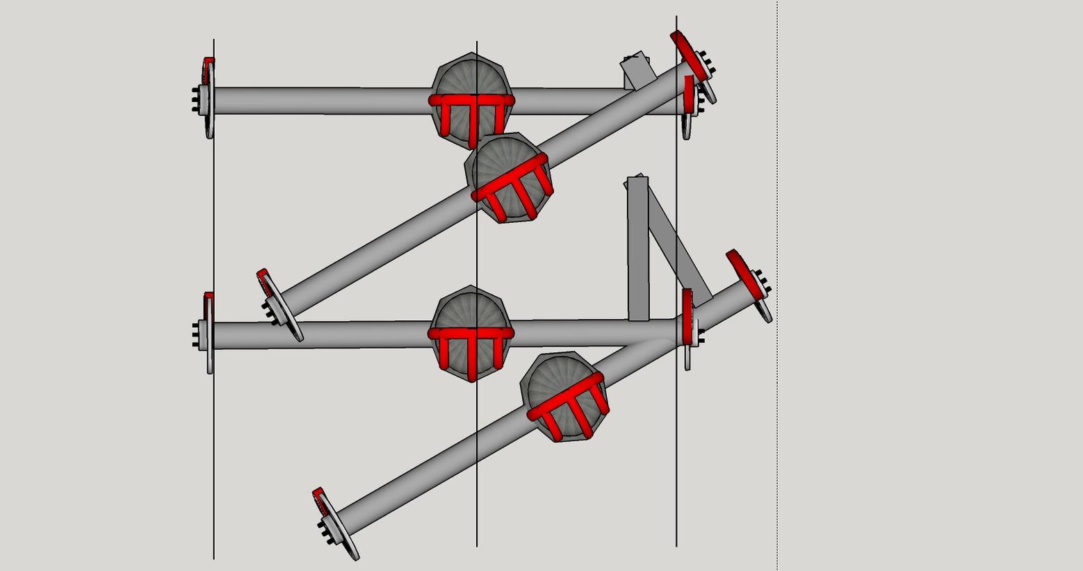

FWIW- adjusting the bracket on the frame side is a better choice than the axle side.
[MENTION=118321]Jetboy[/MENTION]
I always appreciate your insights and understanding, but I'm trying to figure out what your illustration is about. It's not what a vehicle with a suspension system does, where the axle shifts up and down and stays fairly square and parallel to the frame (except when tucking wheels and shifting axles as [MENTION=106176]wfo9[/MENTION] has done).
What you've illustrated is an axle that's fixed to the frame on one side, which we all know it is not. Add the panhard bar fixed to the frame on one side and fixed to the axle on the other side of the differential. Then show the rotation of the bar as the axle shifts up or down. Sure, the axle rotates too, but it's only fixed in location by the trailing arms and laterally, left to right, by the panhard bar.
What we're talking about here is the panhard bar anchors to the frame and axle. The panhard shifts angle but not the axle under normal driving. If the axle rotates a bit as the vehicle goes over uneven terrain then the panhard bar shifts up or down depending on which side is tucking up under the body/frame.
I agree with what you said. It's probably better to shift the anchor point down from the frame. In the Rokeman photos I see two bolts that could be used to attach longer, lower triangular-shaped side plates to the existing anchor bracket and only marginally welded at one point inward from the existing anchor point. The 3rd point of the triangle would be pointed towards the center of the axle where it could be welded for increased stiffness of the plates. I can see it in my mind. I often detail stuff like this for static building designs.

Correcting the geometry won't fix the tank skid intereference. (Tank relocation will)
Best you can do is adjust the axle offset to clear the tank - or clearance as needed...

His gas tank skid is not clearanced for the articulation. When Lil'Skip started making gas tank skids, he though he had it figured out. Then some of my customers bought them and all hell broke loose. I worked with him to re-design them so the shafts did not rub with the 1.2 kit. That was the end of that, not a very hard fix.
I have commented on this post previously with the issue. I have now eliminated the issue and am still running the Metal Tech LT rear set-up. I have clearanced the gas tank skid twice (documented in my buuid thread) and went to a Double Cardan rear drive shaft, which is smaller in diameter than the stock drive shaft and rotated the pinion up. I have no sway bars and still have stock panhard bar and mounting points. At full stuff on the drivers side, it is close, but no rub, so I'm content with my setup.

So, an adjustable bar is great for re-centering the axle at lifted ride height and therefore beneficial to alignment & thrust angle, but any angled panhard bar will increase side-to-side shift during suspension travel, regardless of its length.
Here's an annoying video that illustrates this pretty well:
YouTube
(not sure how to embed video)
This is why a lot of folks comment that driving their 4Runner after leveling the panhard bar feels like running sway bars - the rear end wiggle has been significantly reduced.
As far as gas tank interference goes, re-centering the axle by lengthening an angled bar actually brings the driveshaft closer to the tank as the suspension compresses than it normally would be on a stock vehicle with a level/close to level panhard bar.
Imagine the illustration in the video reversed, so that the frame side of the panhard was on the right side of the screen like in our trucks - the angled bar causes the axle to travel to the left as the suspension compresses.
