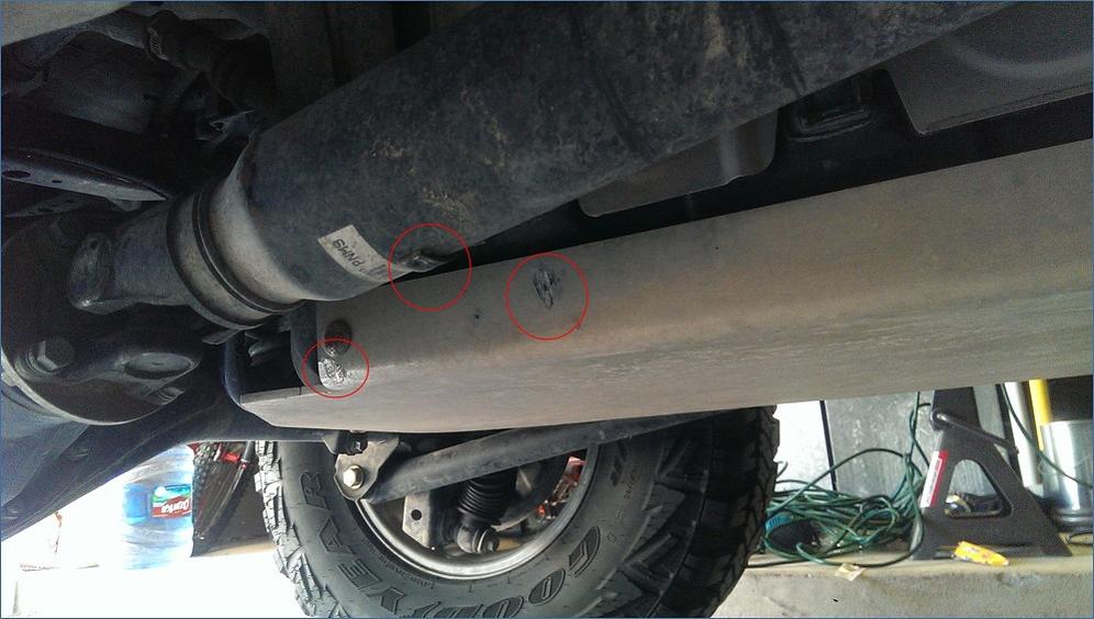

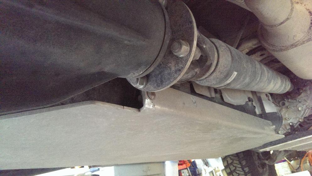

A few pics of the contact area.
After taking some measurements... I think lowering the frame mount on the drivers side is the way to go. This should provide just enough change in the arc for it to pull back towards the passenger side a tiny bit at full stuff. Raising the axle mount would be similar (if that ends up being easier). Both mounts look pretty beefy on the 4r.

Ok, I've brought this up before, .... The axle is shifting over about 2".
It rubs in two places. One is at the forward portion of the U-Joint half yoke and the other is further forward on a weight or some other metal bump on on the smooth portion of the drive shaft (this is the area where it is very close the gas tank itself)
I have trimmed the skid as much as possible plus relocated the rear bracket, and don't think there is really much more I can do for clearance besides coming up with a way to keep the axle more centered.
This only happens with the rear sway off...
So, my question is what would potentially resolve this. The track bar seems like the obvious place to start, but it seems odd that I would need to shorten it. That seems like the only way to keep it centered with the driver wheel tucked. Normally, you lengthen it a bit after a lift to match normal ride height... In this case, the arc should already be starting to pull it towards the passenger side as shown in the attached picture. Thoughts?
