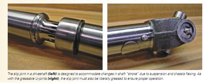

basically a slip yoke is a part of the drive shaft which allows the shaft to compress and extend. this allows for different lengths as the suspension moves through it's range of travel. Many Tacomas (including mine) would experience a shutter when accelerating after lifting it. switching to a 1 piece shaft seemed to help most. here is a little info from Tom Woods, who many purchase custome 1 piece drive shafts from.

So are you guys basically pumping up the slip yoke with grease till a little squeezes out or till you cannot pump any more into it? I put some grease in mine 2 weeks ago, about 5 pumps but don't think it did anything. I probably need a whole lot more in there.
^ You did luck out! it was like a gift and a curse; nice new lift, looking badass, then your whole cab shook during acceleration.
I never greased this DS, but the Tom Woods on my Tacoma, and my TC's, I pump in new grease until the same, new clean grease is coming out. That way you know you've got all the old, nasty grease out.
You'll need a whole lot more than 5 pumps.
On the slip yoke, I keep pumping until I see the driveshaft start to expand. On the spiders, I keep pumping until some grease starts to squeeze out.
