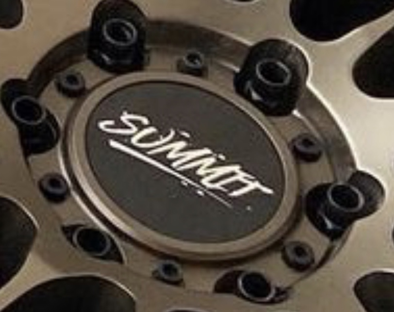

I’m waiting on my wheels as well but if it helps, they only carry one type of lug type on their website. I’m assuming that’s the type you’re expecting?
Here is a close shot of someone’s wheels:

Thanks. It does look like they only sell one lug, but it is because it has their name on those. Sometimes ET style lugs can fit so I am hoping that they do since they would grab much more threads that way.
The extra set of car wheels I have for snow tires which are cheap knockoffs from discounttire fit ET lugs so I am hoping these fit too.

Tbh, I didn’t think ET was a factor unless the vehicle’s bolts were extended. I always thought it came down to the correct thread pitch then rim seating and diameter for the wheel lock. With that said, looking forward to see others chime in.

ET(extended thread) refers to the threads going through the wheel lug hole, not the length of the lug. I think you are referring to extended lug nuts which are usually long open ended lug nuts used in racing applications.
