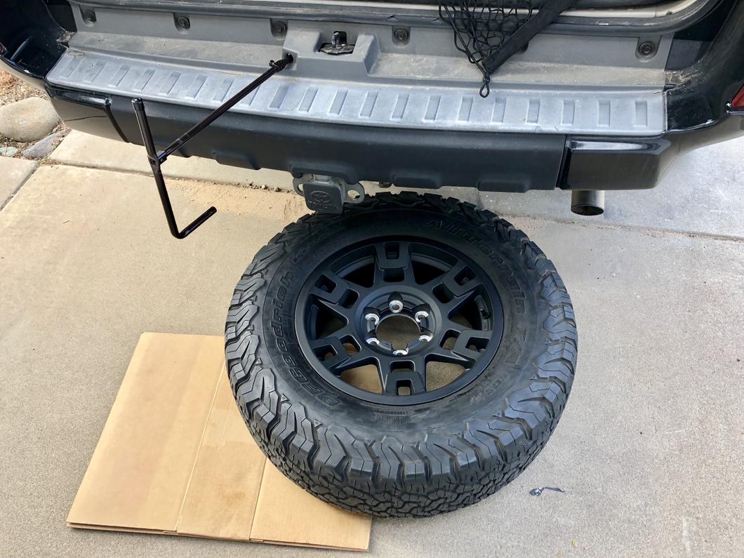

Sport Rack On
Just need to install End Caps. Any Tricks to install them?

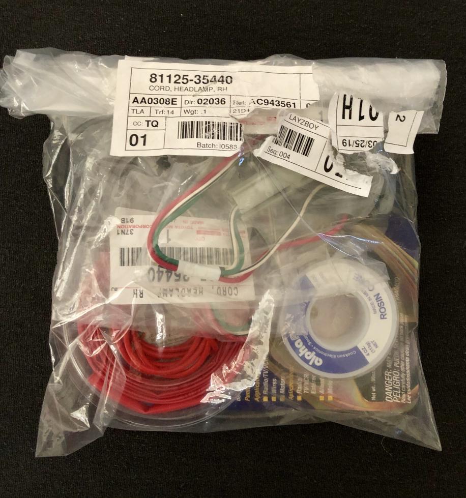

I have all the parts I Need Time to put it all together

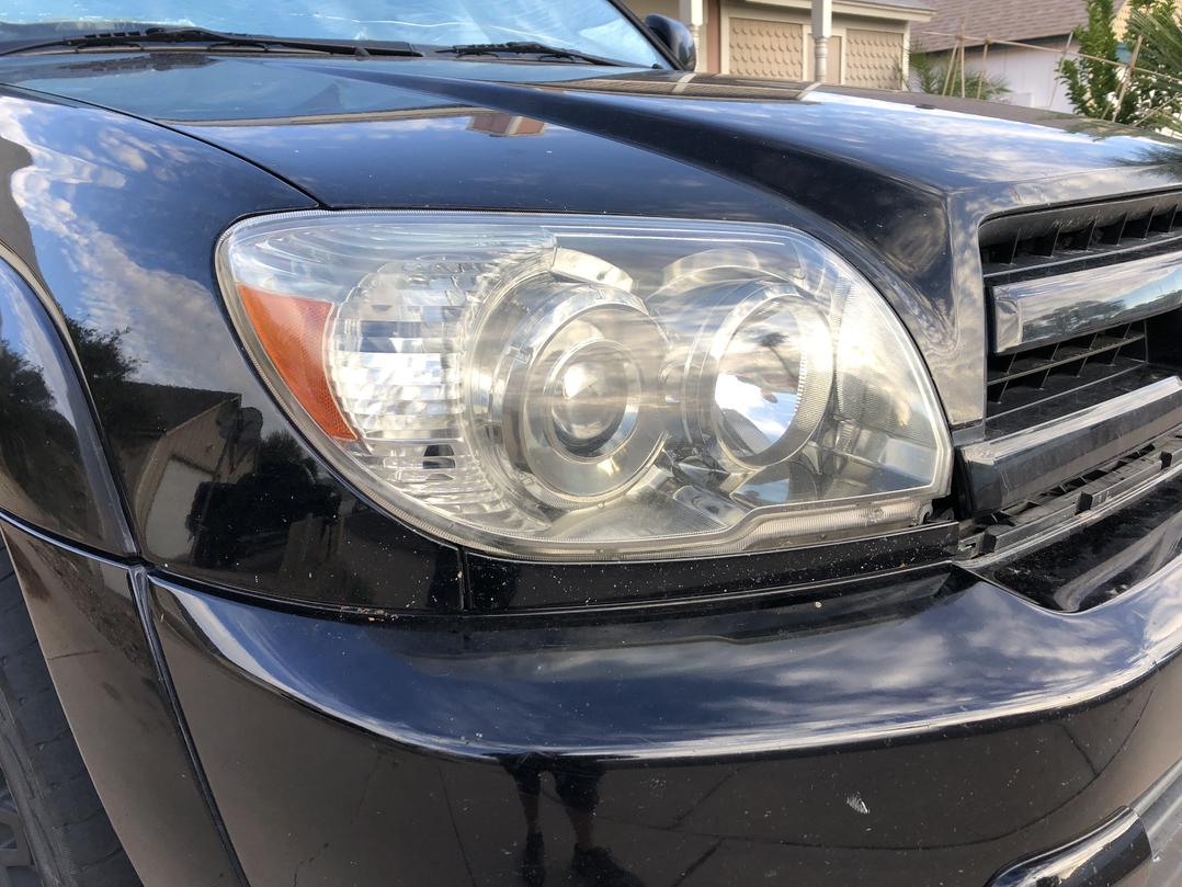

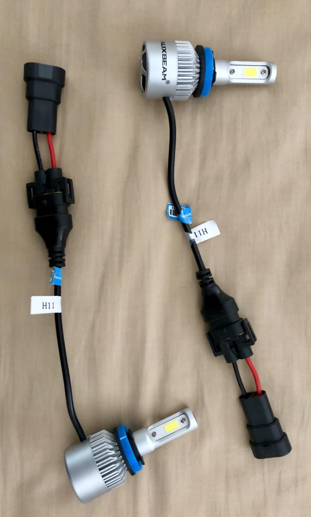

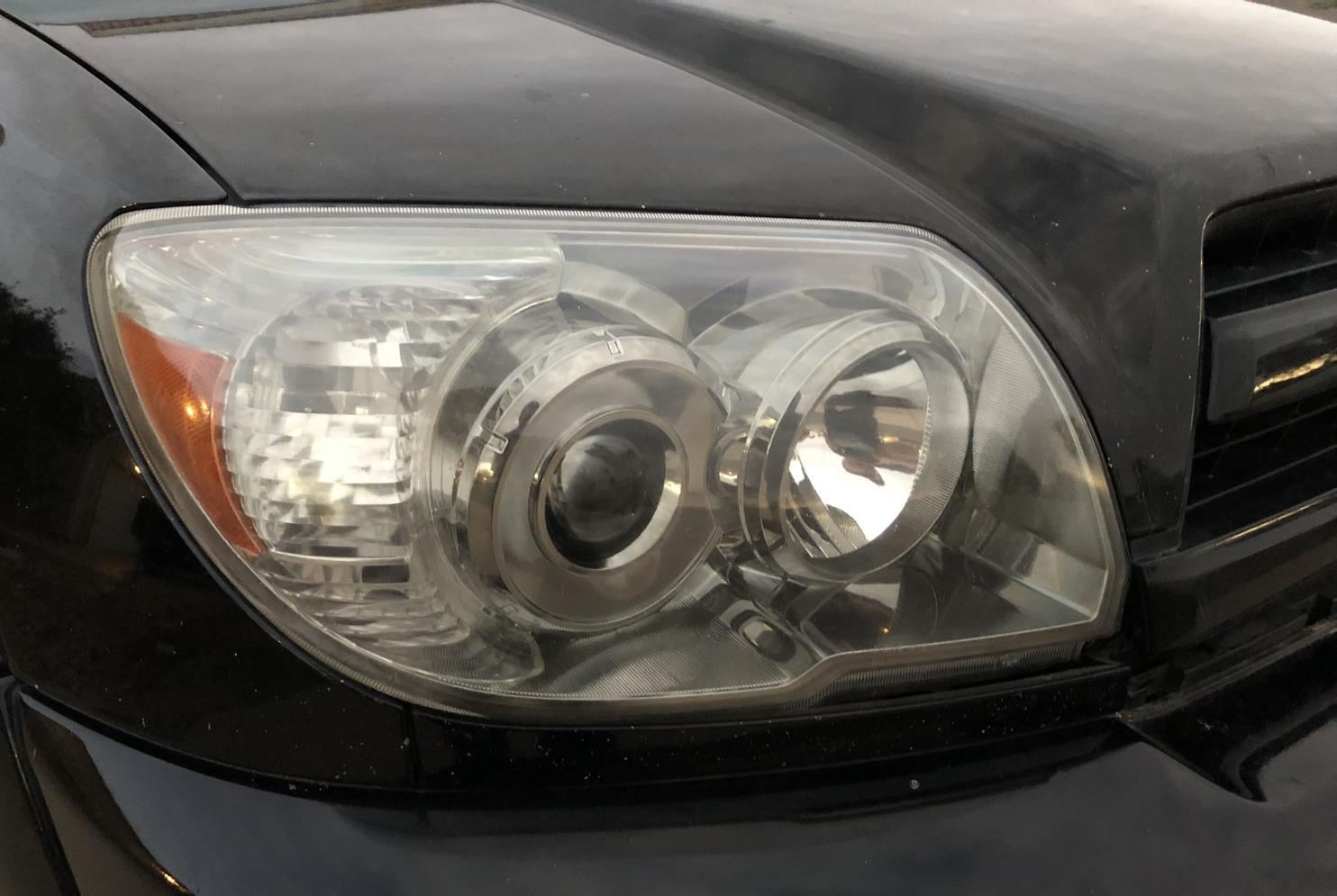

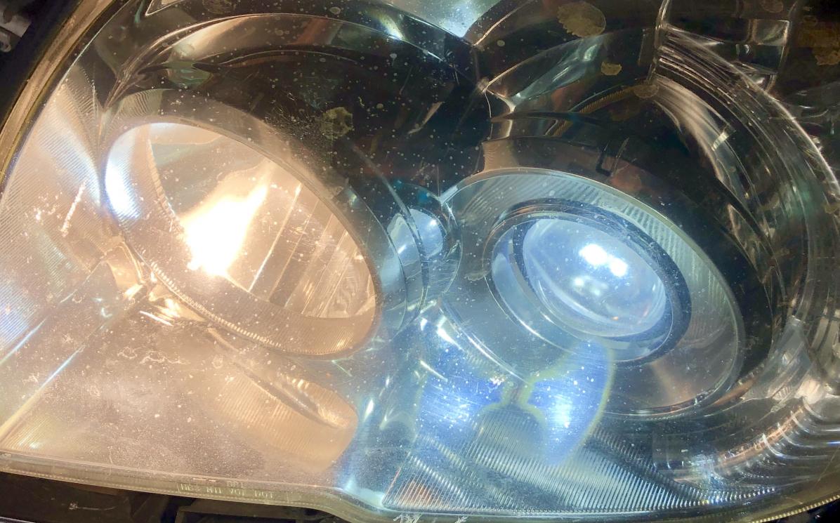

Testing LED Headlights with Factory Fogs

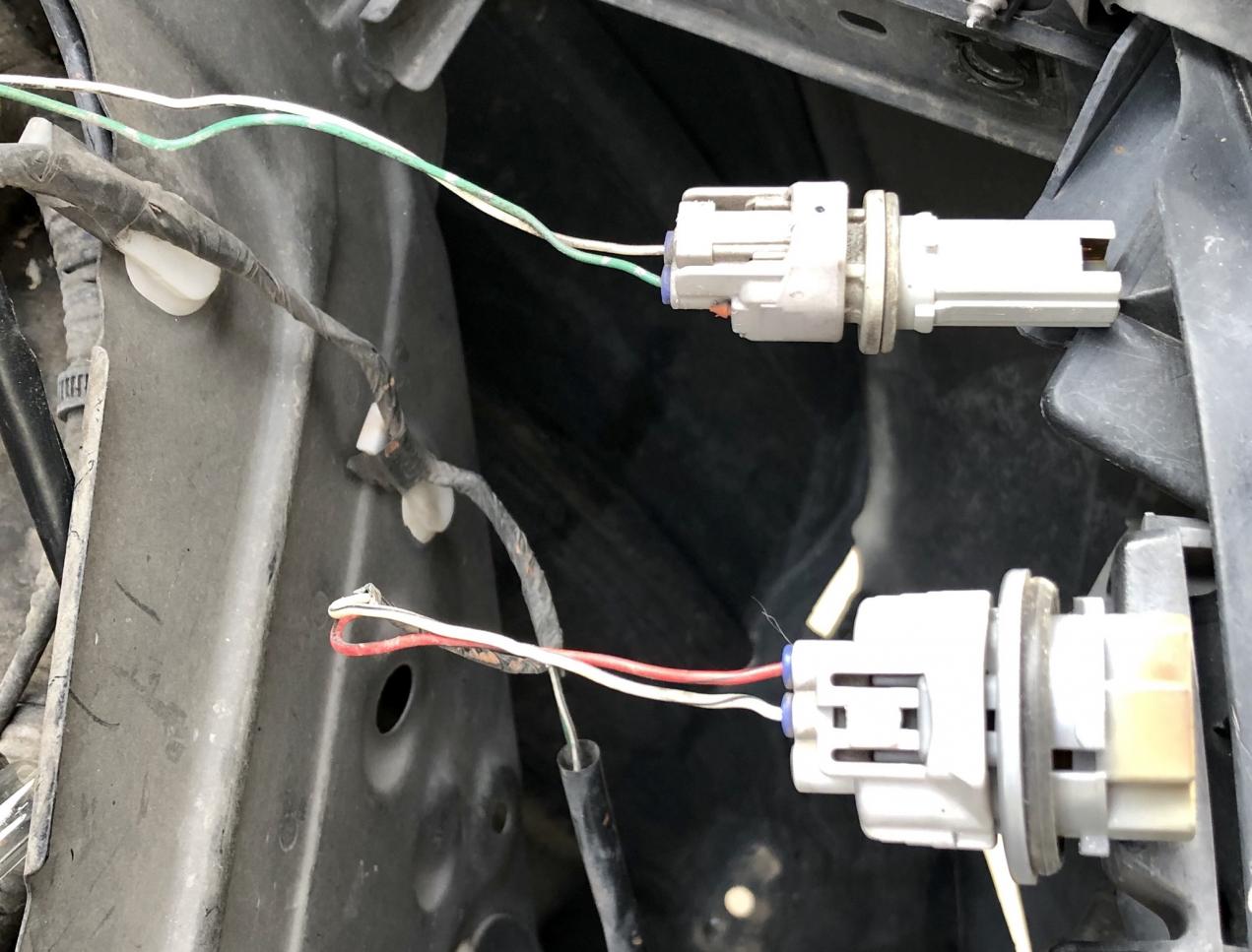

Only 2 we need to Cut and Solder. Parking and Turn/DRL. High Beam and Parking light Bulbs Are direct Swap. Headlights are H11.

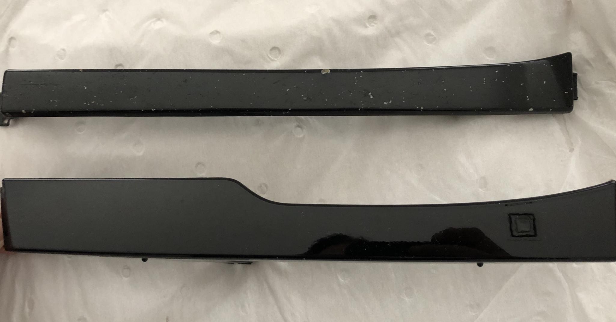

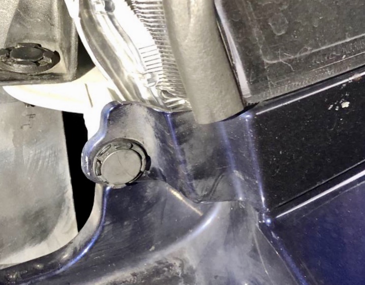

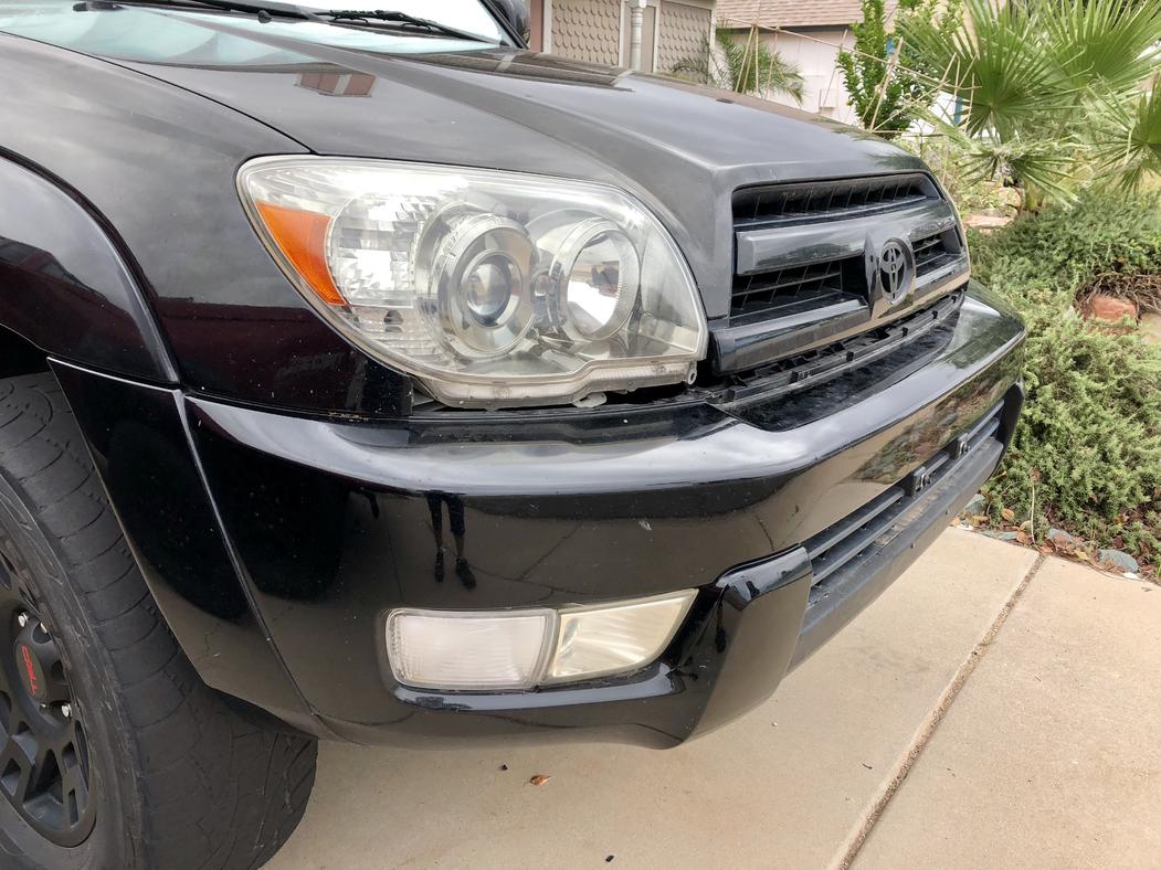

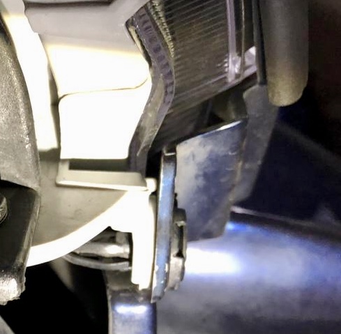

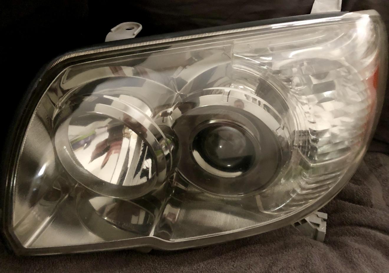

Filler Panel under Headlight Does NOT attach to the Headlight with a Screw like in 03-05 Headlights. Its a Different Fastener.
Thanks [MENTION=112299]Formidable[/MENTION] for the Fastener Pics for the Filler Panels

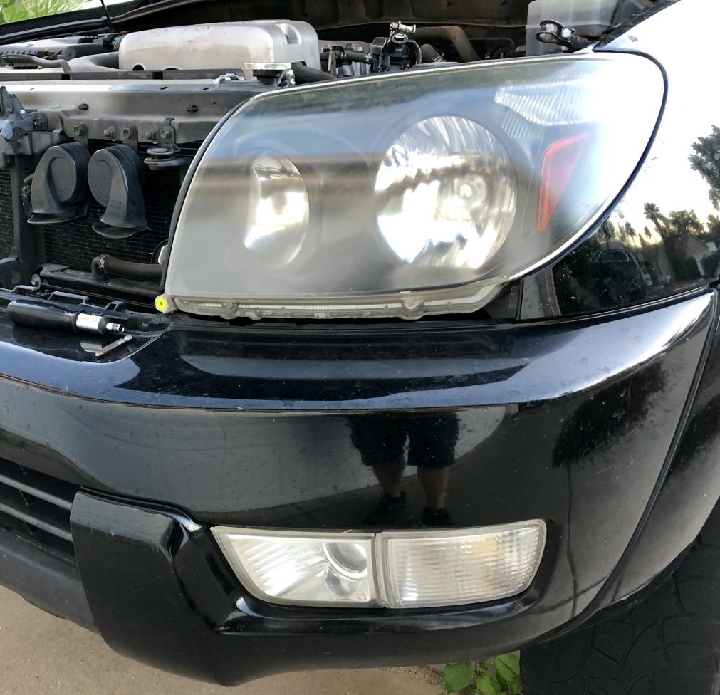

Installed? You are really going to like the Auxbeam LED’s in the 06-09 projectors.
Not Yet installed. I have all I Need ready to go. I may start Soldering tonight as its 99 Today and will be 100 Tomorrow. So early morning or late evening is the Best time. Yes from the testing of just 1 headlight I Can't wait to see how they perform on the Road.

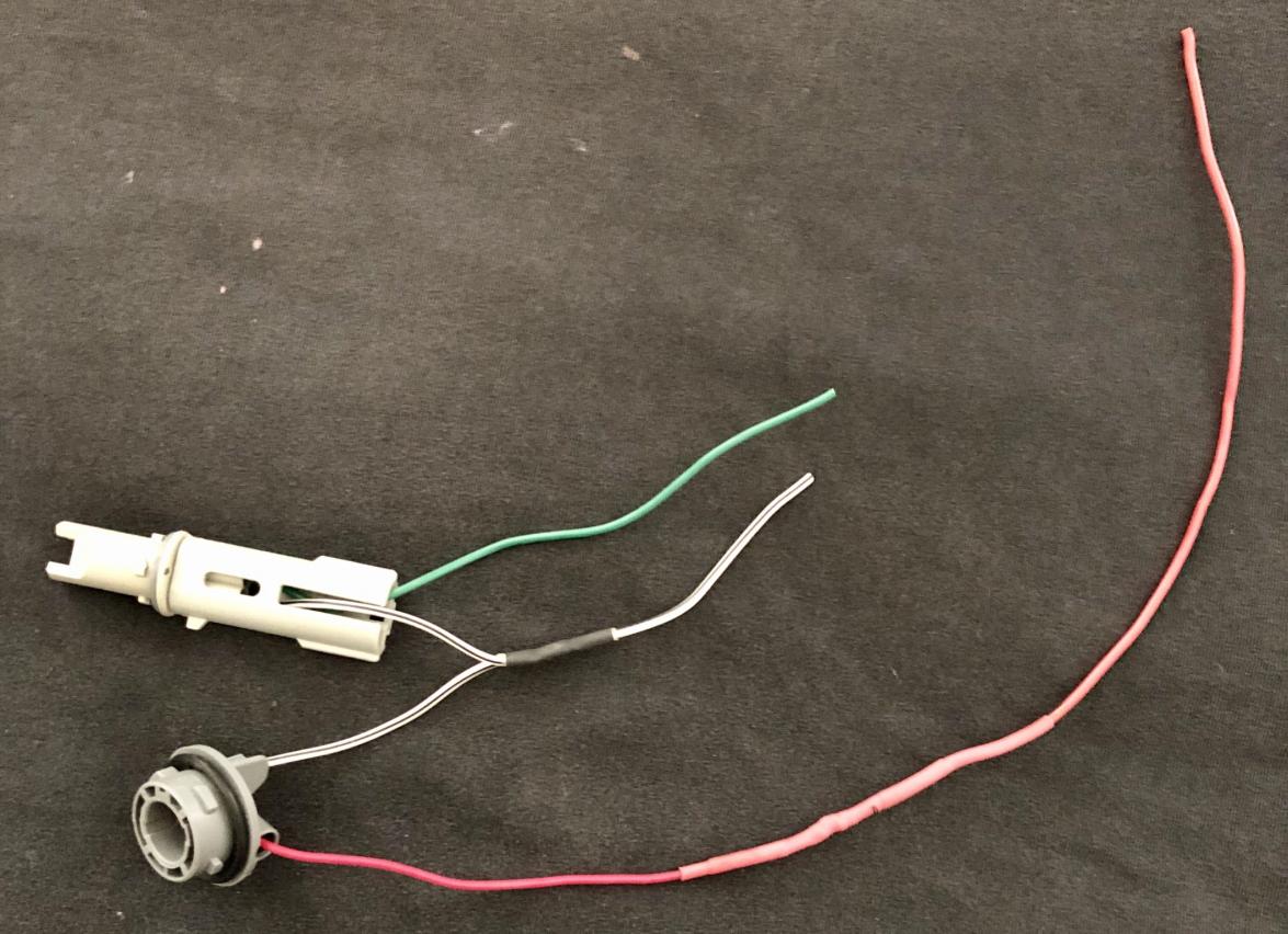

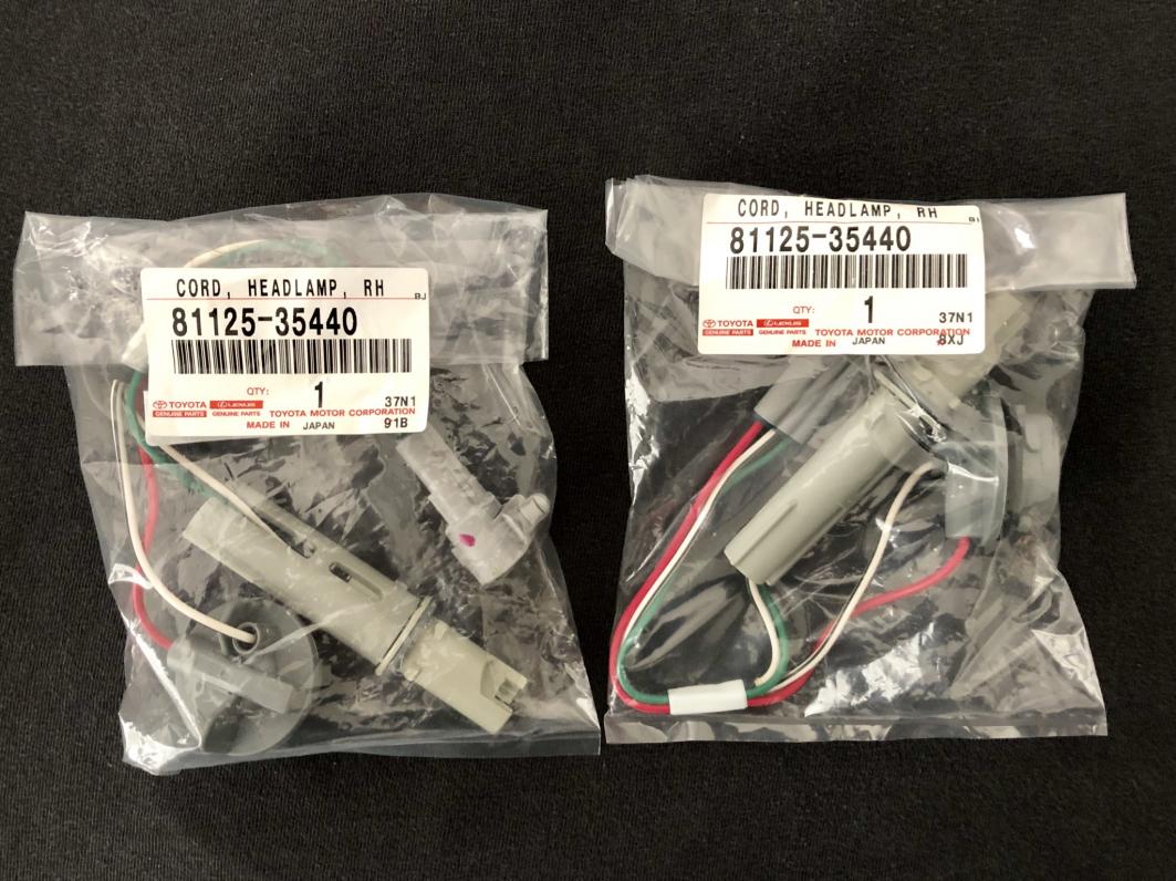

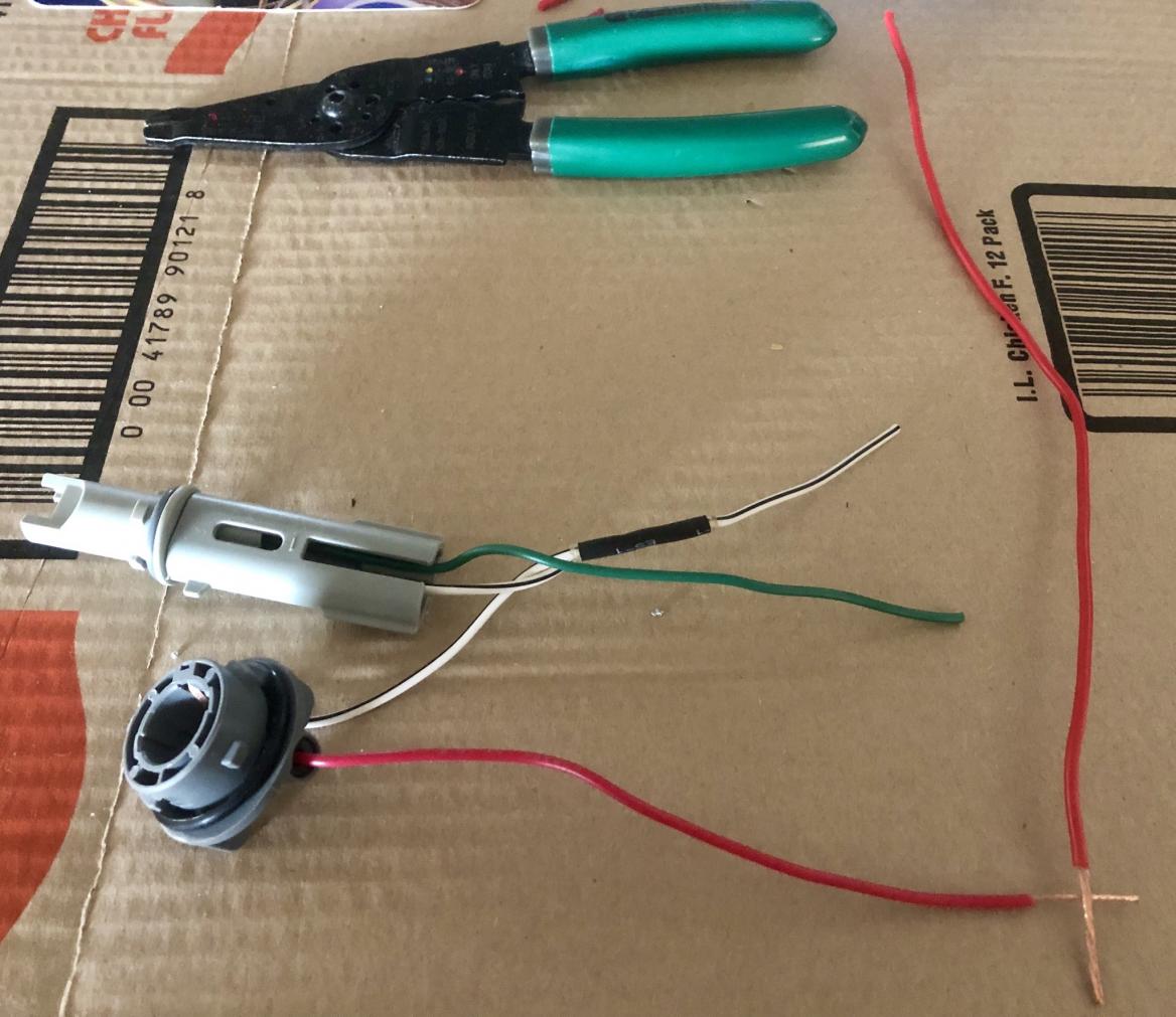

This is the Toyota Harness with the Plug cut off and extra Red wire Soldered on and Heat Shrink is on. The Turn/DRL Red wire from the Bumper is in need of some Extra Wire to transfer to be in the Headlight. The Parking Light is good as is.
