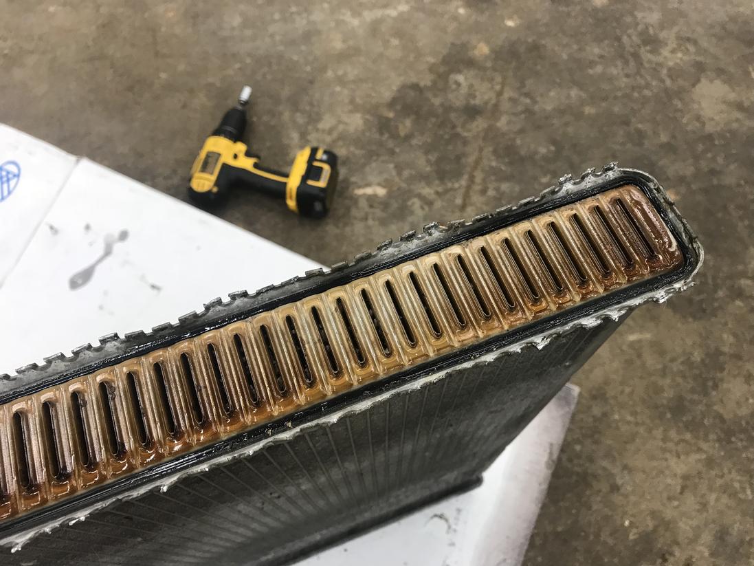

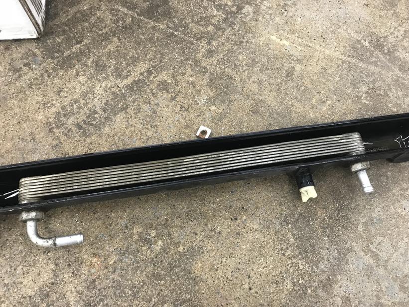

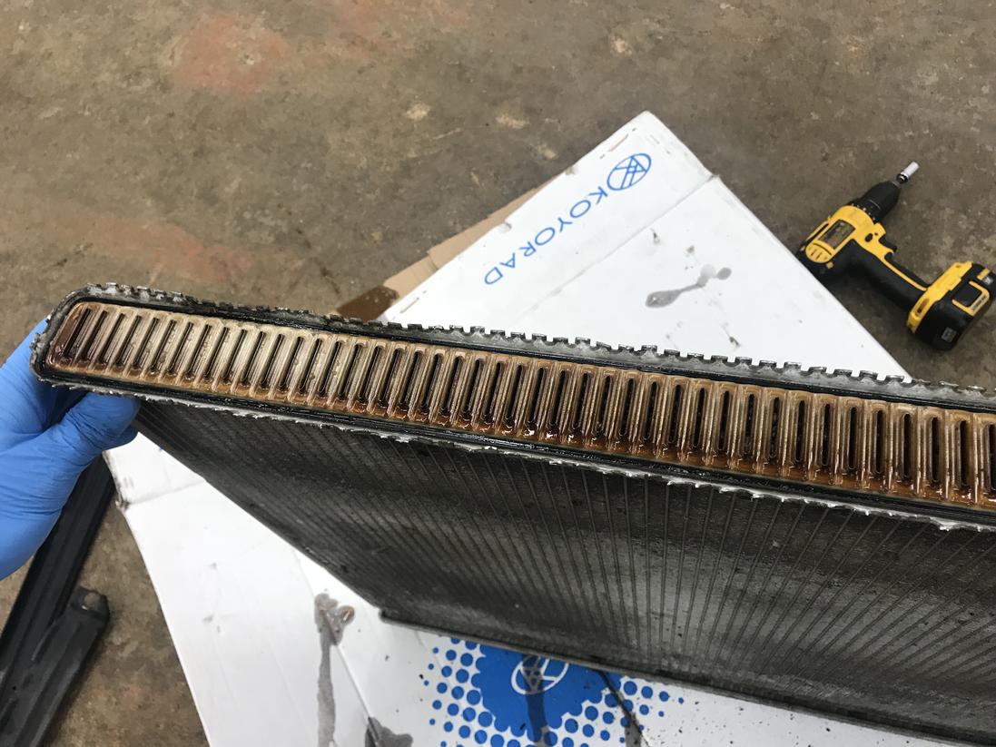

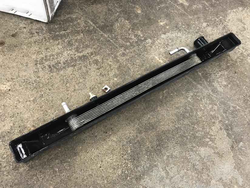

Thought I’d post here as it’s an active, related thread... did my full cooling system, timing belt etc last week and took apart the radiator to see how it looks.
At 255,000 miles I don’t see any corrosion etc, but I’m still happy I replaced the radiator and will do so again in 80-100,000 miles. It’s $150 and an easy job every 5-8 years.
I’ll be doing the aux cooler, in series, within a few days hopefully.
Photos attached.

What's the history on that radiator? Just curious if the radiator saw regular maintenance fluid changes. If no history, what was the coolant condition when you swapped radiators?
Wish I could tell you... my friend at a Lexus dealer did the work and coolant seemed fine, but definitely not new. Radiator seemed original he said. 250k of those miles were in Arizona so that’s another reason for it to be so clean.
