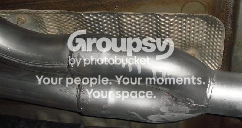

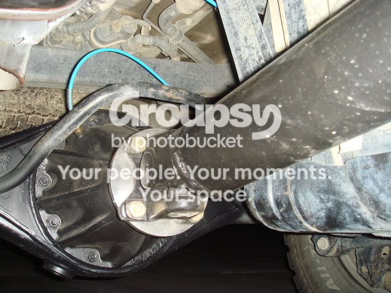

So here is the breakdown. I have a rebuilt drive shaft that is made from DOM and basically looks like it came off a light armor vehicle! Chopped the exhaust off right behind the back cats and corrected the y pipe abit and raised the whole run to give a bit more of clearance with a new magnaflow with a shorty dump (that I am gonna change to dump behind the axle later, doh!). Running Yukon 4.11 gears with a ARB air locker. Had to use a FJ rear pinoin flange to adapt the splines from the new gears, worked fine.

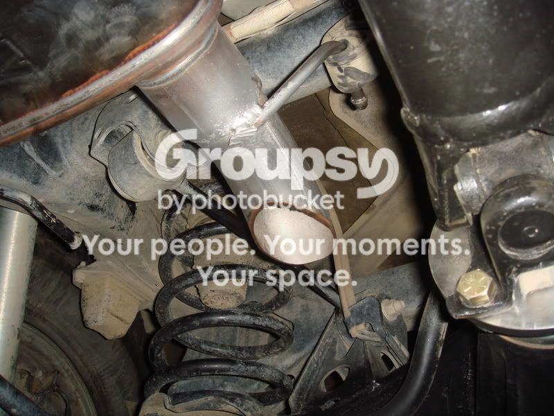

3rd showing airline and new flange

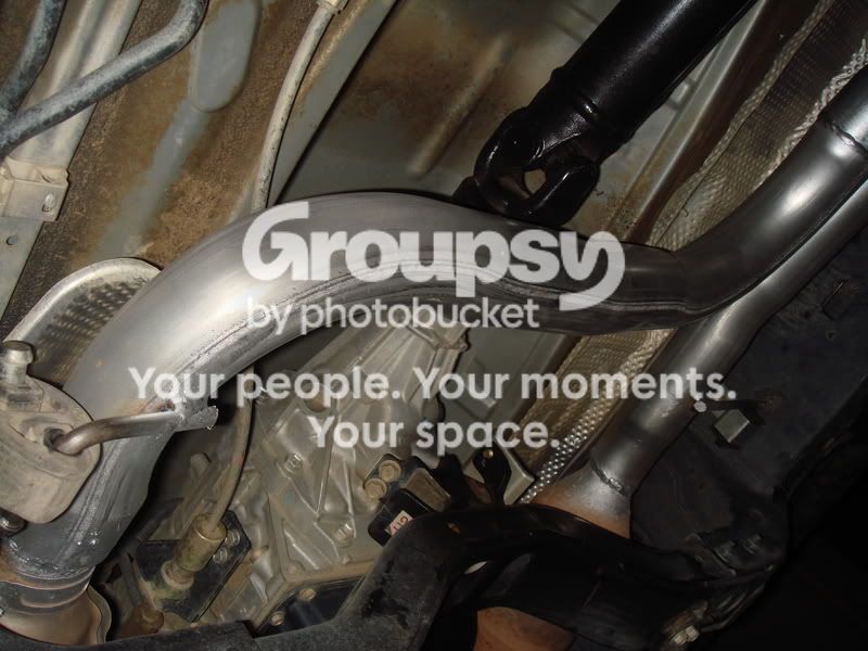

Exhaust

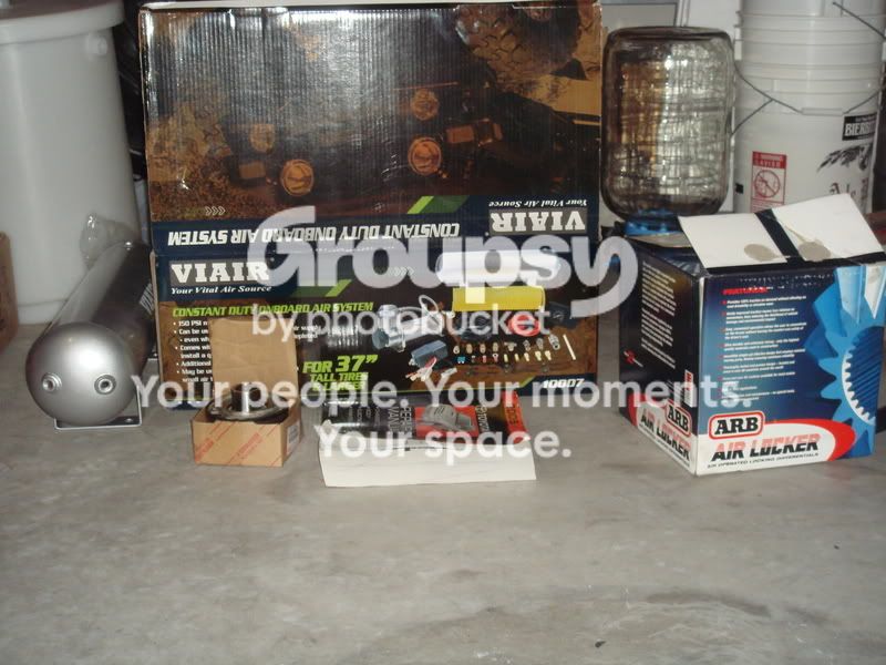

On board air setup
